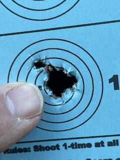

Back to tweaking, not twerking, too old for that nonsense. The stars aligned, the moon was in the proper phase...didn't touch the front reg, kept tweaking the #2, got it up to 130psi and things steadied down, but way too fast, so....bounced back and forth between the reg and the HSA, somewhere the aforementioned alignment happened. 100 psi, PW 5, HSA 19.52mm 927 average with a spread of 9, SD of 3.4, over 3 14 round mags, Total rounds starting at 270 bar...90+, stopped at 120 bar, deformed pellets didn't matter that much dime size groups at 30 yards. PW did its thing properly. For giggles I tried some FX 22GR slugs, not bad but nothing to write home about. 28 shots, 30 yards, top left is me twitching. Now, officially I'm not messing with this gun. If I want to shoot slugs I'll build up a gun strictly for it.
