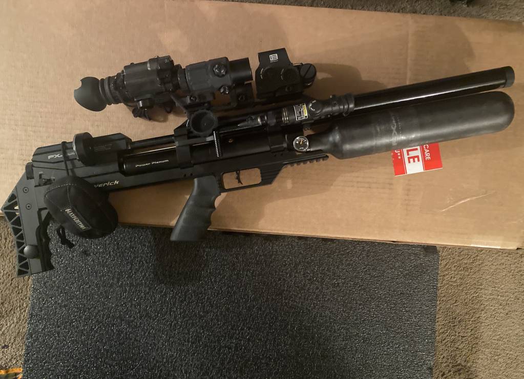

Great write-up on the Maverick. It looks like a nice platform to work with.
Have you thought about making a barrel support system in the front to control barrel movement, harmonics, or droop? My Impact barrel moves significantly at the front block where the o-ring resides when it's in the case or even sitting with the barrel against the wall. I was thinking of making a plate with a beveled hole that sandwiches an o-ring or a beveled soft plastic ring tightly to the barrel and block, tensioning it evenly and solidly. There's plenty of room to drill and tap the front block to mount it there and it wouldn't even be seen. The same looks like it would work on the Maverick.
As far as the single grub screw holding the breech end of the barrel goes, I drilled and tapped a second hole across from the original to give pressure on both sides of the barrel and locking it down that way.

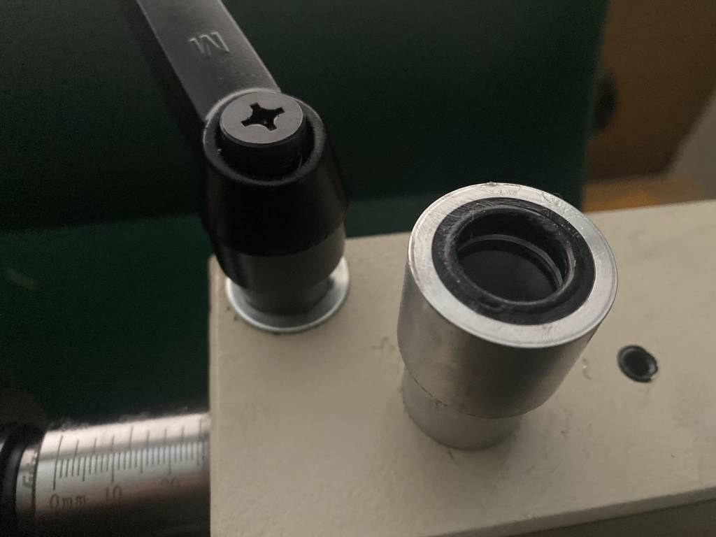

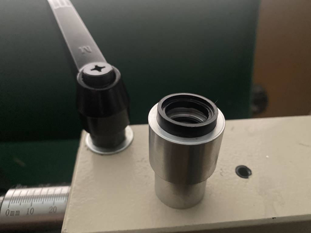

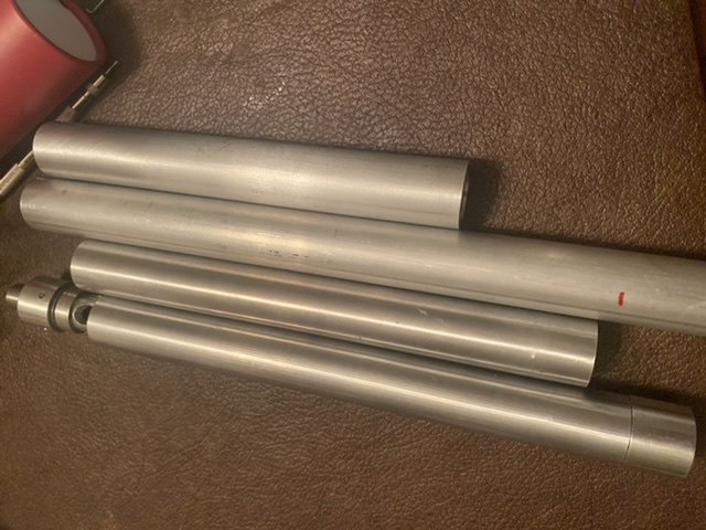

I already made a tensioned barrel shroud system with a two different endcaps (one with a 14mm ID and the other 15mm for my Taipans). I said this twice though lol, I don't need it with my 502mm TJ, I've already tested with and without it, and there's no differences in accuracy.

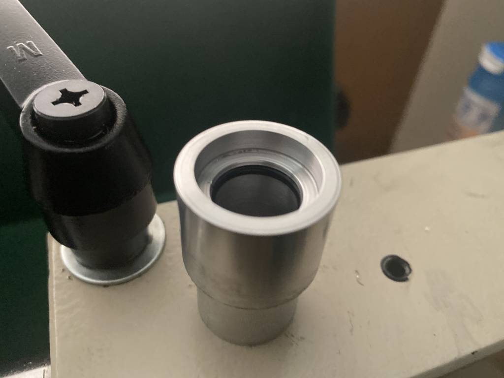

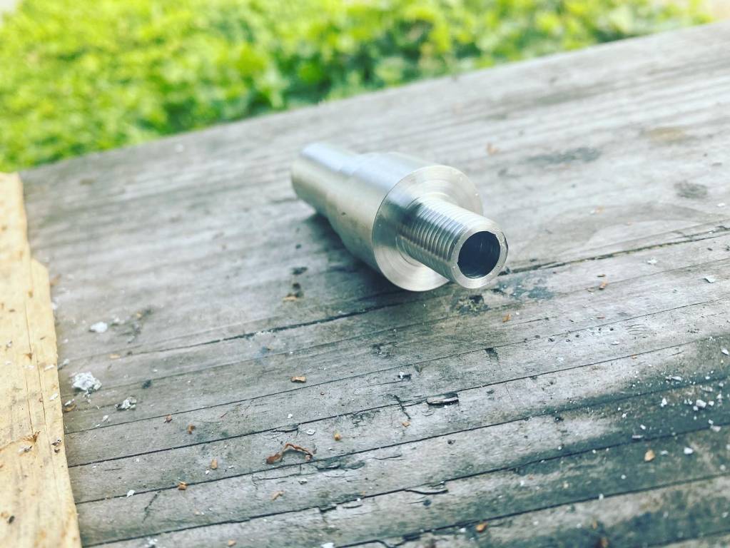

The endcaps are over engineered. T6 7075AL with a little PEEK insert that seats a rear o-ring. There's another internal o-ring groove forward inside the bore, and an outer o-ring that slips into the "dial a size" 6061AL tubing, but it's a press fit and not really necessary.
The other muzzle cap before the milling of the air stripper holes..
I would want to use this if my barrel was more than ~550mm, but there is no point at this length. Barrel is machined perfectly snug for this rifle, there's no play / harmonic problems / bullpoop with my barrels.

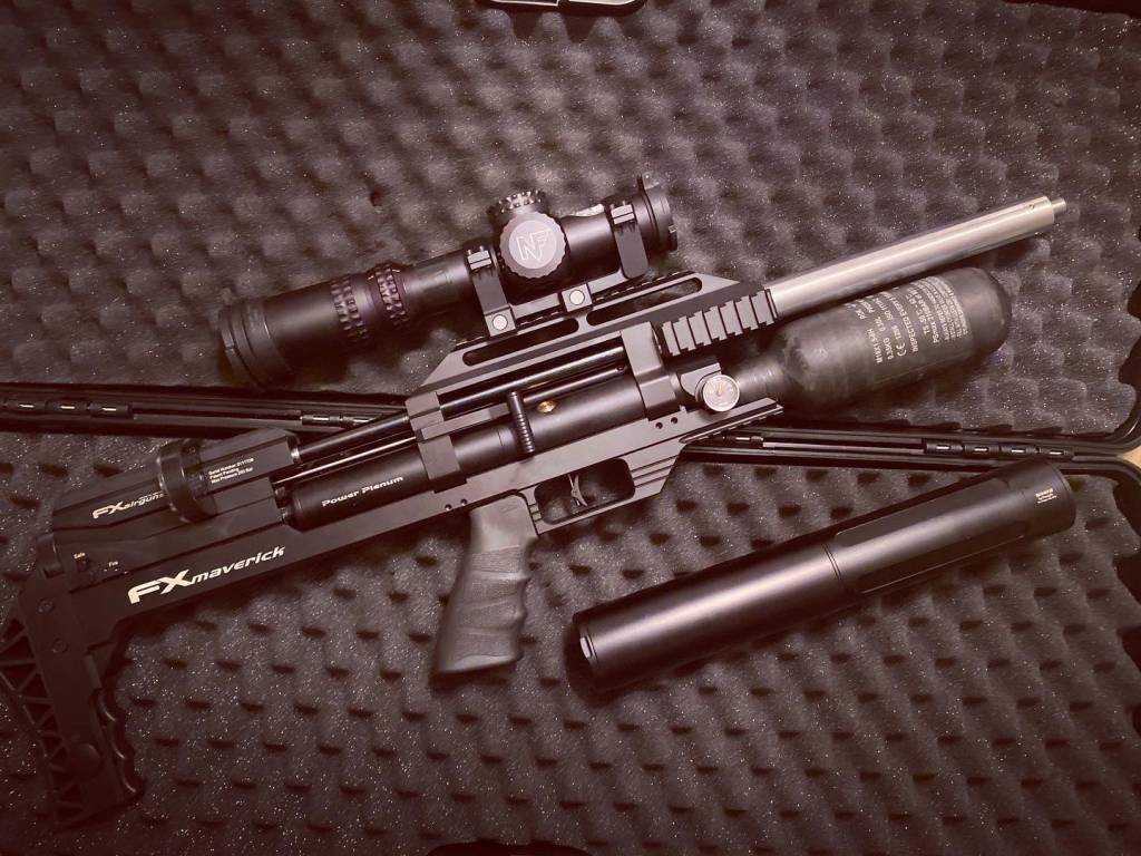

Here is another configuration that I kind of like with a 580cc CF bottle and custom Taipan Vet (std) LDC. I'd definitely want to make a bottle protector similar to the one that I made for the 300cc & 480cc, it's way too exposed.

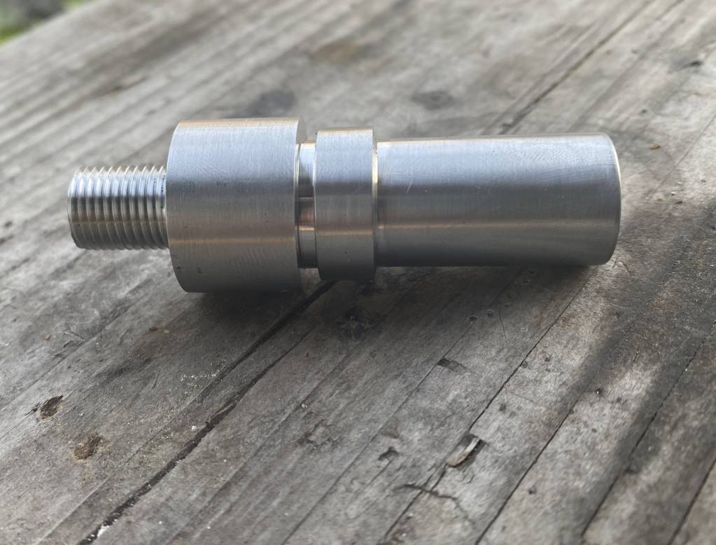

I widened the baffles to just over bore diameter, and modified the rear cap of to fit nice and snug around 14mm OD barrels. I tested this with the 500mm FX kit and wound up making an 80mm Delrin spacer with o-rings on both ends for the LDC to compress against. This keeps the muzzle in just the right place for the exhaust gasses, and keeps the larger OD of the LDC from threading against the two side rails:
The report is definitely backyard friendly setup like this.

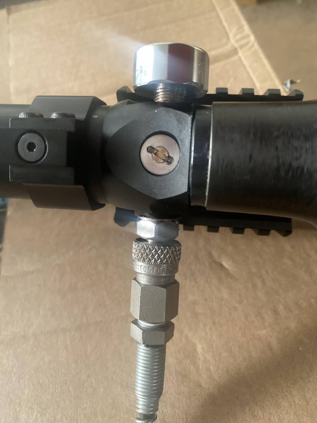

GRRRR my Maverick already spung a leak somewhere around the front reg. Pretty sure it's dumping through the atmosphere hole, but I'm sure that I have all of the o-rings to fix it.
I was planning to hit the road early to test out a higher power setup with my longer barrel and a new 15.5 gram hammer weight that I made today. Might not be able to test it until the weekend though, the universe is working against me at every damned turn today!!!

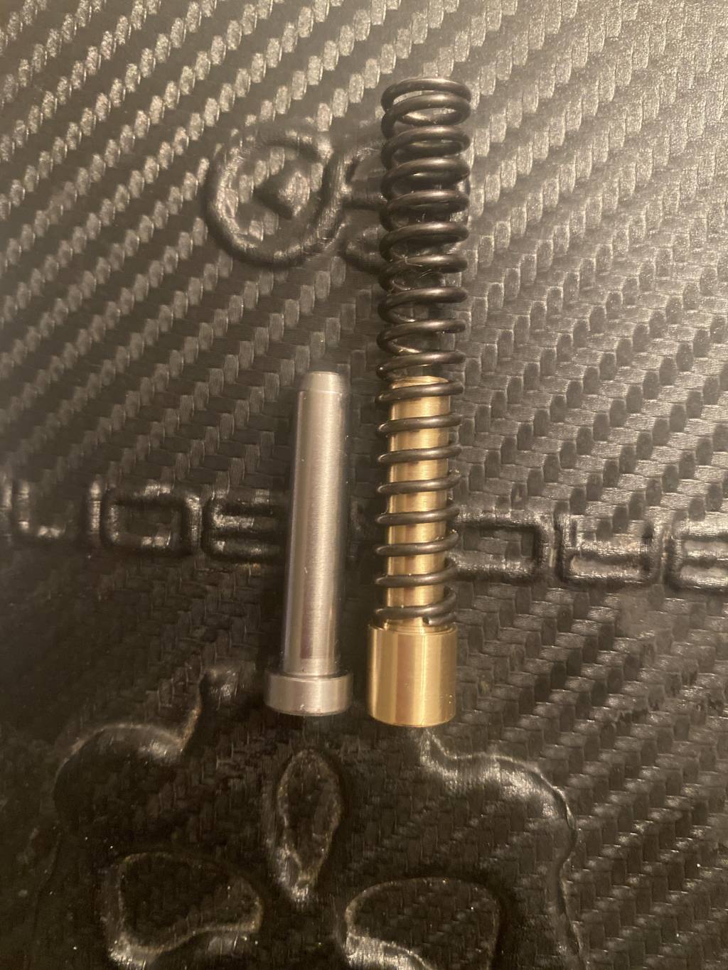

Incredibly poopty day! I fixed the leak, but it took me multiple hours to finally resolve. It was dumping from two places - the atmospheric port and the top of the reg. The 7x2mm top o-ring was compromised, but I wound up screwing up the polymer reg piston while throwing o-rings at the other leak over and over.
So I swapped in a Huma high-power regulator in place of the factory regulator, they're built pretty stout and I had considered doing this early on anyway.
Then, I encountered another leak from the top of the reg. It turns out, the Huma shipped with a 7x1.5mm outer o-ring, which is too small. I swapped in a 7x2mm, crossed my fingers and reinstalled the bottle - and then encountered and entirely new leak coming from the fixed fill port!!! That one was a head scratcher.. I put a 14mm wrench on it, but it was bottomed out already. I loosened it and snugged it back down, and it stopped leaking when I attempted to fill again.

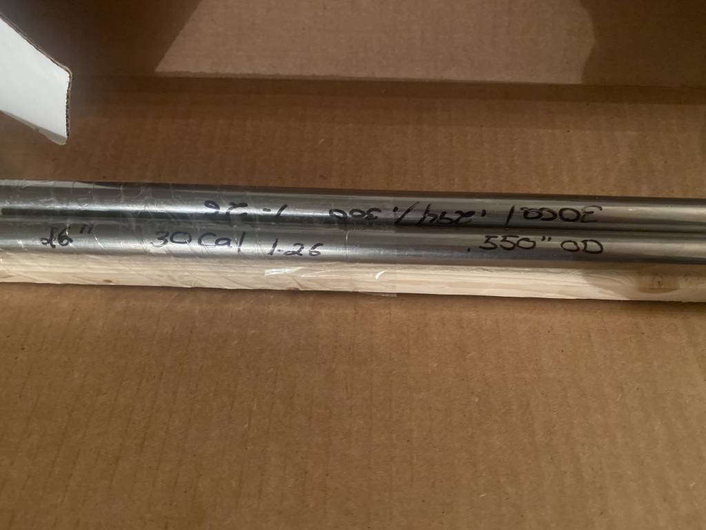

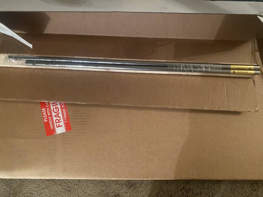

Two more bbls to play around with. One is 26" and the other is just shy of 28"
