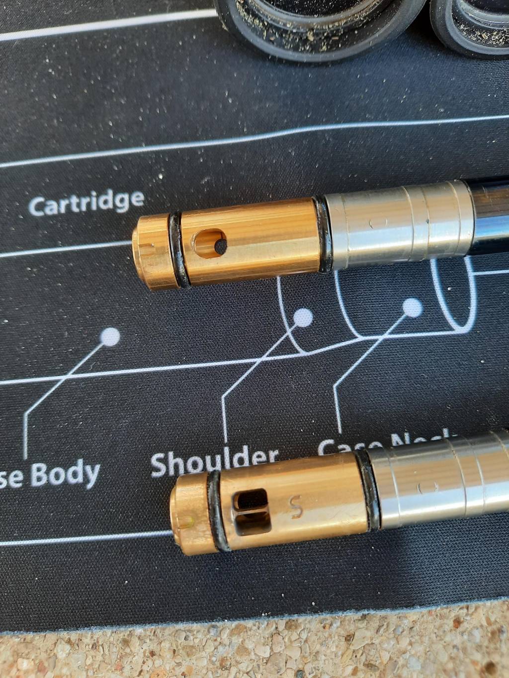

My .22 Maverick compact was tuned to shoot JSB18.13gr pellets at about 880fps on PW7. Now when I put the Sniper barrel on in the Slug side, my power goes way down hitting the ground in front of even a 30 yard target. Im trying to shoot a 20gr javelin Slug. I noticed the porting on the Sniper barrel is way smaller than the compact barrel-attached photos. So what might be happening? My regs are 135/110.

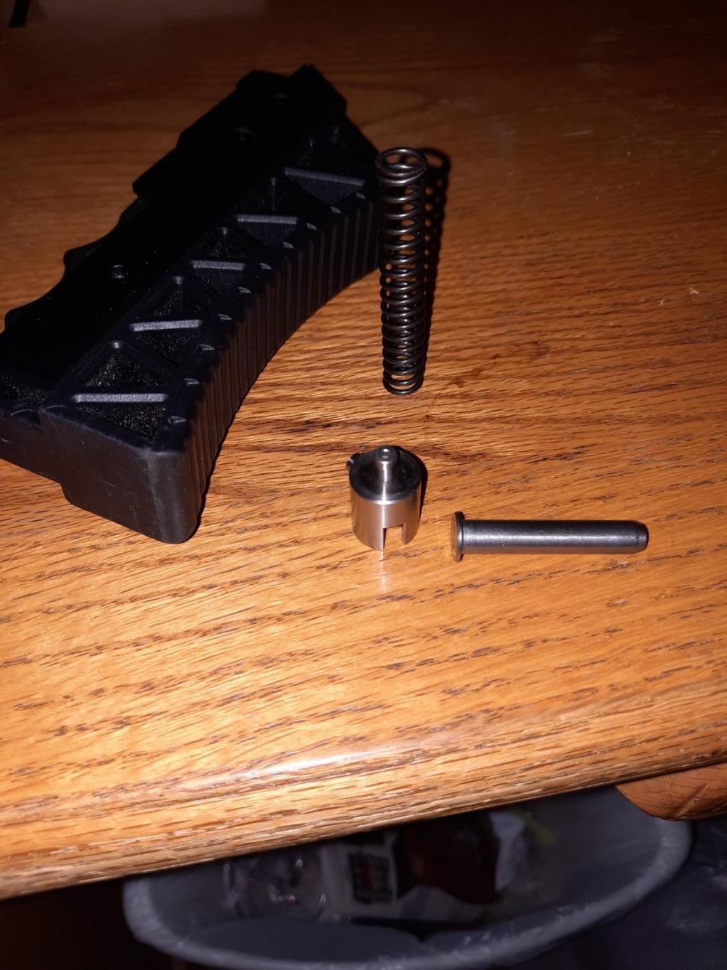

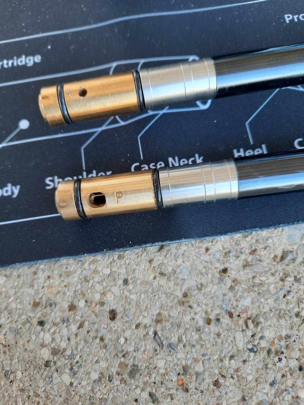

Top barrel is the sniper. Tried turning PW Down thinking I had too much hammer with sniper barrel but had even less power. Hammer weight is 7gr oem as is the rest of the gun. Gun originally sold in compact version.
