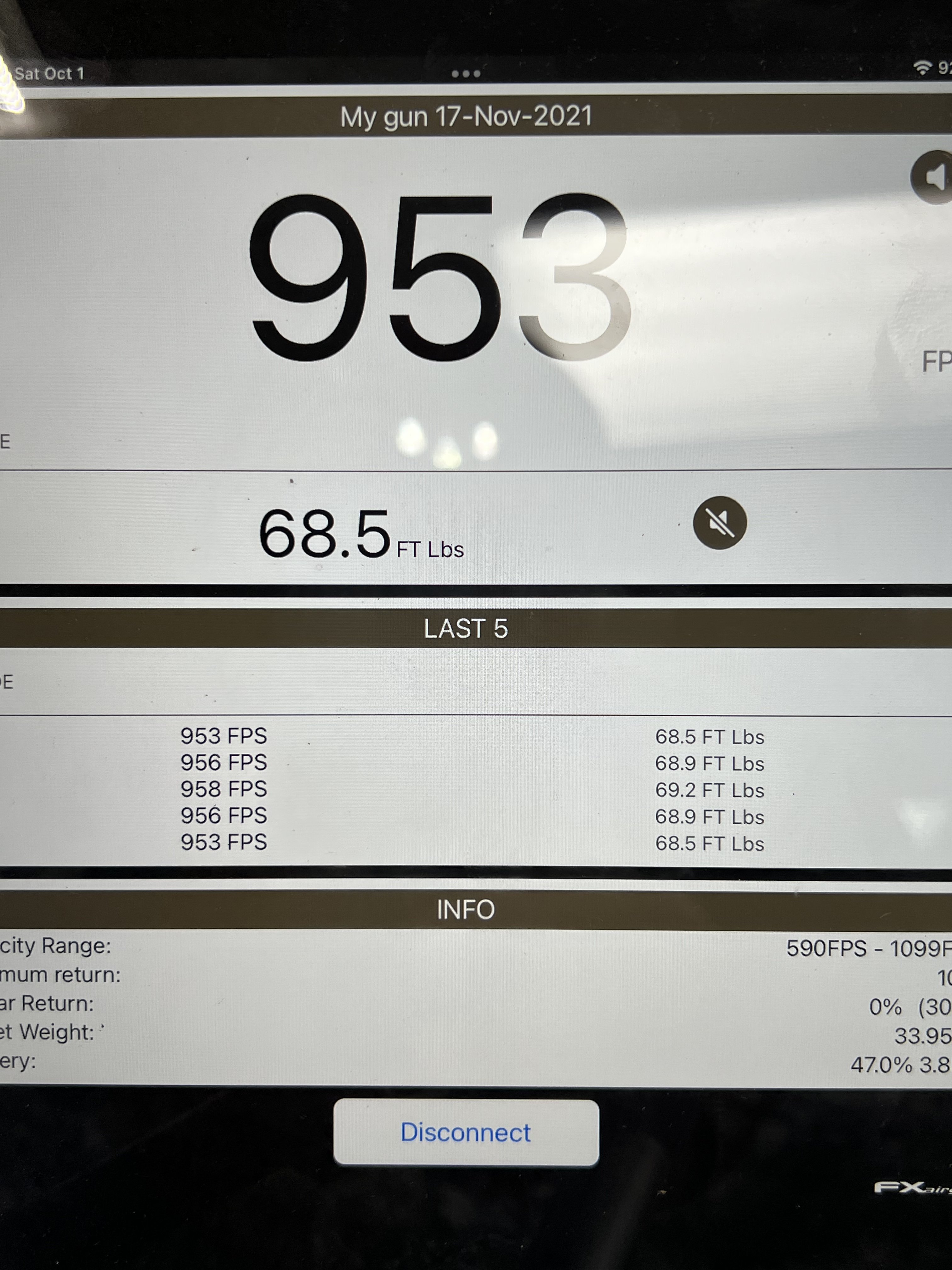

This is as consistent as I could get my 22 Maverick with the Tungsten hammer weight. It went higher but this was much smoother, sounded better and most consistent.
What caliber is it? What are the reg settings? I'm assuming 25cal, but not sure. I've done 1032fps with a 34 grain pellet out of my Maverick Sniper in 25cal. I'm pretty sure with the Tungsten you may be able to get 1050.
What is the tune you had in your .25 mavrick to get those numbers ? Can you run down your whole set up to me ?
