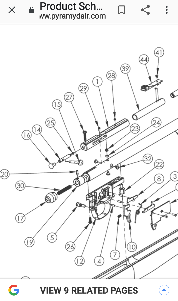

Air tube holding pressurized air as required so look beyond to either the TP o-ring or the o-ring at the bolt probe. Easy test: put a piece of tissue over the breech port after loading a pellet and look for air blasting back out around the probe when you shoot. If tissue shows air leak then replace that o-ring. If no tissue movement then a leak around the transfer port (TP) is likely the culprit.
#25 probe o-ring is what was mentioned.

You can degass it for safety if you want or not as long as you DONT TOUCH #32x3 valve retaining screws.

Remove #27, 28, 29. Don't strip the screws.
Remove barrel band and front sight screws or LDC threaded adapter screws and remove.
Remove upper barrel/breech assembly.
Remove #26 and 27. Remove endcap, hammer spring and hammer.
Remove trigger housing/ stock point retaining mounting screw #22 remove trigger housing assembly.

Check #23 and 24 if Transfer port may possibly have an obstruction and o-ring may be squashed and needs replacing.
Check #20 and 15 aren't bent.
