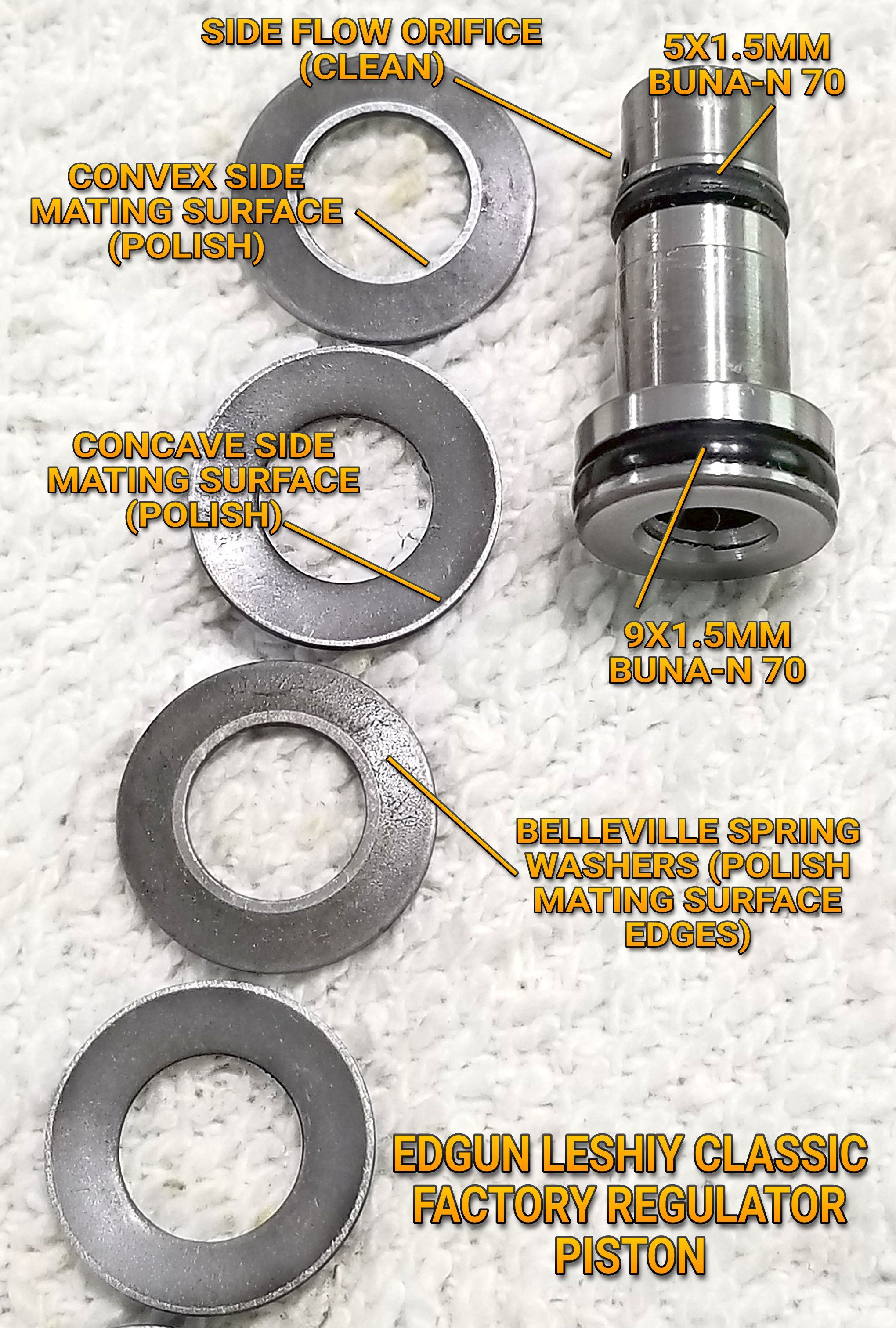

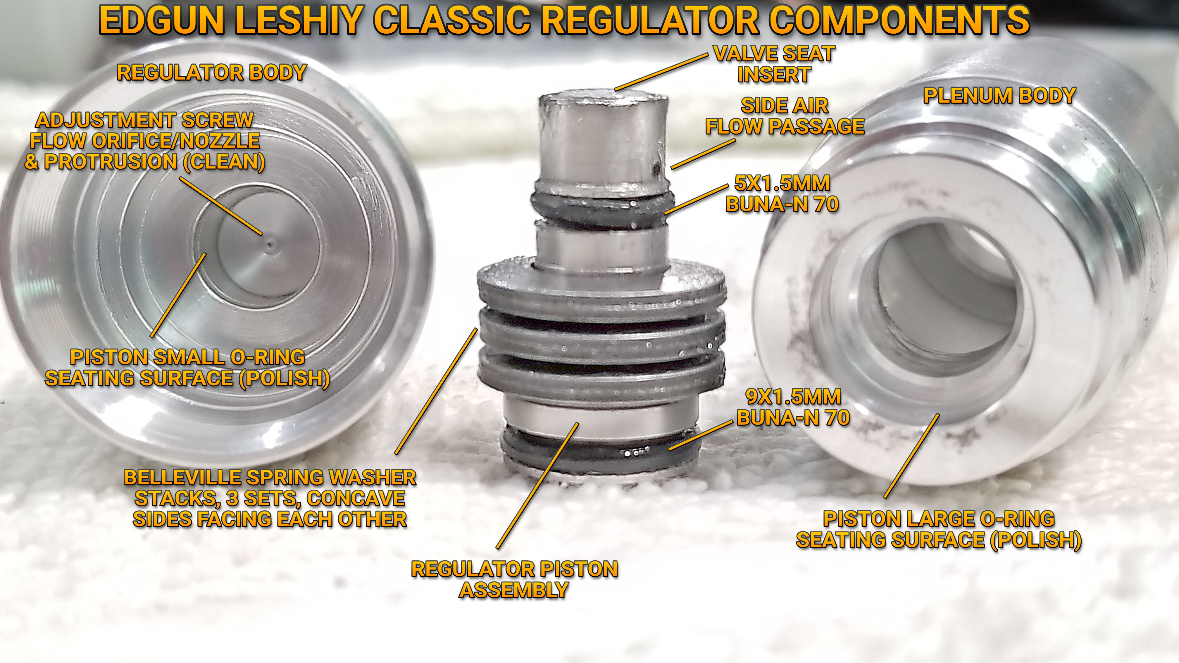

I've watched videos from Ernest Rowe where he is tuning up a regulator by polishing all of the bearing surfaces for the seals and the Belleville washers using polishing paste such as flitz and 3M abrasive papers. Then all of the surfaces have been wiped with a sparing amount of silicone grease, just a thin film wiped with fingers.

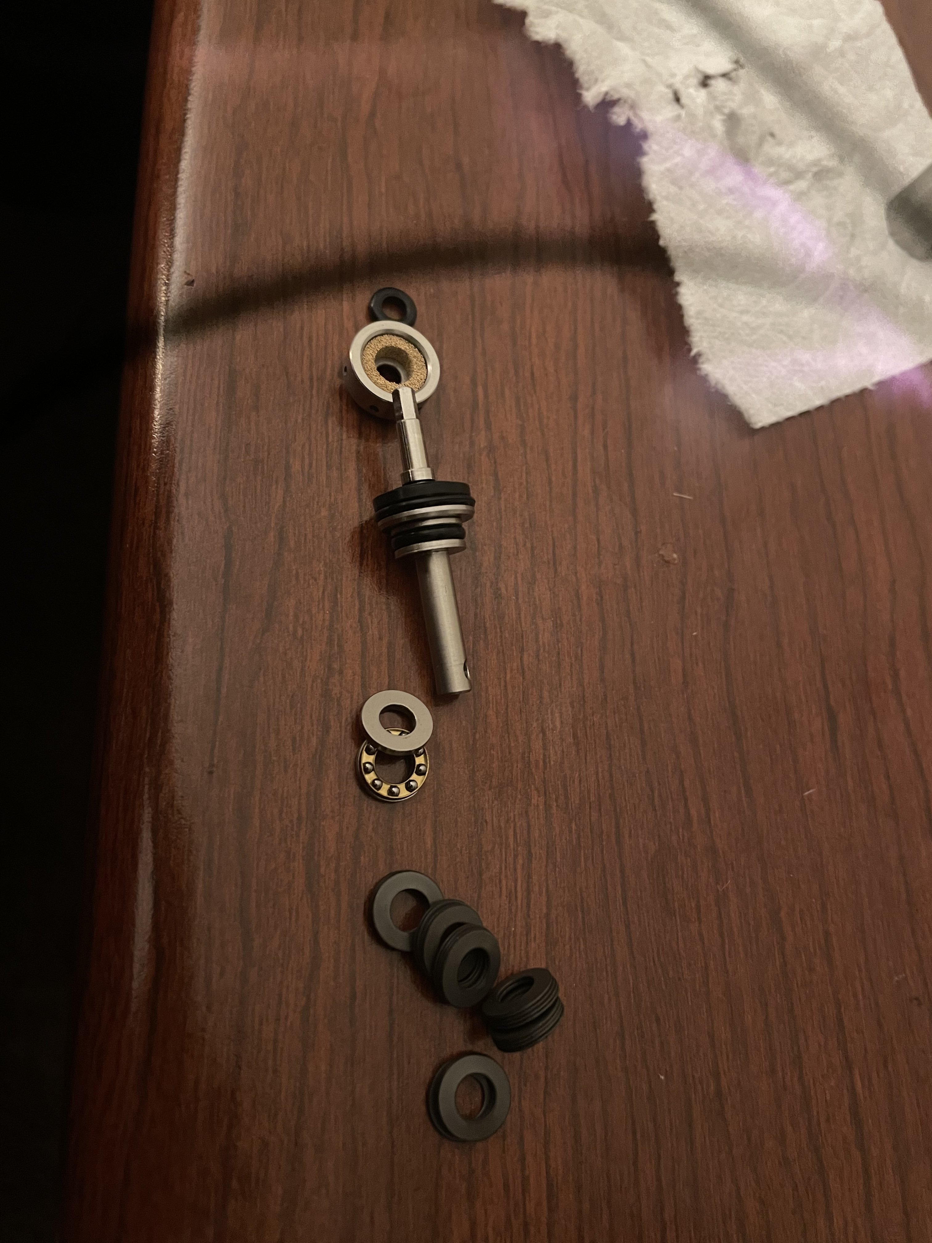

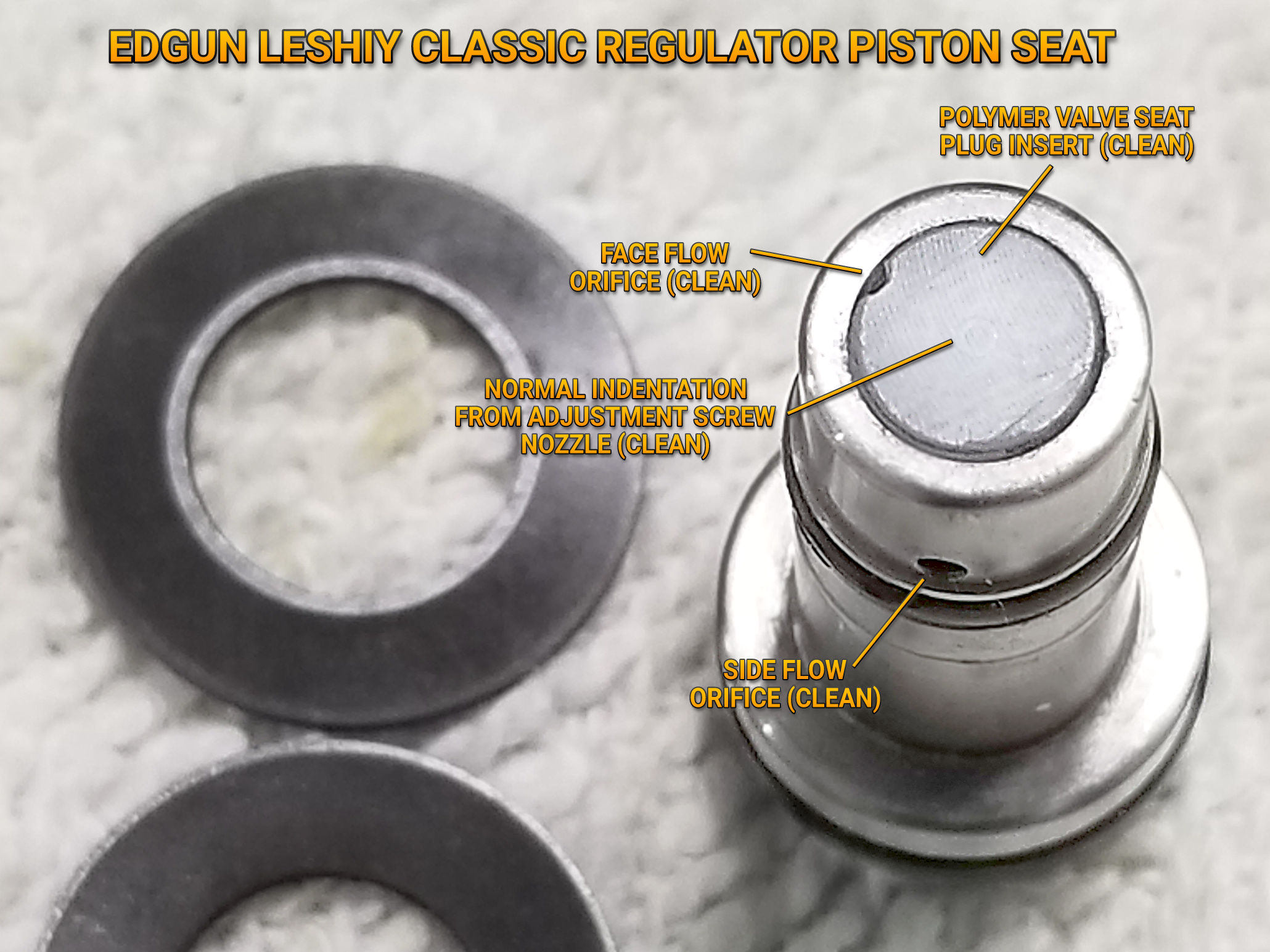

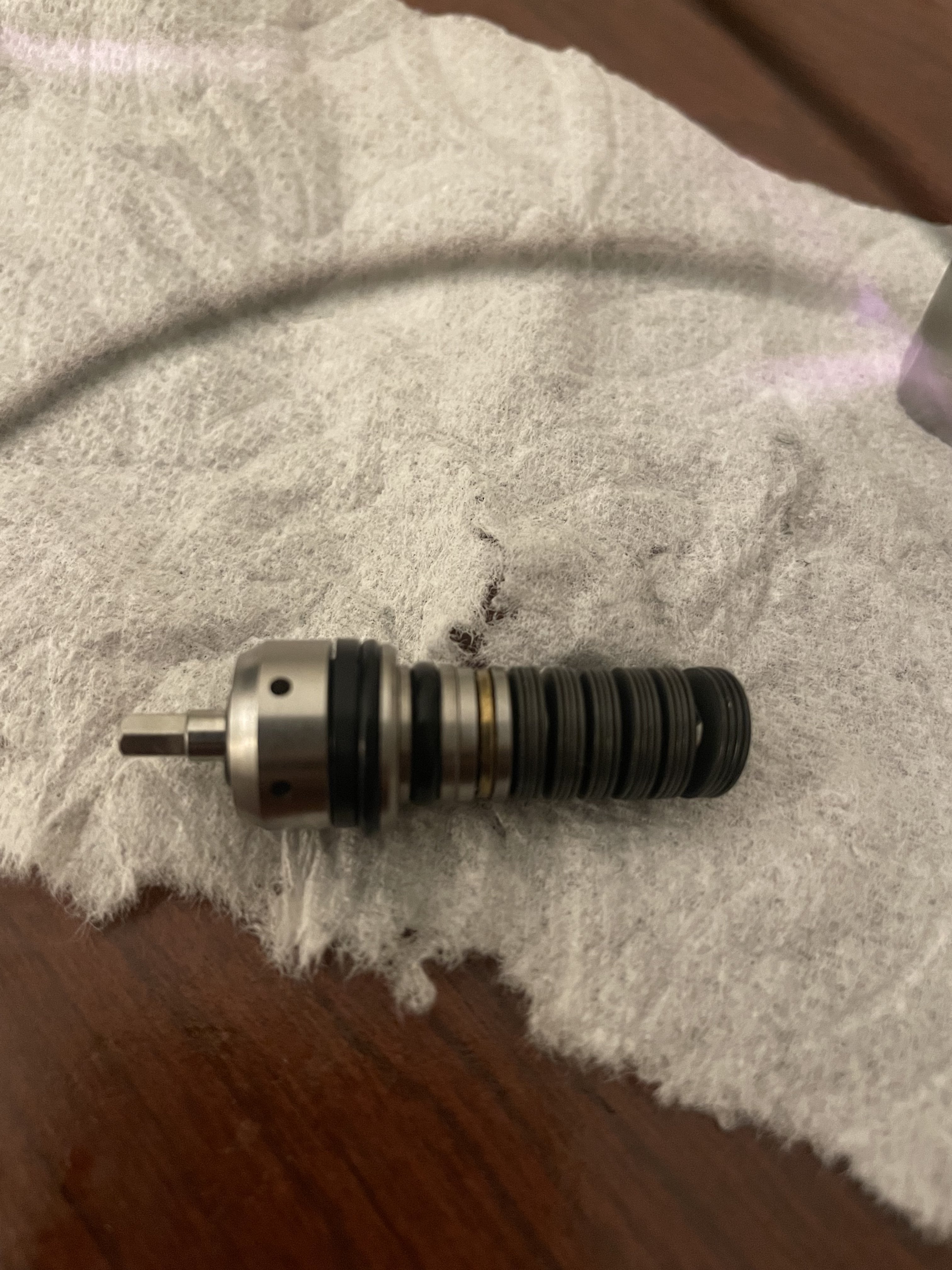

I don't see any shiny spots on your Belleville washers where the edges touch so they are definitely not broken in yet. I polished mine by applying flitz polishing paste and rubbing them on old bits of terry cloth. You can see smooth shiny areas appear after this. I did this to my Edgun regulators. Here are some pics from the Leshiy Classic regulator tune up I did and you can see the polished shiny circles on the washers for instance. I notated and polished surfaces where O-rings slide when the regulator piston makes its tiny movements after each shot cycle. This should give you some ideas for perhaps tuning up your own reg. Make sure to find out where the tiny valve sealing surface face is and little air passages and make sure everything is free of debris, smooth and clean.
Your regulator parts look pretty smooth and fairly well polished in the photo as far as I could tell. The construction is different so I'm sure others who have done this will have more to offer.
