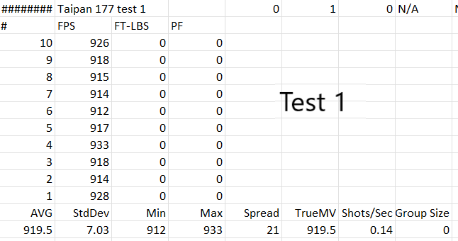

Maybe I was too optimistic for my Taipan .177 Standard accuracy?

EDIT- I just shot a few magazines a while ago to determine my max speed with FX 10.3s and it was WAY TOO HOT at 1040 fps. That would make the knee as I understand it to be around 1009 fps. Again, wayyyy too fast for my desired speed of mid to upper 800's. I just can't seem to tame this regulator down. So, I called Tony at Talon Tunes and told him to send me a HUMA regulator set at 100 bar. Maybe that will finally put an end to this saga!
