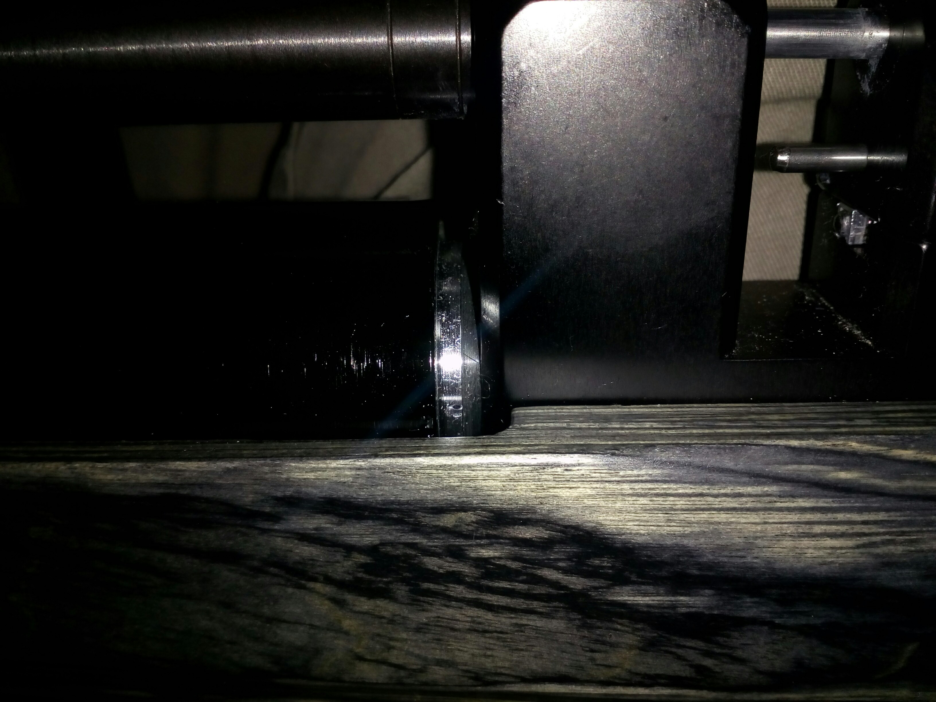

I’m with Mickshooter in that bull pups are difficult to shoot.
I sent my .25 marauder to a guy to have a supposedly super accurate after market barrel put on as well as a bull pup stock.
He sent me the rifle and I couldn’t get a decent group at 30 yards, and I was carefully shooting from a bench using bags.
After a few hundred shots I was sure the gun must have been damaged in shipping.
Long story short I sent it back to the guy who promptly shot a tiny group with it.
He explained that bull pups are much more difficult to shoot than a regular rifle.
So I put the action and new barrel back into the factory stock and boy oh boy did it shoot!
It just seems like if Tony got good groups with it, but you didn’t, it could be shooting technique.
I would be tempted to simply start over with the gun nested solidly in bags, front and rear on a solid bench and at 20 yards.
It’s more difficult to do with a bull pup because they are shaped different and will sit in the bags differently.
Concentrate on doing it exactly the same each shot.
Even the way you have your hand on the bag and your finger on the trigger must be the same each shot or something is going to move the gun just enough to wreck it all!
Concentrate on the “aim small miss small” concept and think the pellet through the bull.
Do everything you already know like follow through and breathing with a new concentration and slowly!
I tend to get discouraged with a miss and it can break my concentration and then I’m not doing everything I need to do for accuracy.
Instead I find myself moving in frustration to the next bull with broken concentration… thinking it must be the rifle!
I catch myself doing this with my RedWolf lol!! And it’s always me, not the rifle.
Please don’t be offended because I’m not meaning that you can’t shoot, just sharing what I experienced myself.

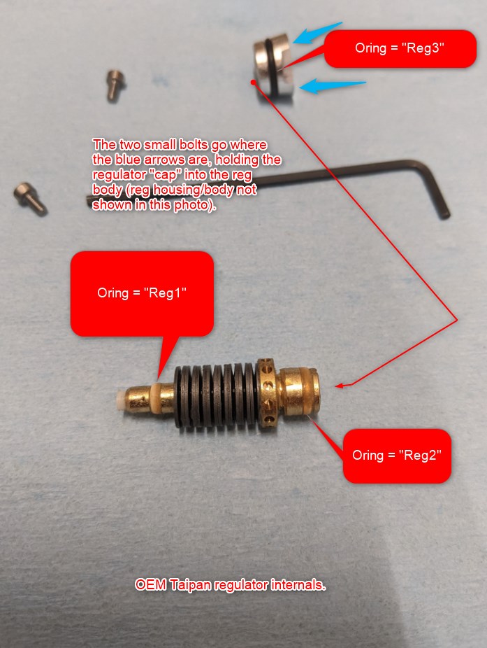

I took my regulator out and thought I would lower it a little and I noticed that the brass adjuster ring was literally free-floating. I could just spin it counterclockwise almost. That doesn't seem right? So, I don't have a reg tester. I have no starting reference point. What should I do? By a reg tester or order a HUMA regulator?
The huma's are dicey with the Taipans because of the different sized airtubes ( short, standard, long ). It has to do with the spacer that comes with the huma for the plenum. I have a .22 long and a .177 standard - both with huma's in them. I got creative with my .22 a couple of years ago and (literally) hack sawed and filed it to the proper length and . . . got lucky and it works. There is a thread in here about that saga someplace - you might be able to find it via the search. I got lucky with the .177 a year or two down the road and that one just worked right from the get go. Both of my Taipan's are ~super~ consistent in FPS with the huma's in them.
I wonder if you could put a drop of blue locktite on the threads of the regulator to get the adjustment wheel to not move so easily (once the locktite dries). I think I'd do that, let it dry for at least a few hours then put it together and shoot it. I would set the regulator at minimum. You should still be able to move the reg with the locktite on it but the more you move it, the more freely it will move.
You have to hold the adjustment stem with machine screw at the top to keep the whole assembly from turning. You want the center stationary while you turn the collar.

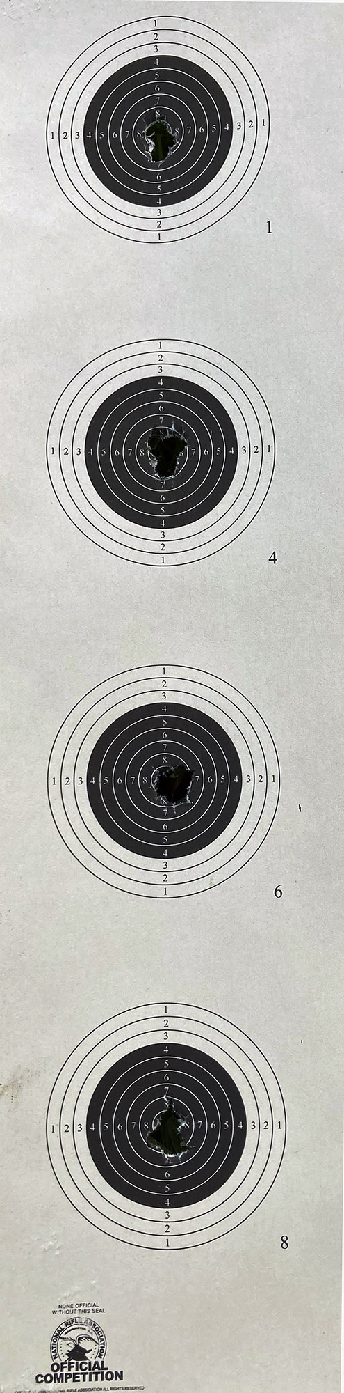

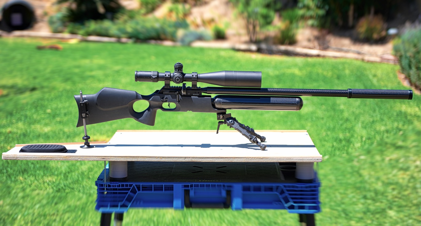

Ditch it and get the FX Crown that shoots hole in hole right out of the box and the action and mag are in front of you and how a normal rifle format beat the bull pup shorty every time
I did that. The brass ring was so loose that there was no tension whatsoever on the washers. It was as though it had been loosened past the point of any effectiveness. I turned it clockwise 4 or 5 holes and I could feel some tension start to build. There brass ring was essentially floating with no tension in either direction. I watched Ernest Rowe's video about 5 times before I even attempted this. His regulator showed tension in both directions. Mine was free floating with no tension in either direction. I know that can't be good! Since I don't have a reg tester, I thought I would put 3 or 4 holes worth of pressure on the washers and reassemble it. It couldn't have been working before which I think would explain some of the strange ES readings and bizarre first shots being 25 fps higher than the rest of the string.
About the huma reg. The spacer which came with my reg was maybe one or two mm longer than stock, when fitted. The difference it makes, is that the endcap on the gun, has to be screwed less inn, the same ammount. And that the black ring which is at the end of the tube will be dangling loose. That ring is there only for looks. I left it out on my gun as I did not want it to dangle. The only visible difference it makes, is that you will see some of the shiny end of the endcap, when tube is assembled. All the threads are still engages in the tube, so from a safety standpoint it should not make any difference. If you did not know the black ring was missing, you would never notice it. Here is a picture of how it looks:
I'd suggest that you open the regulator and check the washer stack.
Should look like this.
And more tension on the washers = higher output pressure. So, you don't want more tension than it had......unless they stacked the washers incorrectly....
I can't imagine how it was assembled in that manner. Unless Ernest or someone can offer advice on the initial assembly, it will be trial and error. And, given what you discovered, I think I would tear it down and make sure everything is there.
I watched the video, that is my only knowledge base. But it looked to me like removing the washer stack would be the easiest way to adjust the setting. It would also allow looking over the washers for any contamination or damage. With the parts out, you could just spin the adjustment screw to minimum and possibly put a drop of locktite on it. It seems like it might have been at the minimum but disassembly would tell you. The washers can also apparently "catch" on the center stem which would seem to affect operation.
It is in the picture but may not be obvious. There is a washer facing out on each end of the stack and everything inbetween should be matched pairs of washers.
