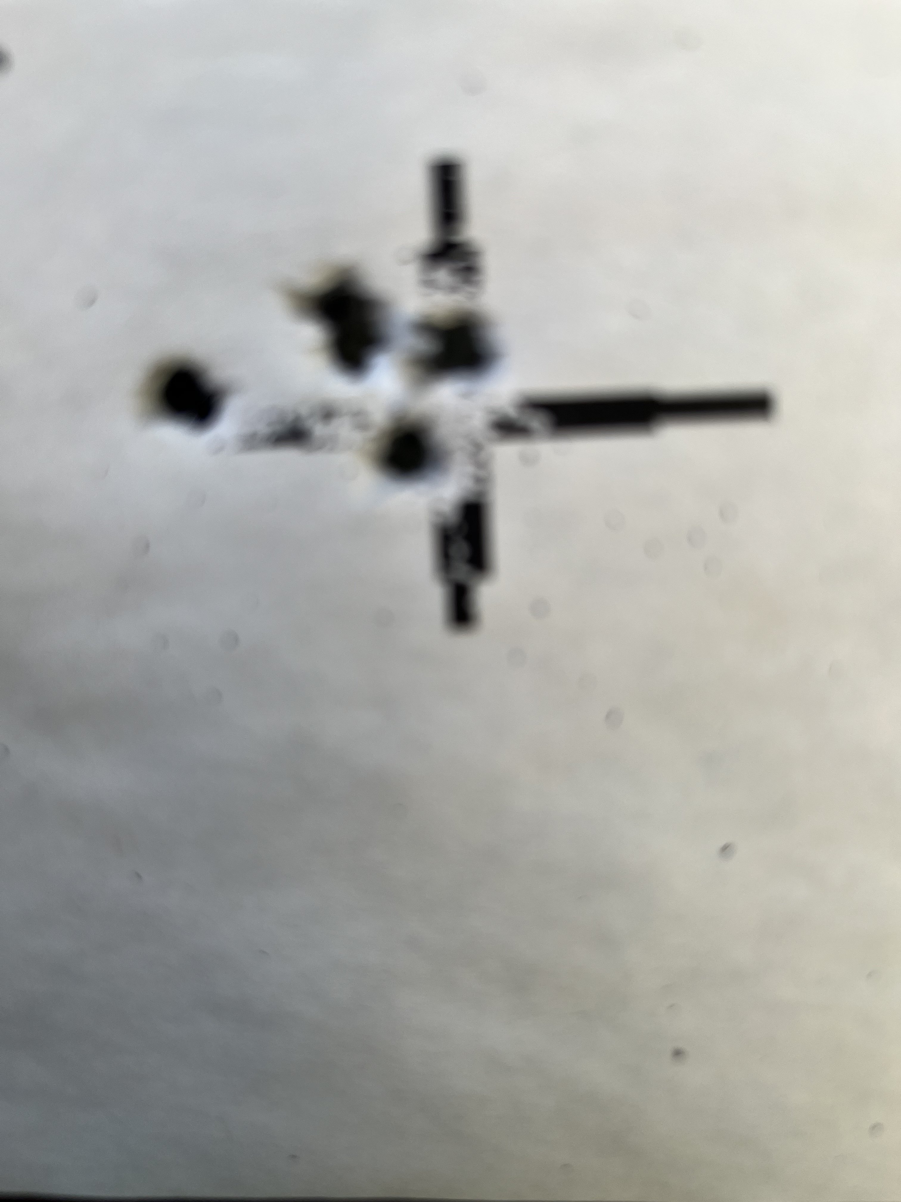

I share with you a group of 6 shots at 70 yards with my Vulcan 3. 177 Cal.
It was made with JSB 8.44 grain.

I went down to 750 and up too 1060 and never got good groups. I really believed that 1/2" groups at 40 yards should have been easy to achieve. I will begin trying to solve this problem on my own I guess. Maybe a Lothar Walther barrel?

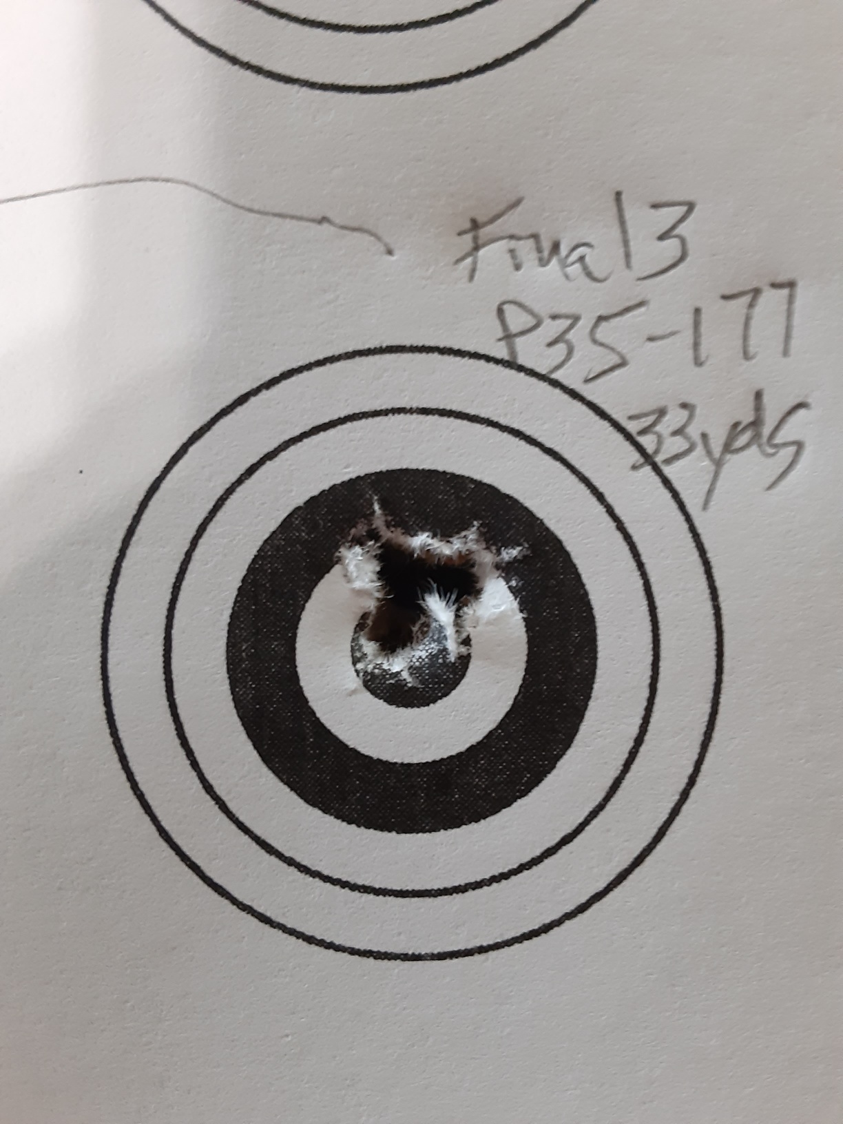

I have no Taipan experience but it is a gun I'm considering for my first "premium" air rifle. I can't shoot beyond 33 yards in my backyard so I haven't shot my 1 month old P35 in 177 further than this. But I think it groups better than your Taipan is at the moment. My 22 caliber P35 shoots better but the P35 is a relatively inexpensive gun with a fair bit of variability. I would expect consistent accuracy from a Taipan. I'd return it to Utah Air guns if you can. Or if you want to keep it, mess with the barrel. My P35s needed the crown polished with JBs on a brass screw. It isn't hard but shouldn't be necessary on a Taipan. Pushing a pellet to make sure the bore feels smooth and consistent would be a good non-invasive test. Removal of the barrel would also allow inspection of the crown.
