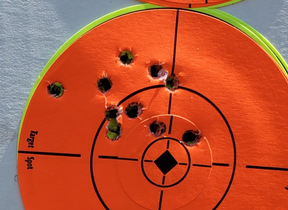

Here's a sample of one of my "groups" before I sent the rifle back:

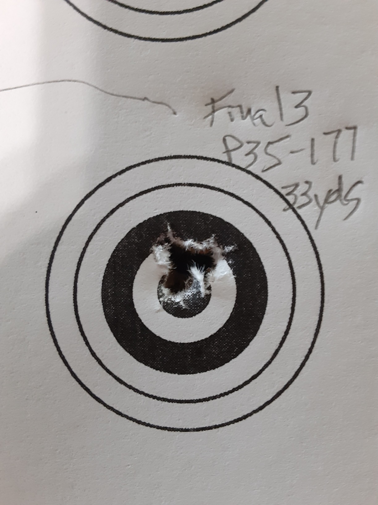

I have no Taipan experience but it is a gun I'm considering for my first "premium" air rifle. I can't shoot beyond 33 yards in my backyard so I haven't shot my 1 month old P35 in 177 further than this. But I think it groups better than your Taipan is at the moment. My 22 caliber P35 shoots better but the P35 is a relatively inexpensive gun with a fair bit of variability. I would expect consistent accuracy from a Taipan. I'd return it to Utah Air guns if you can. Or if you want to keep it, mess with the barrel. My P35s needed the crown polished with JBs on a brass screw. It isn't hard but shouldn't be necessary on a Taipan. Pushing a pellet to make sure the bore feels smooth and consistent would be a good non-invasive test. Removal of the barrel would also allow inspection of the crown. View attachment 279610View attachment 279610
Looks good! I'm envious!
Oh wow yeah that's bad for only 40 yards. I expect nothing less than dimes at 40 yards with 177 or I try a different projectile or barrel, unless it's a scope issue which is usually pretty obvious, or wind was an issue.
Yea, at 48 yards on my range Prophet, Vulcan, Uragan, all in 177 Dime size easy, (NO WIND) Sometimes I just have a blank paper up shoot once then aim at the hole, In the beginning of this paper stuff I am jumping around looking through a giant spotter scope, crazy flyer where did the pellet go, There is only one hole two shots, Hell guns shooting off the paper, Panic,,, LOL One hole two shots , 10 and twenty in one hole is tough,
