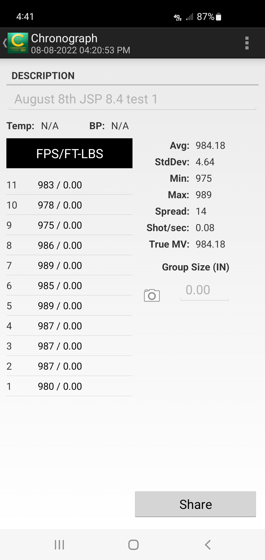

Here's what I'm dealing with today. I shot many targets at different speeds today but I ended up putting the speed back to what Tony originally had it and shot these two targets as best as I could at 40 yards with little to no wind. Here are the 2 targets and the accompanying stats from my chrony:

Did you go as low as 800fps with the JSB 8.4s? 980 is a bit hot for that pellet. And I ask specifically about the 800 cuz that's WFTF field target legal and lotsa matches have been won with that pellet at that particular speed.
I did so many tests that I'm not sure but I think I started the day with around upper 700's to 800 fps.
If the gun did shoot good indoor at 30 yard at the dealer, but doeas not shoot good at 40 yard outdoor, one explenation is maybe that pellets start to spiral beyond 30 yards? 980 fps with a 8 grain pellets sound to me not the best recipy for longer range accuracy.
All of my .177 guns shoot good with JSB exact 10 grains. I have a taipan veteran standard, and a airgun technology vulcan 2, wich both use CZ barrels. I would swap the 8 grains out with a 10 grains. Since the gun shoot 980 fps with the 8 grain, you might be lucky it will shoot good with the 10 grain, as the velocity will be slower. If that doeas not help, I would try every speed in 10 fps steps from at least 800 fps, and up to around 900, with the JSB exact heavy. And shoot at least two 5 shot groups on each setting, before continuing. If you only do one 5 shot group every time you adjust, the gun might not get setled in, on each setting
