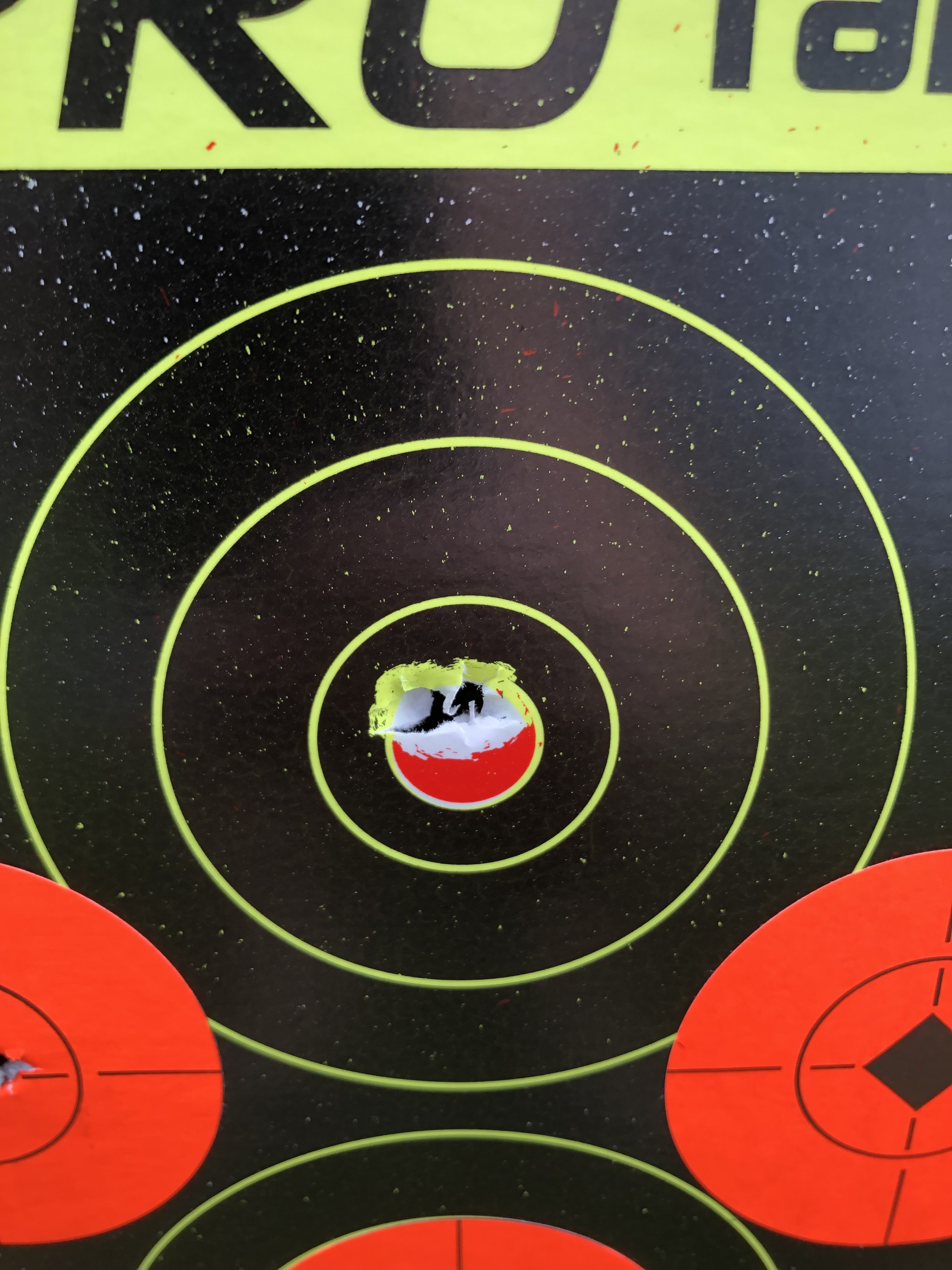

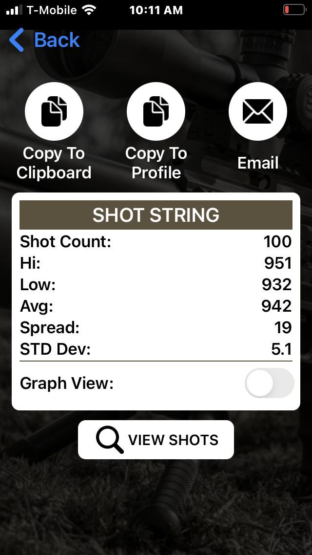

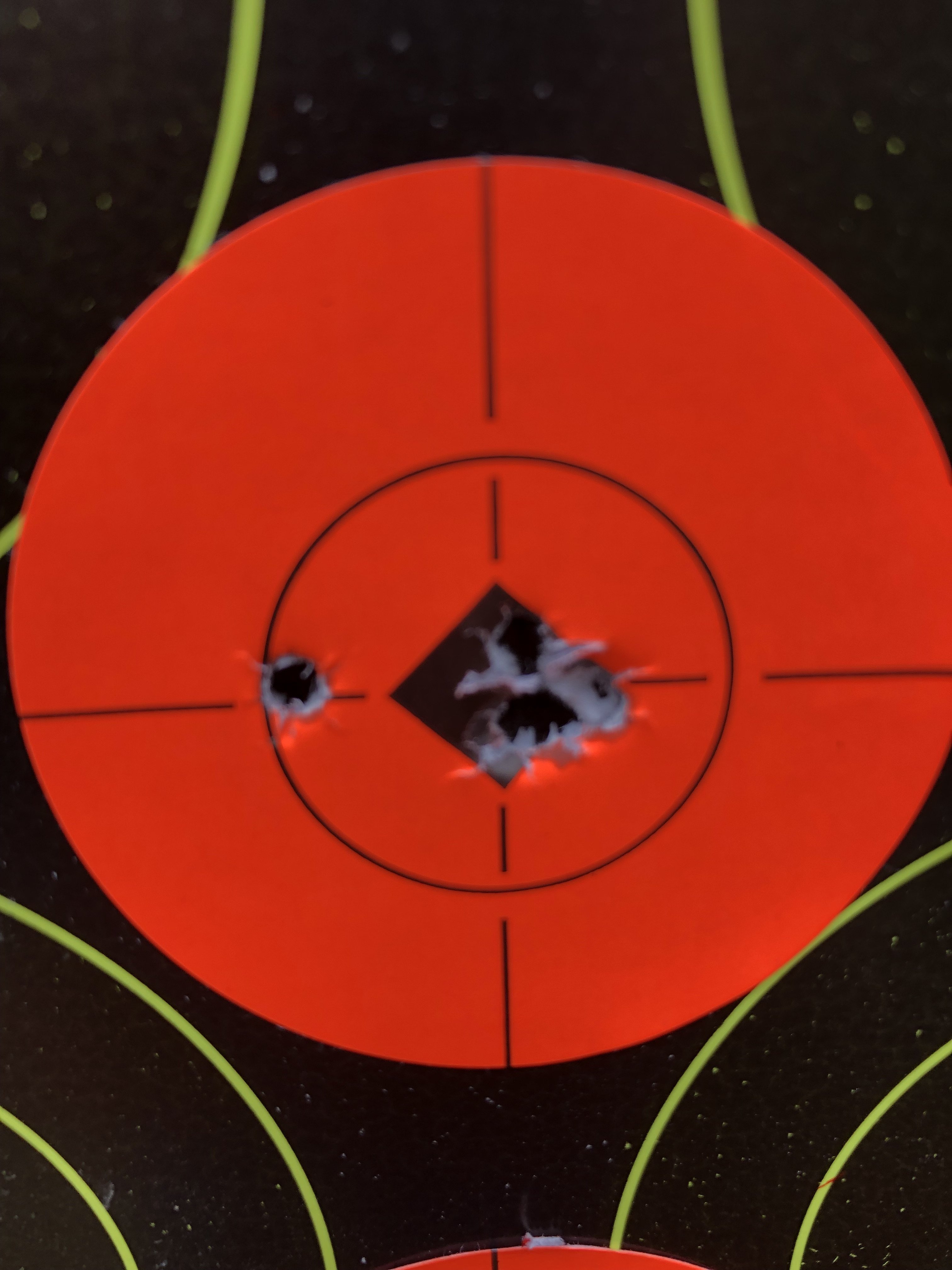

Maybe I was too optimistic for my Taipan .177 Standard accuracy?

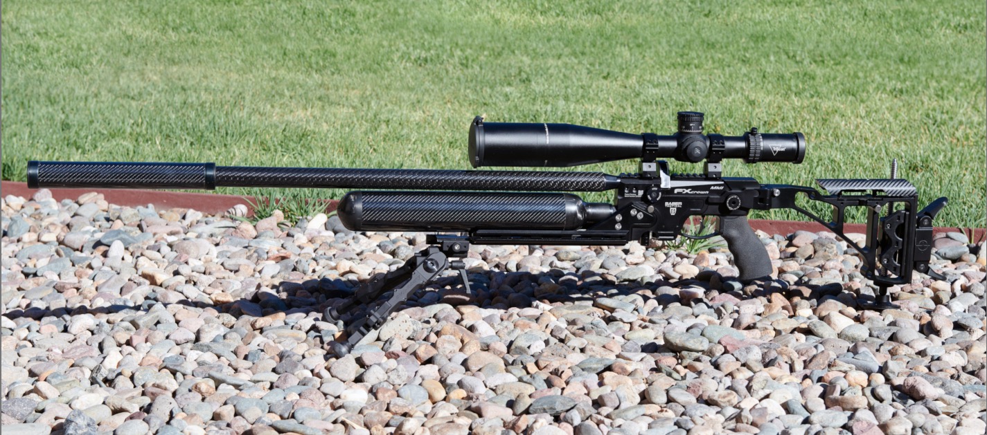

Sell it off and get the FX Crown and shoot hole in hole, with the little straw barrel :D

Thanks. I think you may have hit the nail on the head. Sounds a lot like my issue. I sent Tony the pics I posted here yesterday with the targets and stats and he said it looks like a pellet issue, too. Especially since I eliminated the scope from the equation. He said he was going to try to find some different pellets for me to try. The Air Arms sounds like a good start.

well i was testing few pellets today and all sudden gun sounded funny low shots here and there. put the chrony on it was jumping around pretty good 930 to 790 few shots think reg took a dump on new gun waiting to here from talon tunes about fixing it or replace me a reg to see if thats the case only got few days then im done for a while seems needed little more hammer spring or it coughed up something fine now it seems
few 50 yars groups pulled one as triggers light. lol darn was on a roll the 10.34 are close at 910 fps

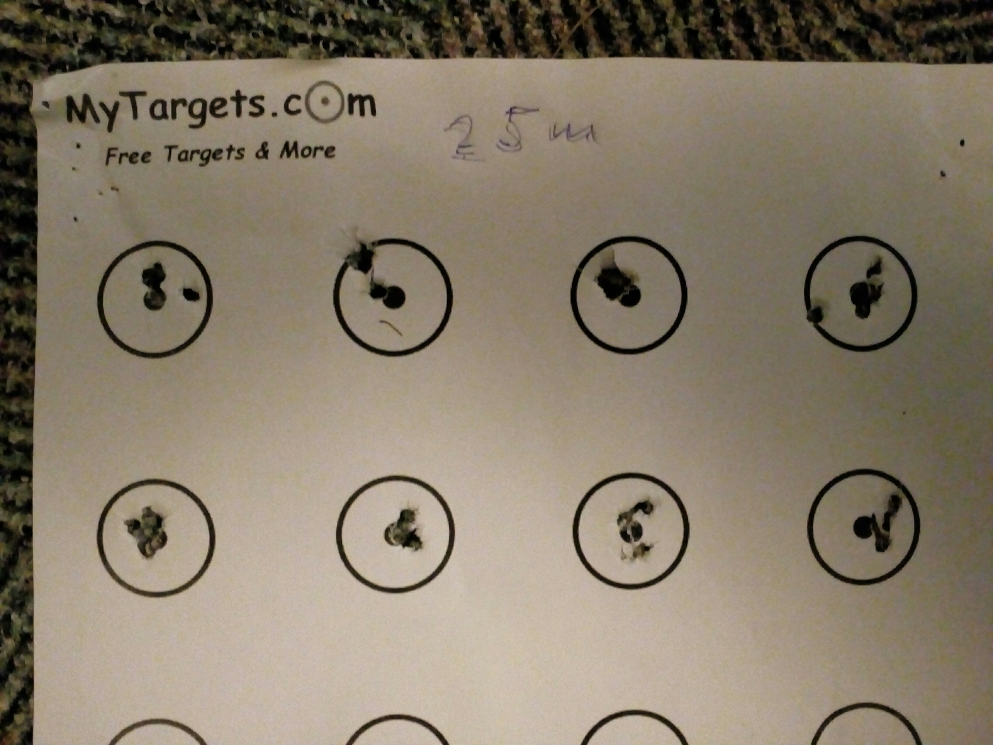

I took mine out today, to see if it still was accurate, and it was. This it at 25m with jsb exact heavy, at around 840 fps. Not hole in hole, but close if I cherry pick a couple of the groups. All 5 shots groups, shot in succesion. But It is a challenging gun to shoot on the bench, as it is quiet sensitive to hold. I needed several attempts before theese groups, as I have not shot it in months.
By the way, When my gun was new, I was able to shoot roughly twice the size a group. Or roughly the worst on this target. I have since installed a huma reg in mine. There was nothing wrong with the original reg, but it was set to high for my need. Around 120-130 bar I think. Since I also own a huma regtetester, I went that route, as for me it would be easier to adjust, than the stock reg. One thing I also found important is to get the trigger adjusted, as mine was setup with allot of creep, probably because of safety reasons, from the factory.
Hopefully good news! I just got my FX and Air Arms pellets in and I was able to shoot a couple of magazines of the 10.3's. The FX were so-so at whatever speed my rifle was set, but the Air Arms appeared to be grouping better at 40 yards than anything else I have tried so far in the JSB's. As soon as I can, I'll set up my chrony and give all of the pellets a try, wind allowing. I have some hope at this point!
