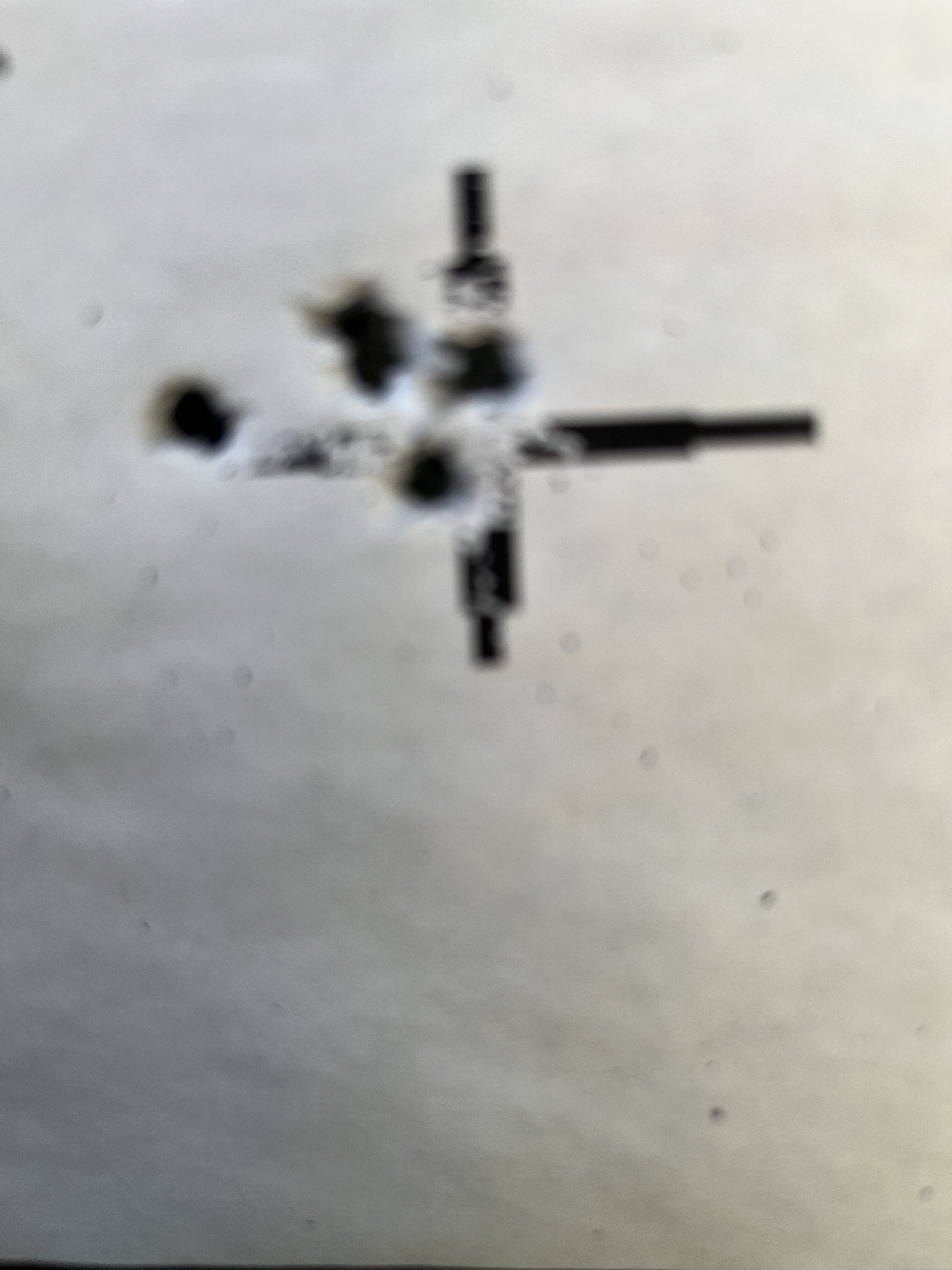

I share with you a group of 6 shots at 70 yards with my Vulcan 3. 177 Cal.
It was made with JSB 8.44 grain.
Notwithstanding is not what many people do on these days, try the following:
1.- get your back be fully rested on something that can't move;
2.- rise (if you are right handed) your right elbow and keep it fully rested;
3.- get rest of the rifle ar the adequate height;
4.- hold with your left hand the forearm as firm as possible to avoid movement at shot.
That is the way I get the very best performance on my shooting.
I do not know the speed yet but my guess is that is close to 1100 fps. I will measure it and share in a new post:
View attachment 279530View attachment 279531

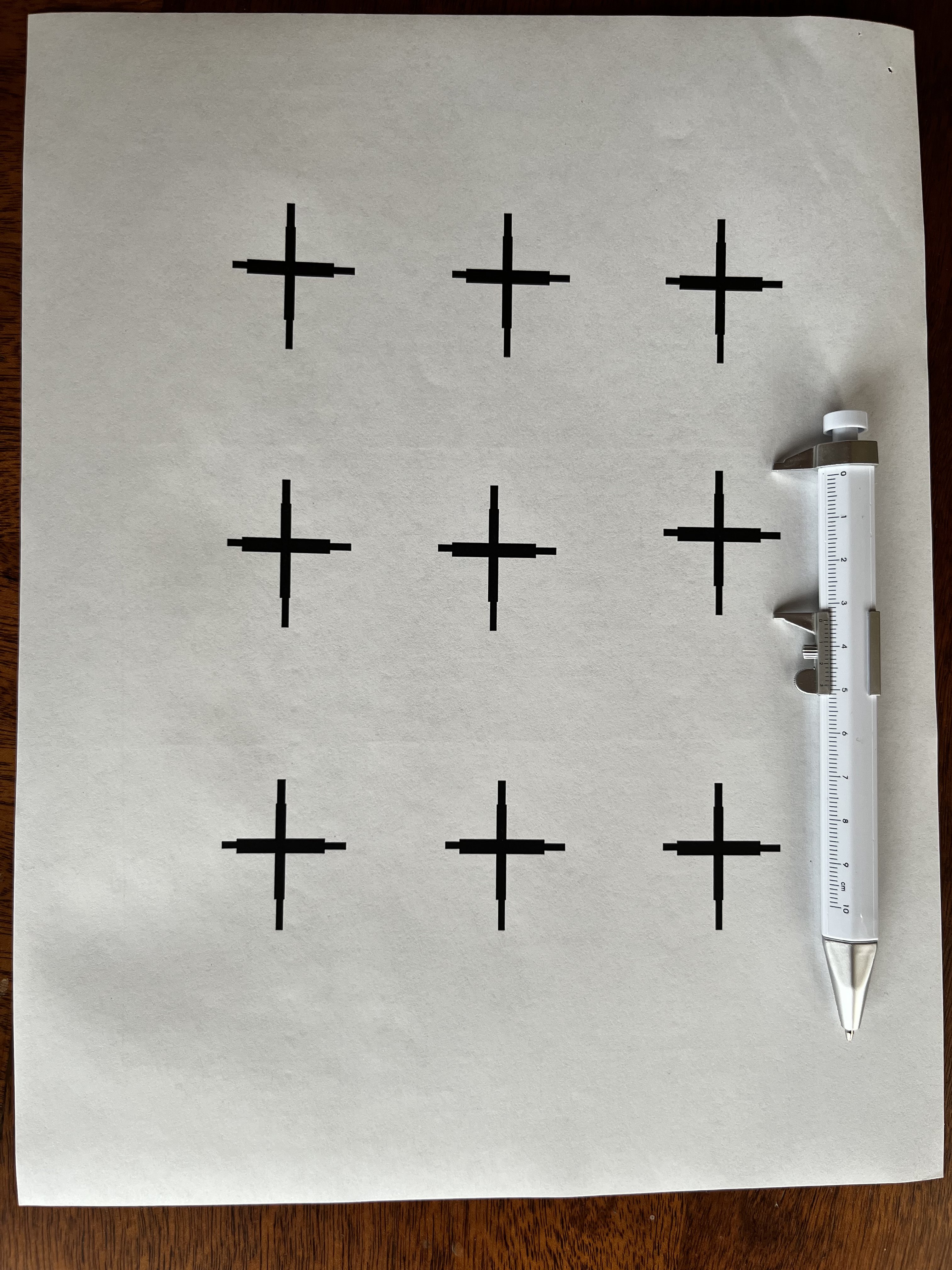

Where can i find the "pen/calipers ? i have been looking but never found , thanks
Buy an Aigun Technology rifle and the pen caliper is included.
If you do so, then you will have one of the best air rifles in the market and your pen caliper.
But if you are only interested in the caliper for sure you can find a more afordable option.
But if you are only intereses in the caliper for sure you can find a more afordable option.
Thanks that is a $35 item on Amazon.com
