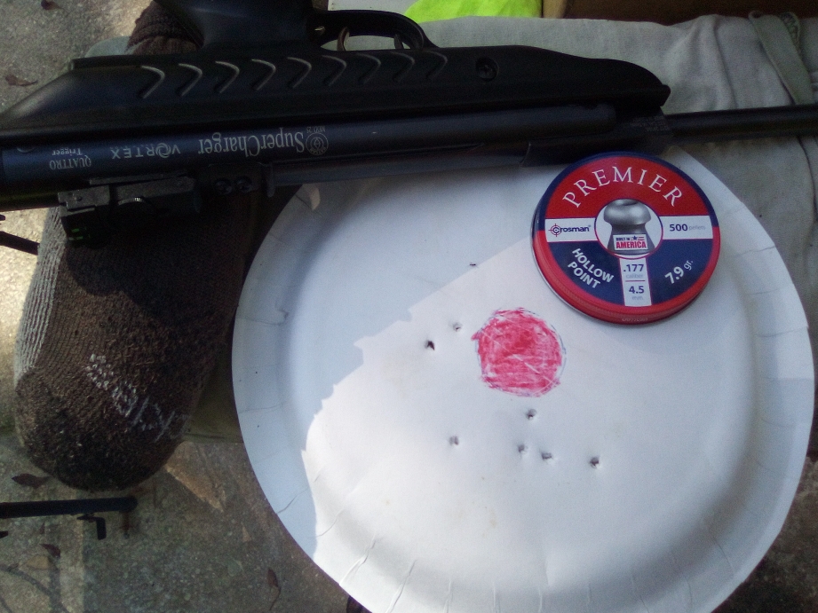

Heres some hatsan 25 work. From 10m to 50y.. all factory irons/ open sighted.
I guess i deleted ones to really show off indoor 10m. Plenty i posted at gta.. like in share your groups thread.. plenty...lol
It was gifted to me and the guy said he could not do anything with it.. seems to do plenty good for me.

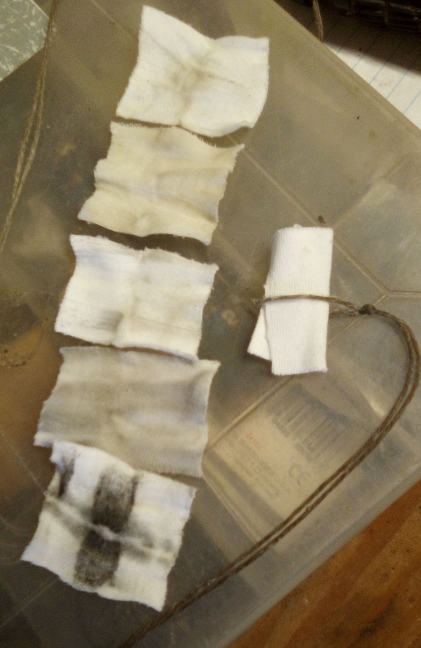

I like the sounds of that. Do you ever rod the barrel? If so, do you put anything on the patches? If not, is there ever enough lead buildup to interfere with the rifling? Just curious.

For .177 i use strong harness thread.
Then make my own " patchworm"
In the loop part i can use scotch Brite pad cut to size as a scrubber patch and normal patching. I can also use like brass wool as well but itd got hard to find local anymore.
Main thing is a real strong cord/thread/string. You DONT want it to snap 1/2 way in a barrel ( trust me )..
