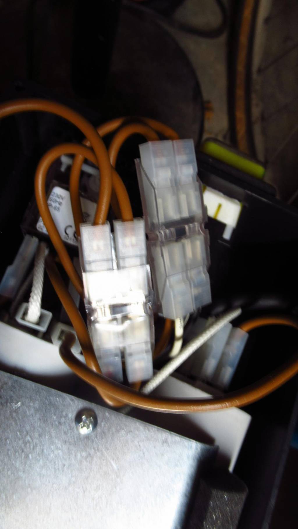

Would this be what you are talking about?: My Coltri has what looks like they could be thermal fuses on both legs of both capacitors.
I don't think so, those look like electrical blade 4x4 connectors? I think the plastic connectors on the wires is PETE and the plastic on the connector is HDPE?Sorry if I am wrong.
There (I think) should be a electrolytic capacitor across the motor leg that is plate rated. It, at least on mine, has a shunt resistor should the capacitor burn out. It then itself burns out during overload and disconnects the ability for the motor to spin because it severs the circuit. This way there is no way to burn up the motor during a voltage sizing/amperage sizing/breaker sizing/load sizing event.

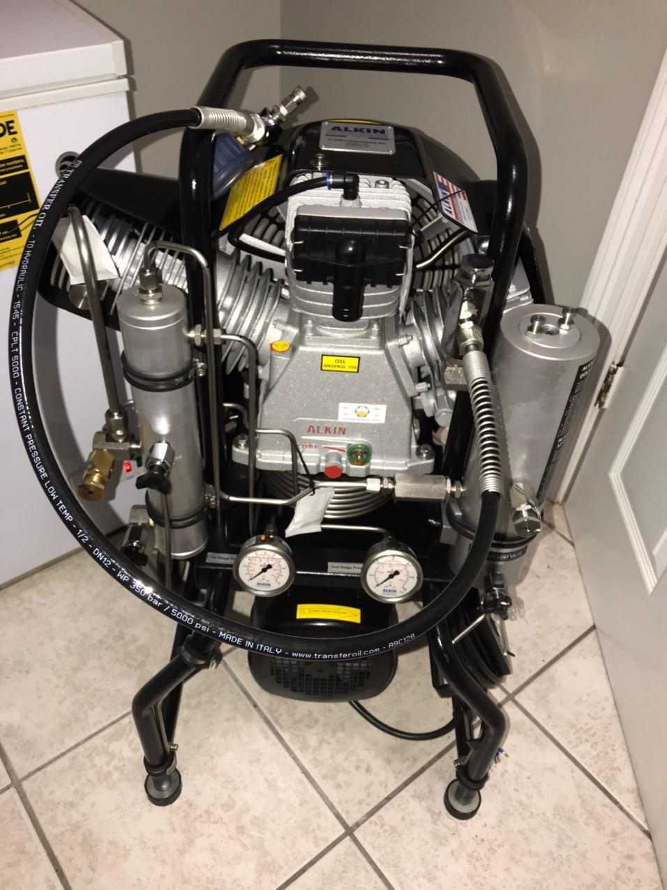

I just got my first High end compressor. It sure was heavy. I need to order the plug for it.

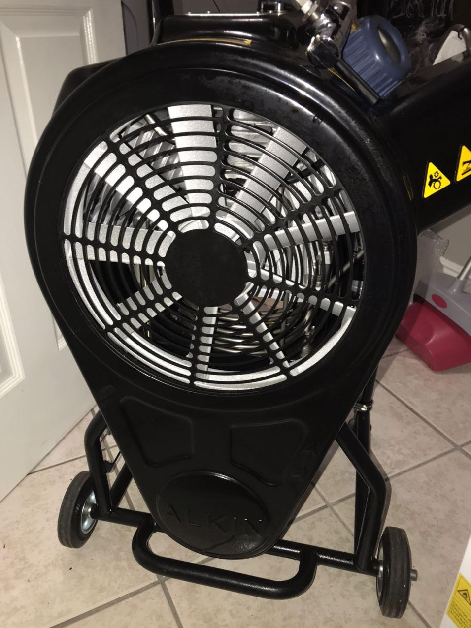

After using the Yong Heng for over a year, I decided to go with a more faster fill compressor without the need of external cooling.
After many research , My first choice was the MCH-6 but then I learnt about the Alkin W31 Mariner Vertical Compressor from
AGN forum. So I decided the Alkin W31 Mariner Vertical model will be my choice. It uses lower RPM so that mean less heats.

... It uses lower RPM so that mean less heats...
The amount of heat is not determined by design RPM. Heat is a function of the volume rate and pressure of the air being compressed. The Alkin appears to have a bigger fan and that would be a requirement since it is turning at a lower RPM than the Coltri.
A bigger fan that is turning slower, can cool the same as a smaller fan that is turning faster. Same heat dissapation.

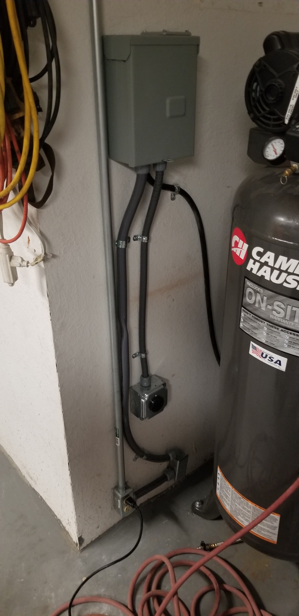

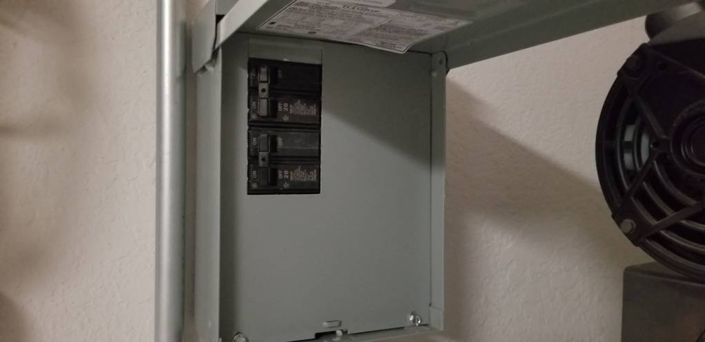

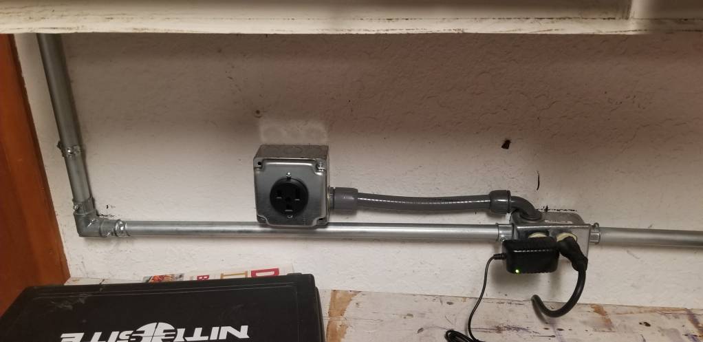

Update pictures of what I had done for the wiring. I had my electrician come in to run wire and this what he did:
He hard wired the shop compressor directly to the one breaker and then ran another outlet off the same break just incase I need to use my arc welder.
One breaker is for the compressor and the other is for the Coltri
From the breaker, he ran wire into the existing conduit and then adding another outlet for the Coltri
I think he did a great job. I would never have thought to hardwire the shop compressor in and I would have ran another conduit to my work bench. Very clean job. Now I can rest assure all my equipment will be safe.
For those asking about wiring size/gauge, according to the specs the load on the single phase model is 17 amps @ 230 volts. Different ways of figuring this but most residential electrical services are 120/240V. If you take 17A x 230V = 3,910 watts. Voltage goes up / amperage goes down so 3,910 watts divided by 240V = 16.3 amps. They are including in-rush of the motor at startup to achieve the 17A they claim. In-rush is short lived but can strain a motor a bit if being used on a heavily loaded circuit. Specs state 3hp / 2.2 kW, 2.2kW = 2.2 x 1,000 = 2,200 watts. 2,200 watts divided by 240V = 9.2 amps. 9.2A would be the assumed "full run load" for the compressor motor. In a residential setting, this unit would likely work just fine on 15A, 2-pole breaker with 14 gauge wire as long as the circuit is not heavily loaded. 20A, 2-pole breaker and 12 gauge wire will have no issues at all. A little extra information for those who might need it in the future, almost all standard distribution breakers, both commercially and residentially under 200A are designed to trip the breaker once they exceed 80% load of the stated breaker size, regardless of poles (1, 2 or 3). 20A breaker will trip if continuous load exceeds 16A (this does not count in-rush at startup for motors), 15A breaker will trip if continuous load exceeds 12A, 30A breaker will trip if continuous load exceeds 24A, so on and so forth. All that being said, if you're worried about your wiring, bump up one size in wire. Regarding the OP's original comment about the wire running deep into the motor, if it's factory wiring, I would leave it be as it was designed and built utilizing components and sizing they know to work as they want it to. Also, typically, internal motor wiring or cord wiring is totally different in spec than your standard household wiring. Hope this helps. Sorry it's so long!
