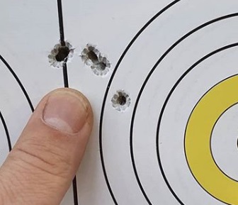

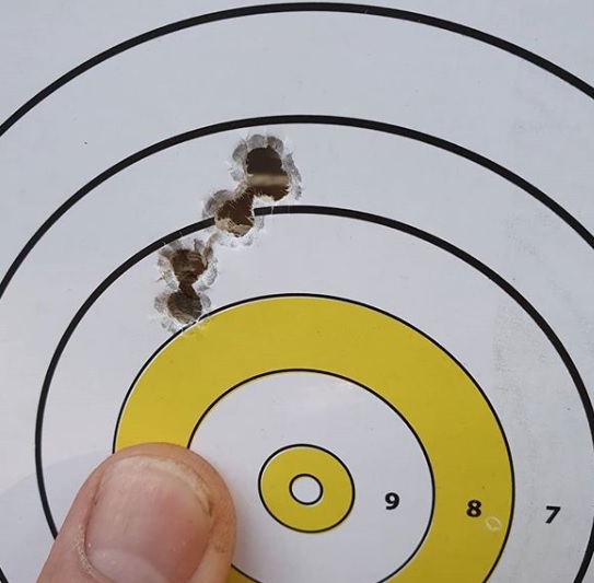

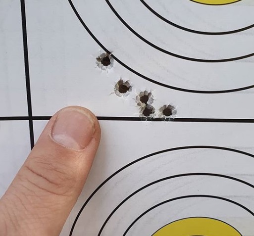

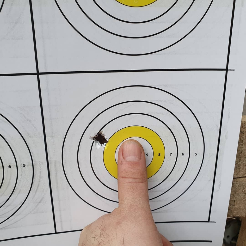

Meet "Silver Surfer" FX IMPACT MK2 150fpe on .30 cal
VarmintKnockers 62gn slugs, BIG YES!
Shooting 940fps @ 140 bar, and accuracy @ 100mt (not harmonic tuned yet, need more slugs!)
120 fpe +- and no sweat
FingerNail is half inch

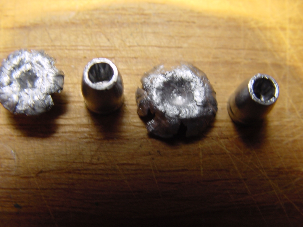

I have TJ's in .257, .250, .223 and now .172. I love Mike Saysers of TJ's Work. I have them in a Talon/Dor and Evanix RS !! an use NSA and D-Rigs Varmint Knockers, but mostly I cast my own from modded molds I re worked from NOE, Whom I am now working with on a few new designs.

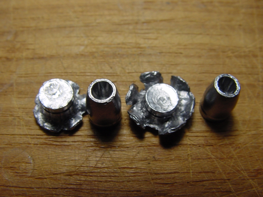

The .25 and .257 HP's that I cast are devastating on vermin and ultra accurate. They look very similar to Nicks of NSA, and we have talked about this a few times.

These are the .25's from the TJ's barrel at 960 fps at 4o grs.

Yes Greg, they are from a decked 84 gr ranchdog NOE mold, that I sent Eric at Hollow Point Mold services and had the deep cavities done. the are decked and sized in mirror polished sizers to be able to size down from .260 to .250 without issue. Normally this would distort the bullets, however, after polishing the interior of the
sizers, not an issue at all. Using imperial sizing wax, along with the polished interior, they go thru like butter on a hot skillet.
They are now 49.3 grs and sized to .2512" shooting at 96- to 990's depending on tune.
