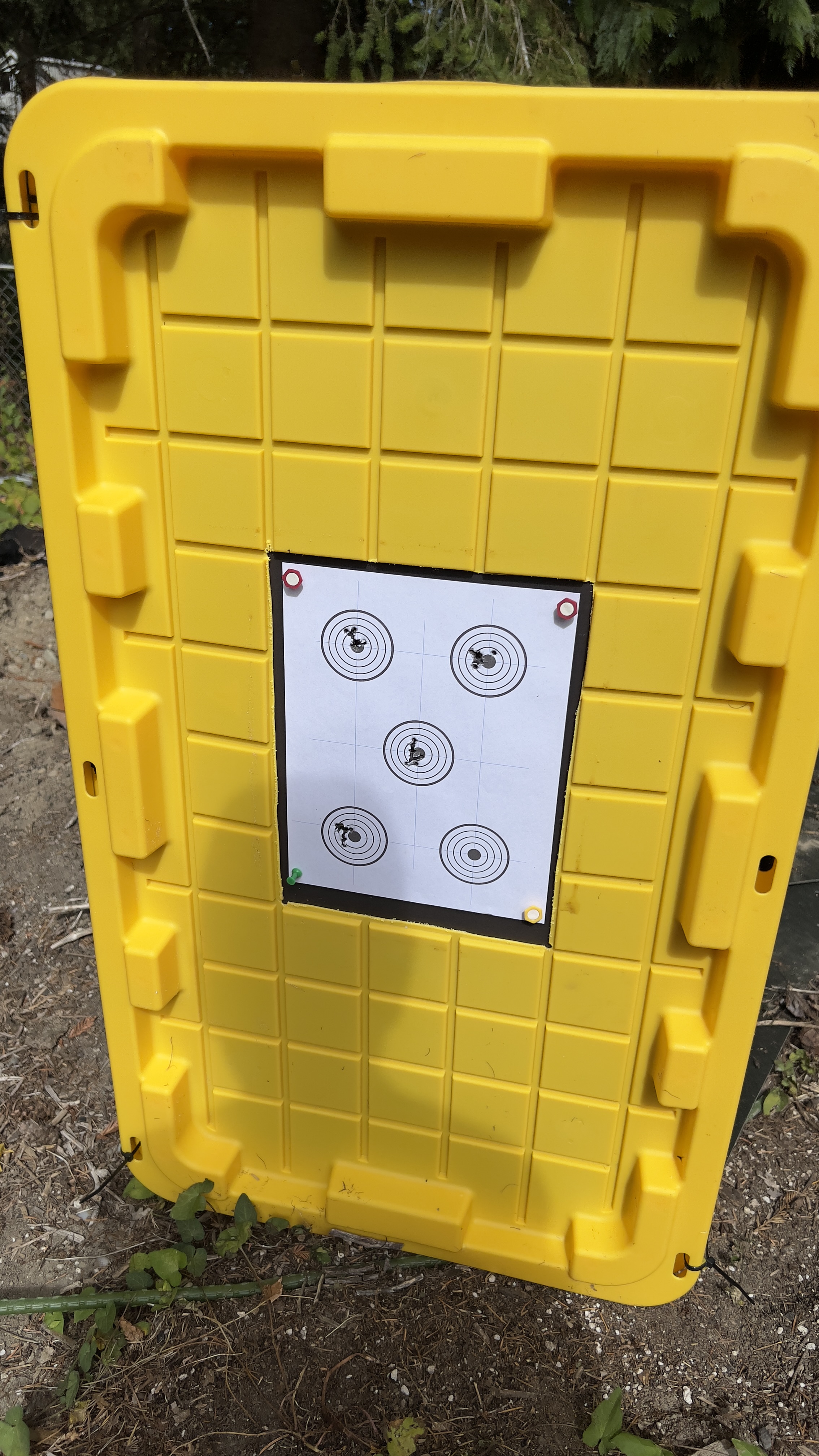

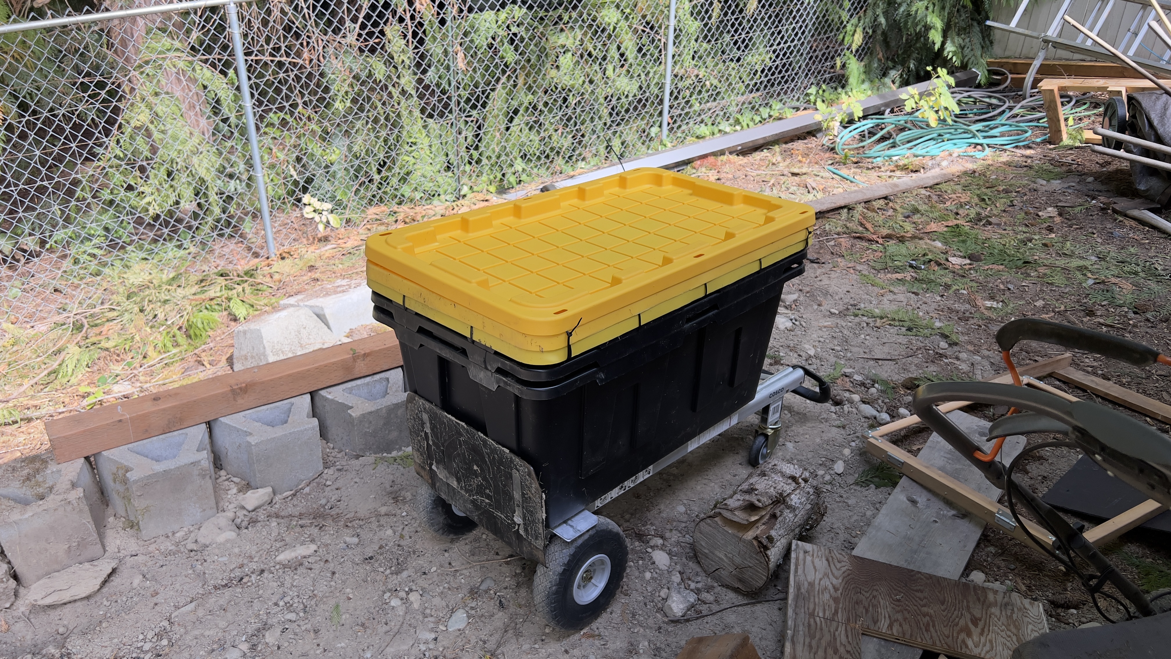

Seeing many of the concepts on this site and watching several YouTube videos I settled on the storage bin with rubber mulch concept. In my case I stepped it up with the large 40 gallon bin. A word of warning though is this thing is f#%king heavy so a smaller bin with a large backstop may be a better choice for some. In my case I’m only going to move it about 20’ and I like reducing the need for a large backstop.

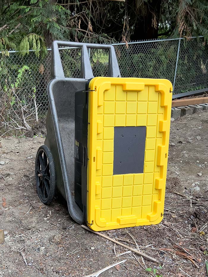

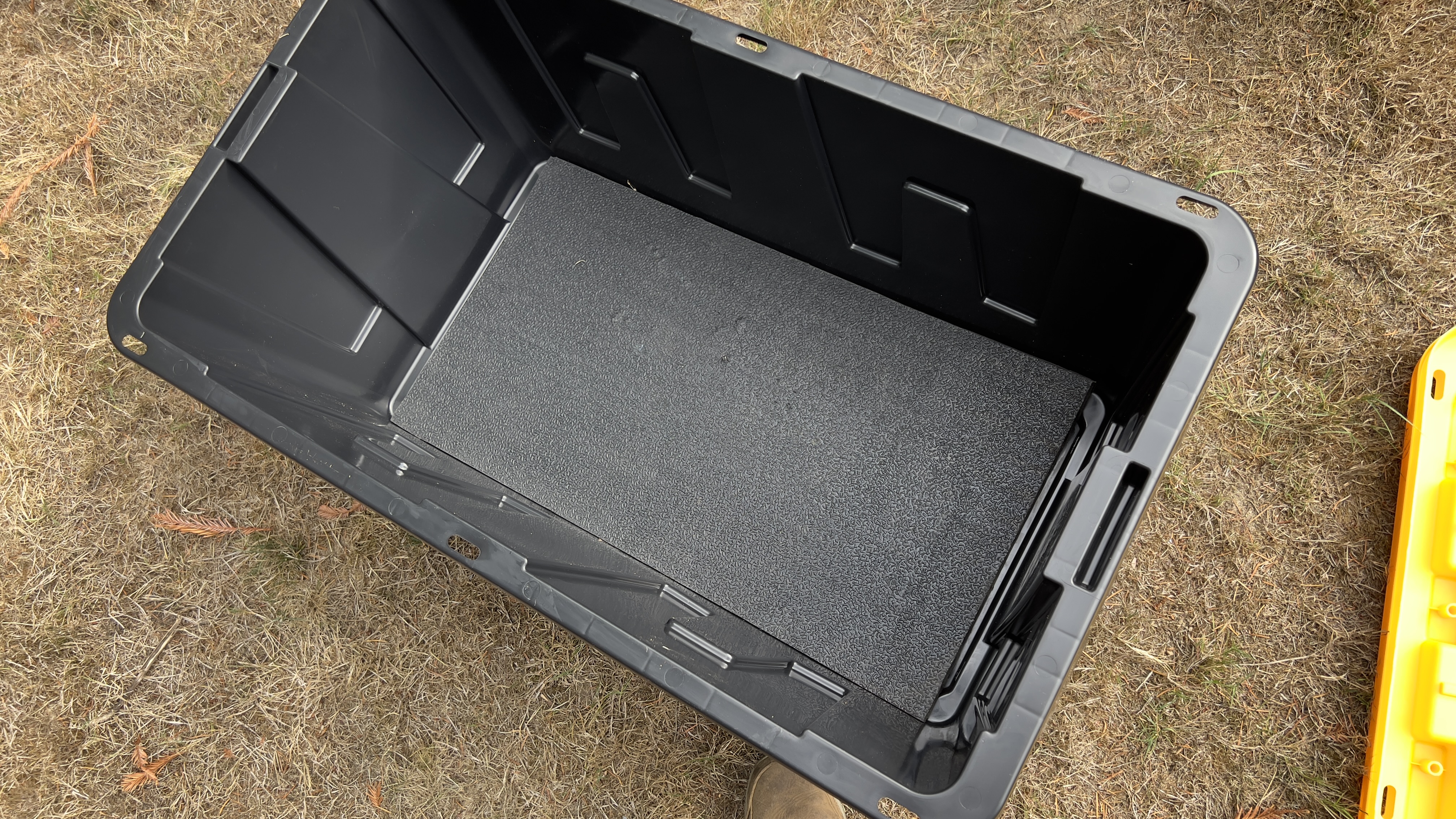

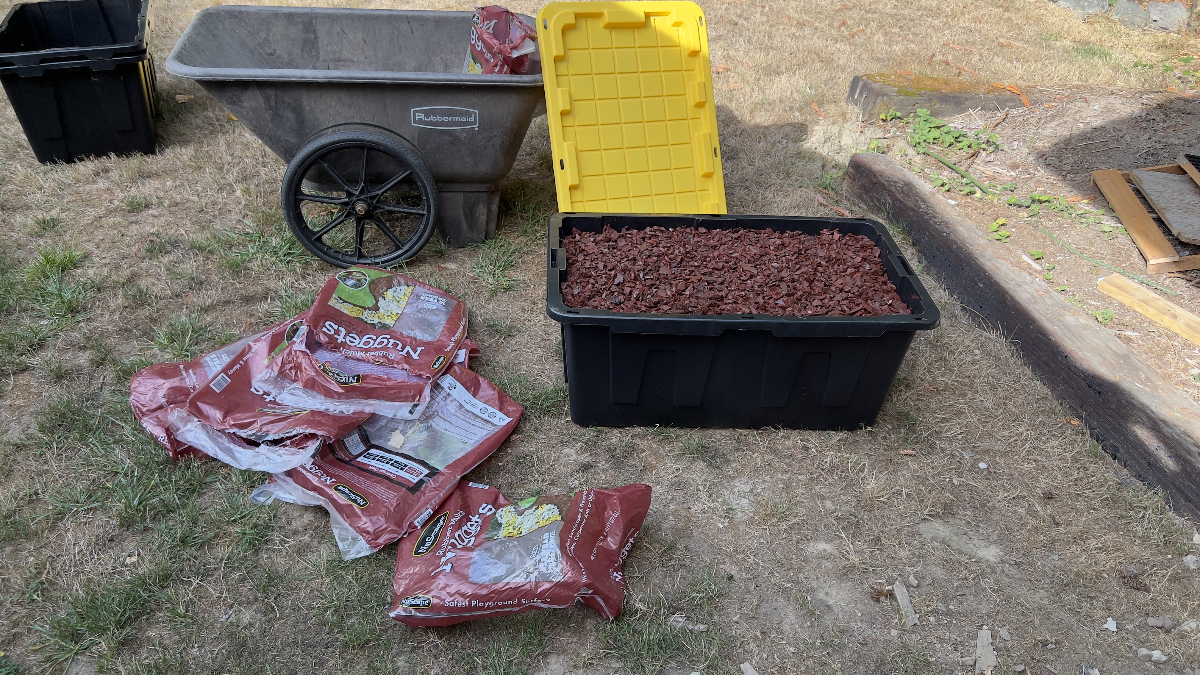

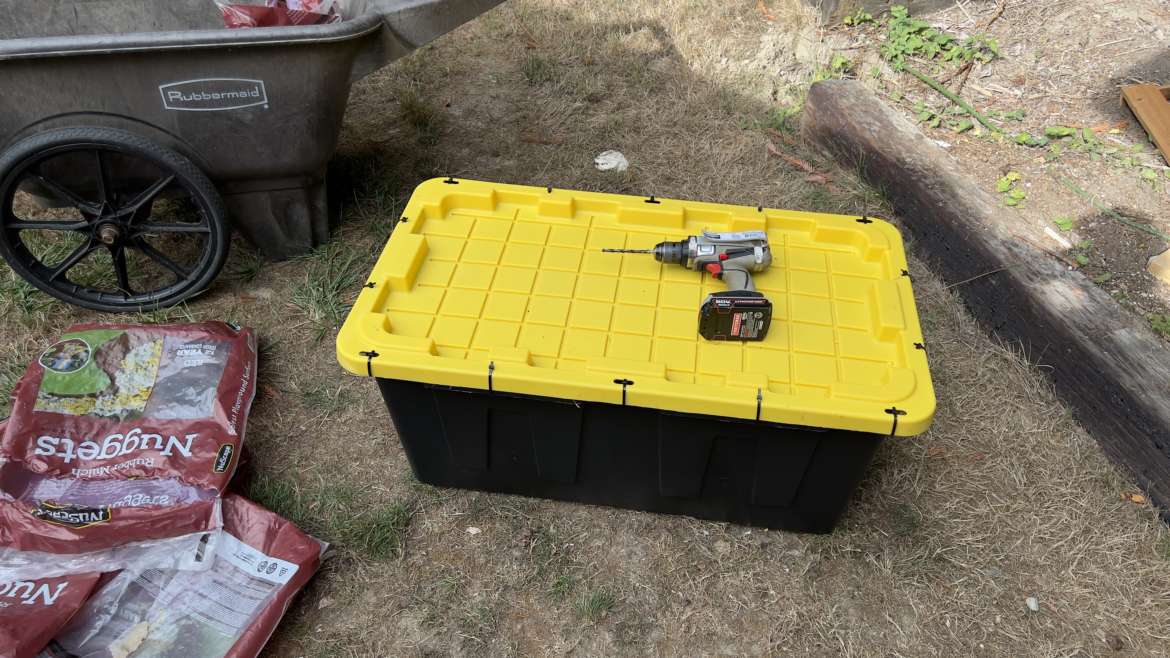

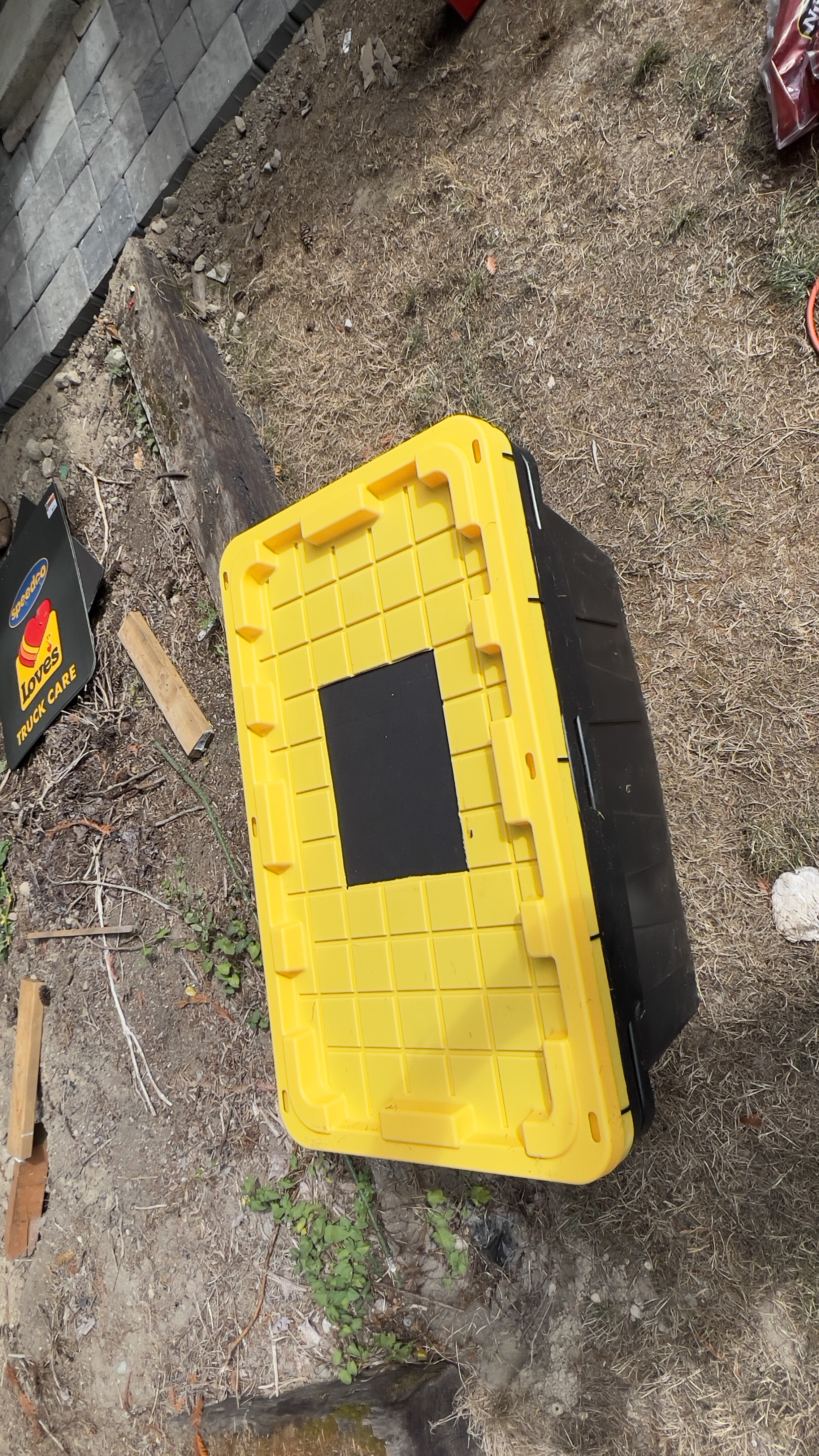

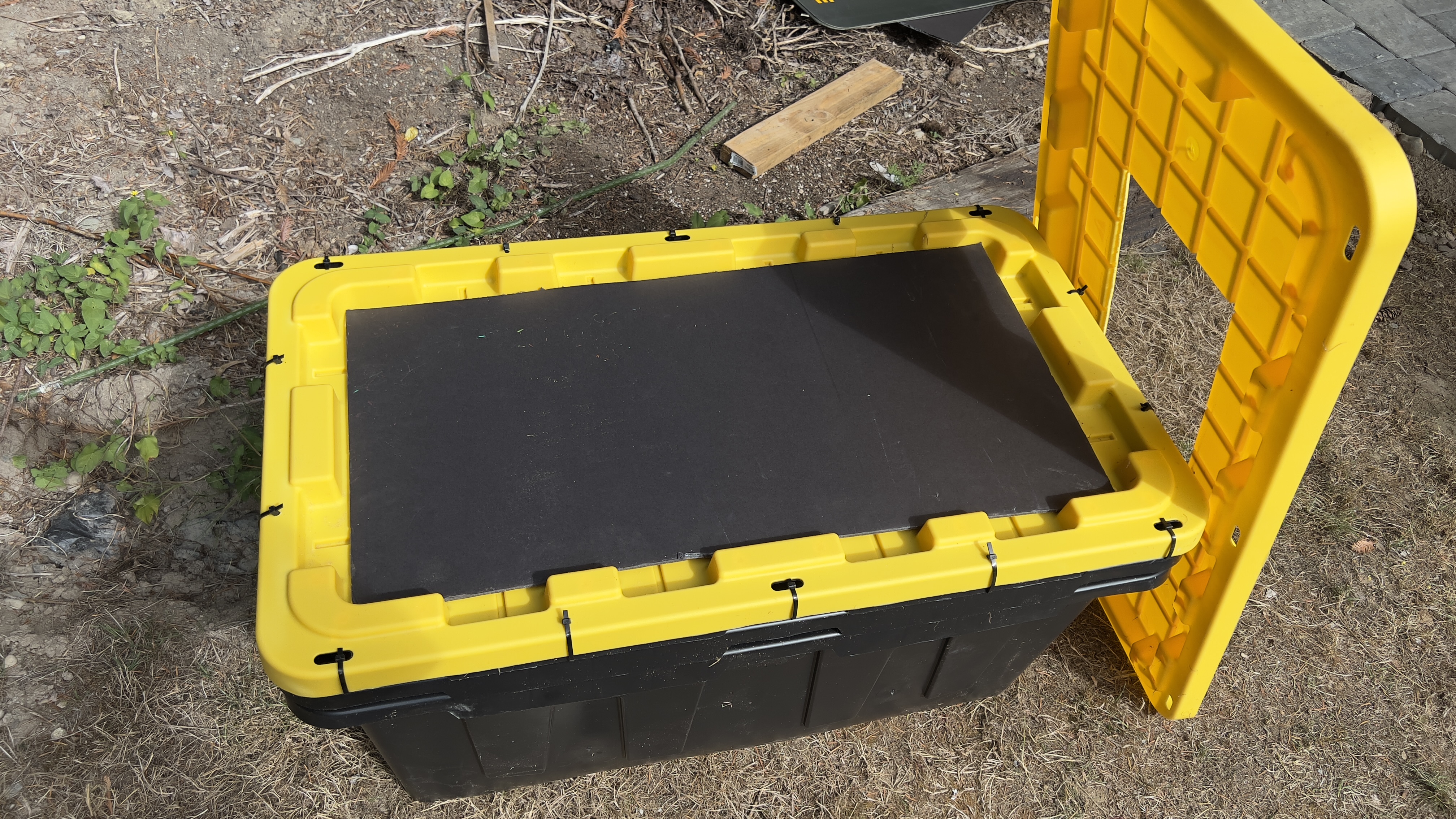

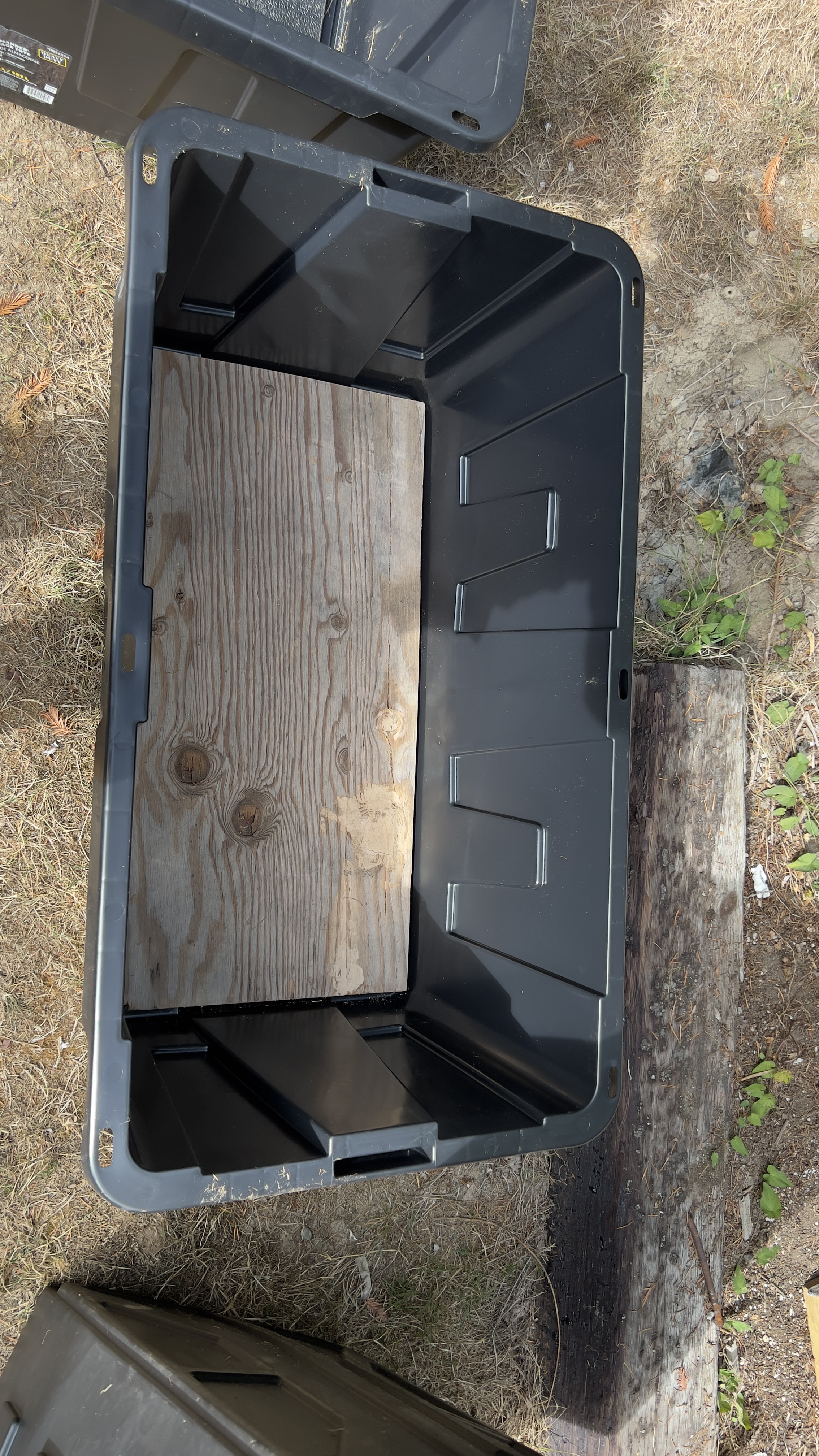

I used three bins. One to hold the mulch. One to hold a thick rubber mat. One to hold a sheet of 3/4” plywood. I could have used just one bin with all three items but the thing is so damn heavy one bin is not strong enough not to bulge and deflect. This rubber mulch is heavy! Plus with three bins I can take advantage of the three lids. One to contain the mulch. I decided to let the pellets decide over time what minimum openings are needed on this lid to minimize mulch escaping. One lid to retain cardboard to tack target to. One lid to use for storage to minimize impact from weather etc.
This beast took over 7 bags of mulch!

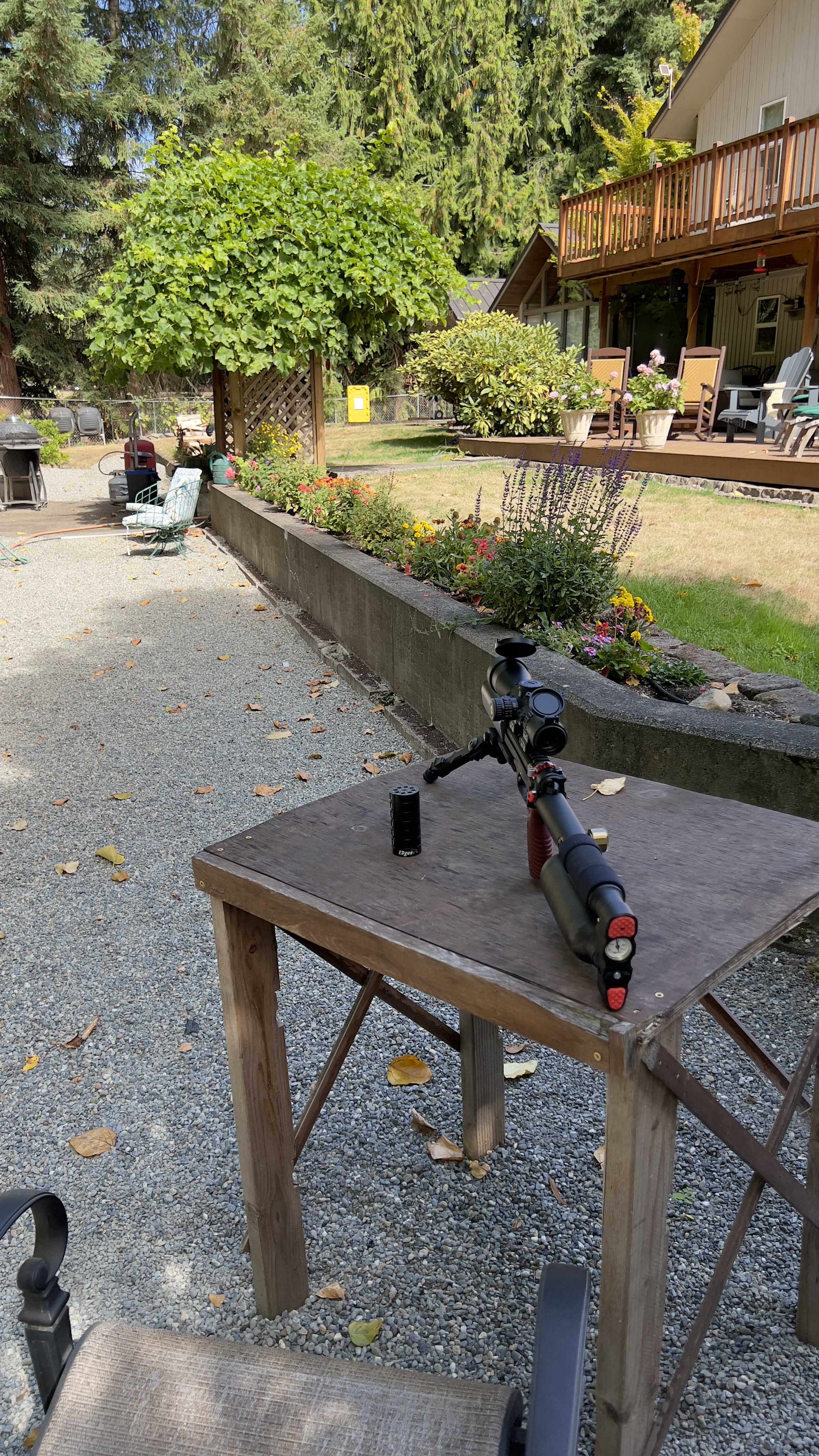

Side note: I am constantly amazed how respectfully accurate the short 250mm alfa barrel Is on my L2. Trigger is the only challange at 35 yards with this air rifle.

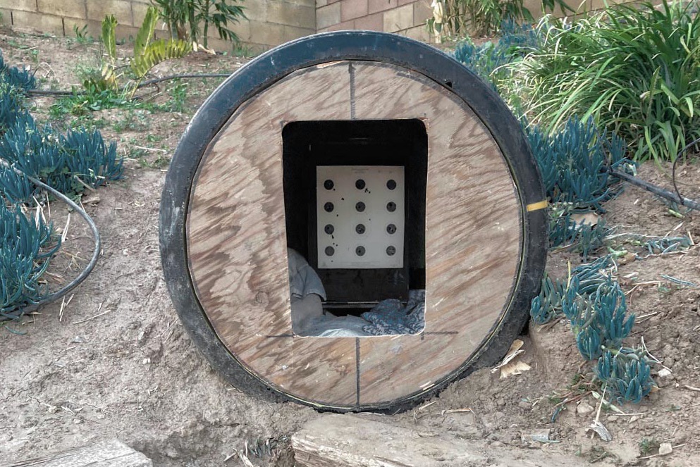

I use a big cardboard box filled with rags. Jeans and old coats work the best. Easy to staple and remove targets. When the box is shot up, I pull the rags out and dump the spent and reusable ammo back in the box. If steel slingshot ammo or bbs mixed in I use a magnet. I then dump the lead spent ammo in a bag for later salvaging and reuse the rags in a new box. Also I like it as a way to recycle boxes and clothes that do not make good rags.

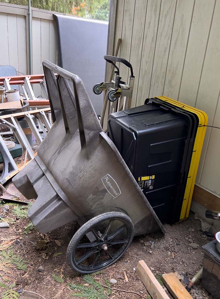

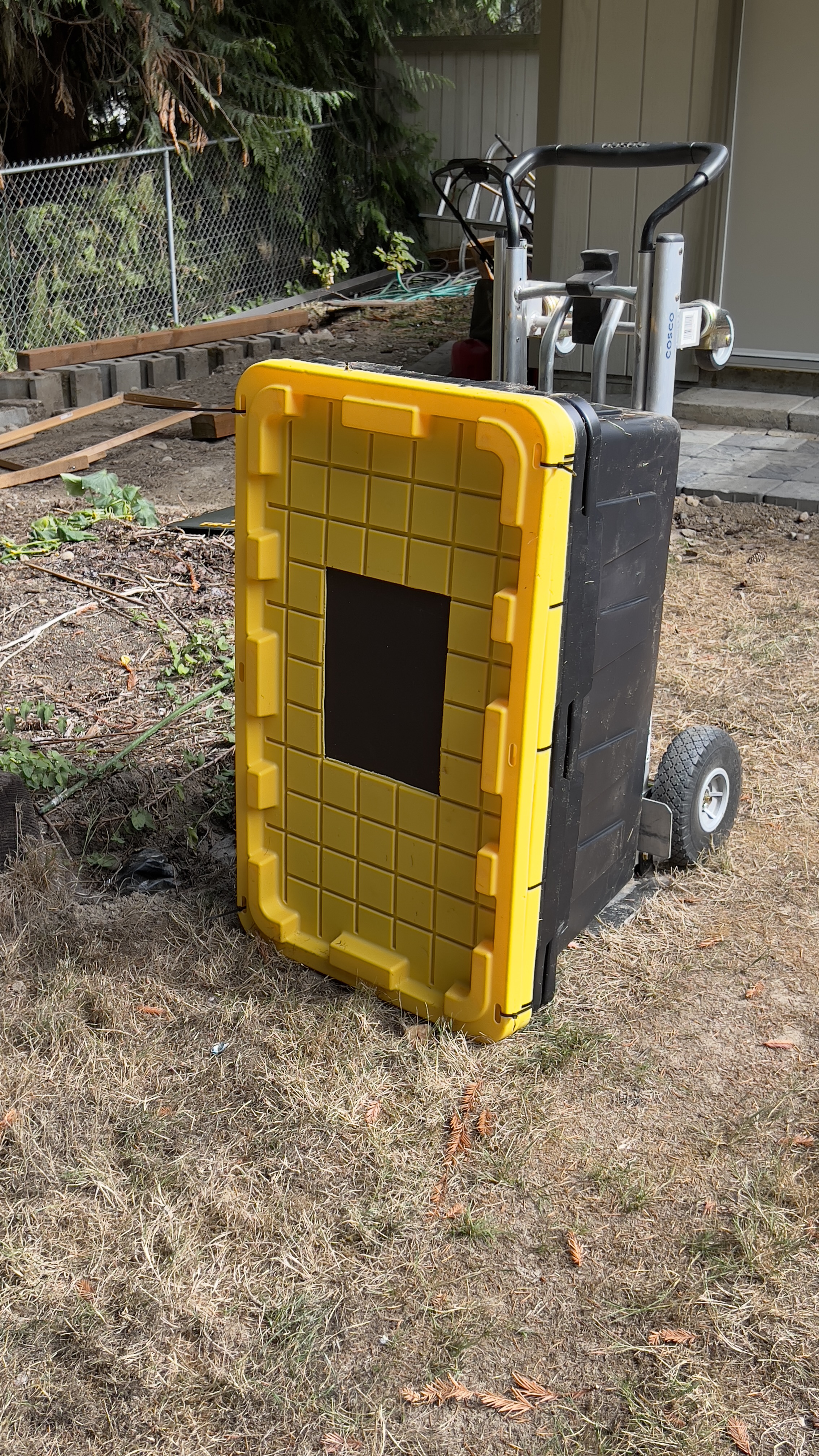

Dolly is pretty much mandatory to move it as this thing must weigh over 100lbs! I may have to make a smaller one to take on the road?

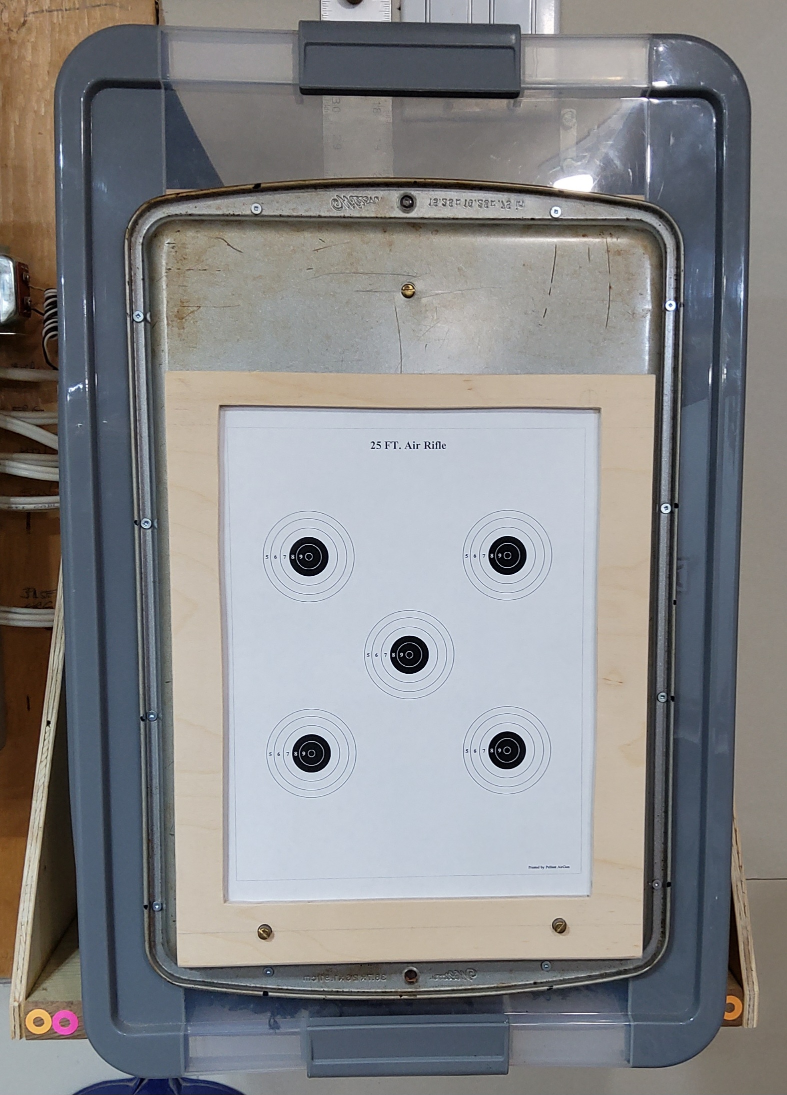

After reading/hearing about the rubber mulch traps I did some research and made one out of a tote and a cookie sheet. The backing cardboard takes a minute to change and a fresh target put inplace (held by a magnetic bezel) in a few seconds. It's much smaller than the one the OP shows but works well.
I did a detailed guest blog on how I made my trap and will provide a link here in case someone would like to check it out and make something similar.
where did you get the dolly? link?

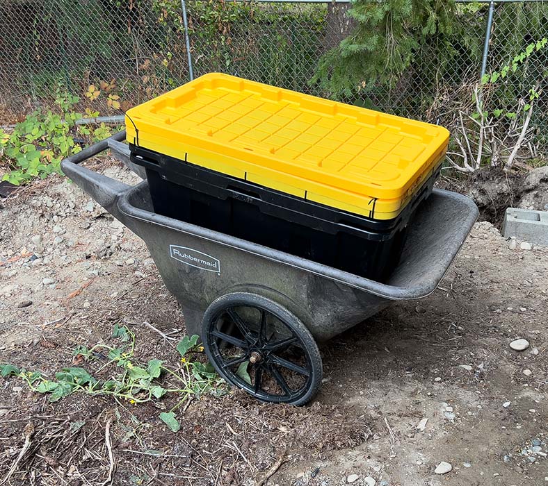

They sell these at Costco but I bought mine at a garage sell at 20% cost. It actually does not work well in my situation because of where I need to move the trap to and from. The ground is too uneven and soft so now I am using my Rubbermaid wheelbarrow which works much better for moving it from where I store it and where I use it.
They make a version of this bin that has wheels but it is even bigger and the wheels are too small for my application. Something to consider though. I may also fabricate a way to put some big wheels and handle directly on this beast. Did I tell you it is heavy?
