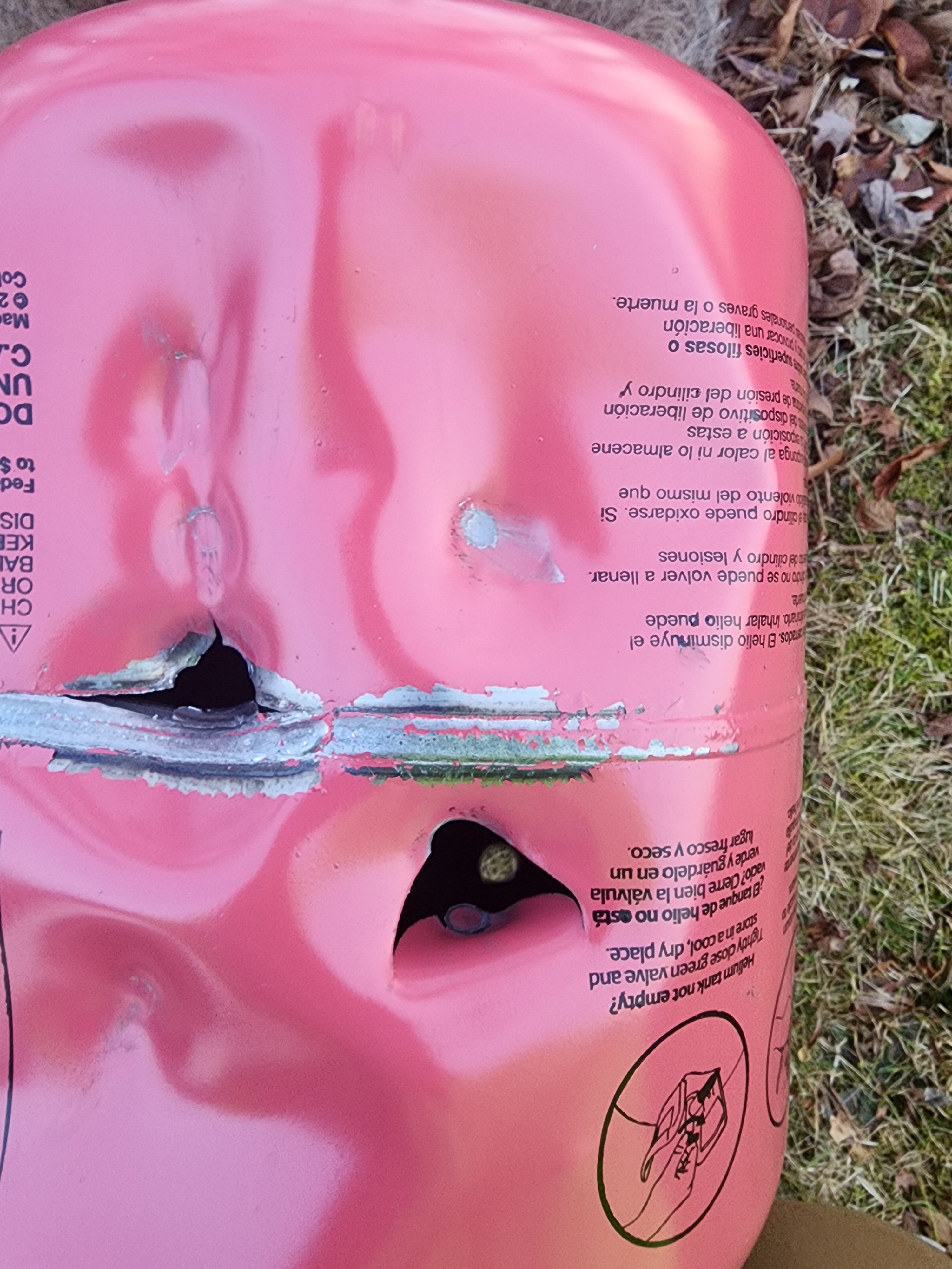

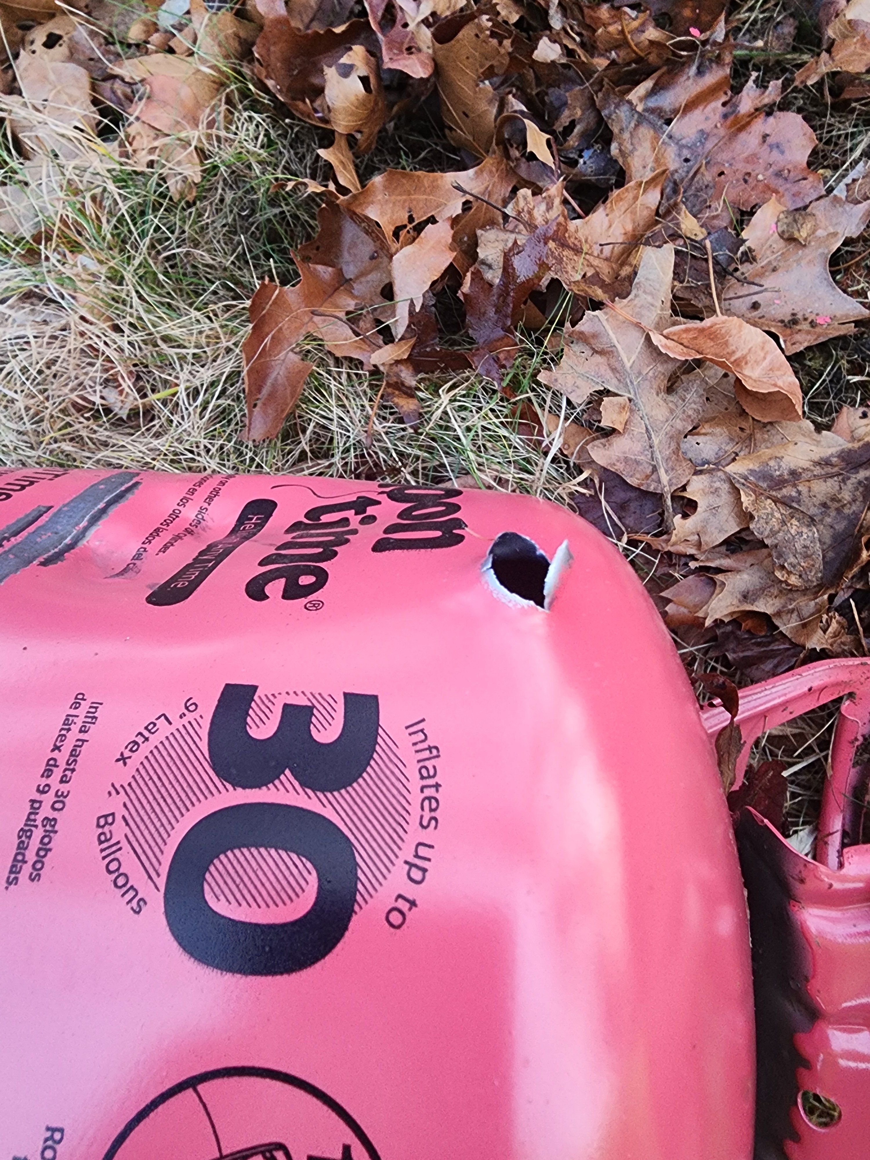

So anyone that owns this gun experience valve lock when charging to 4500 psi.
I filled to 4500 psi and shot at a propane tank only dented it the first shot.
The second shot went through wich is the one right at the weld of the tank maybe that's why I didn't get a clean pass through
On the third shot I got this..
The shot to the right below the weld clean pass through

This is common for unregulated guns. There is a curve with a peak at some pressure lower than the maximum fill pressure. A person who wanted to get more power out of those higher pressure fills would need to increase their hammer weight or pre-load on the hammer spring. Not saying you should do that, but when the tank is topped off the back pressure on the valve makes it harder for the hammer to knock it open.

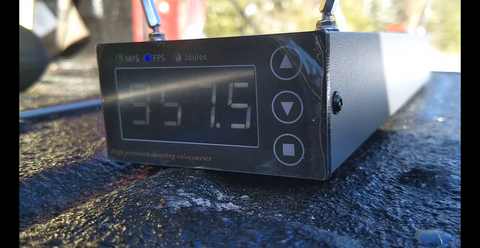

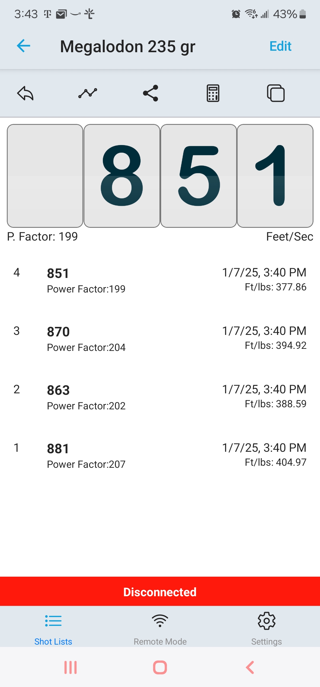

Yeah the megalodon is pushing with the 230 grain pills 470 fpe
I screwed up my calculations, it's got 610 FPE or 825 J :) I find it amazing the air gun has the ballistics and muzzle energy of a suppressed subsonic sniper rifle. And that you can get it shipped to your door.
957.5 FPS w/ 300 gr slug, at 4300 PSI.
