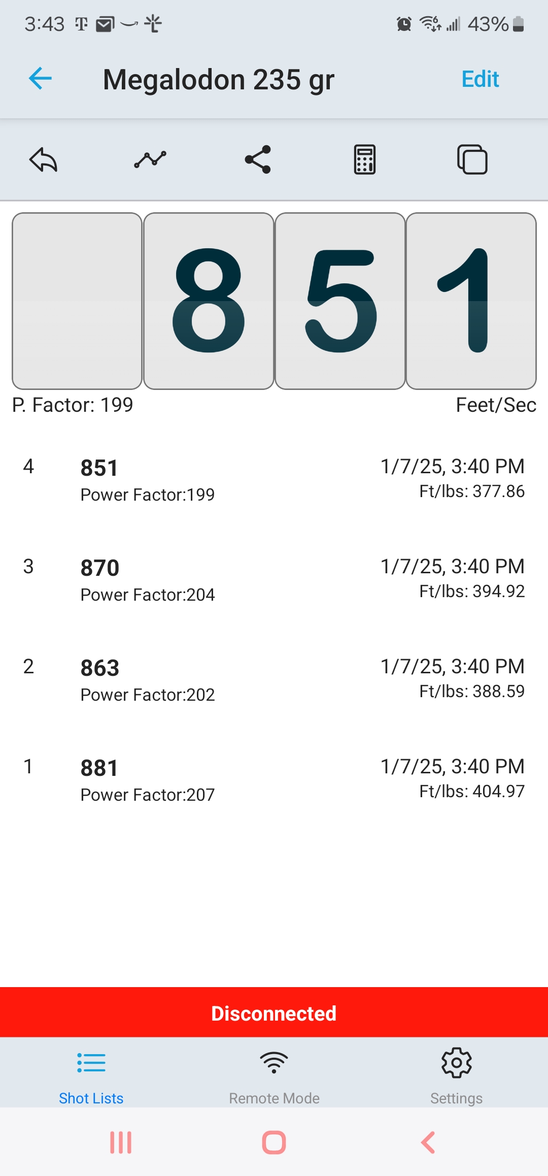

If i wanted to change the spring on the megalodon anyone done it? I don't know if it lost energy they advertised fps for the .50 cal 22 inch barrel is 930 fps here are my results...never did a chrony test when new i just got the chrony.
