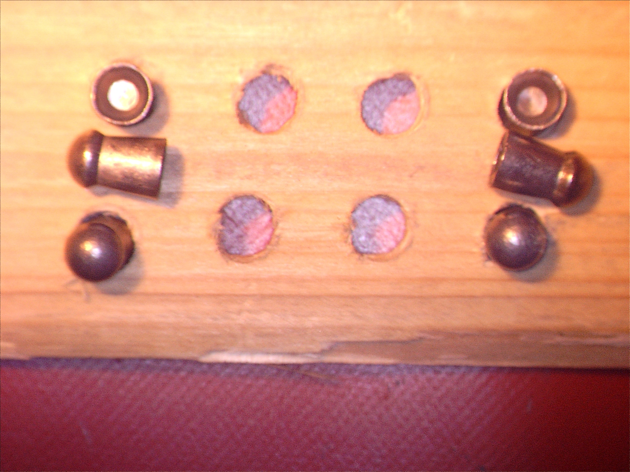

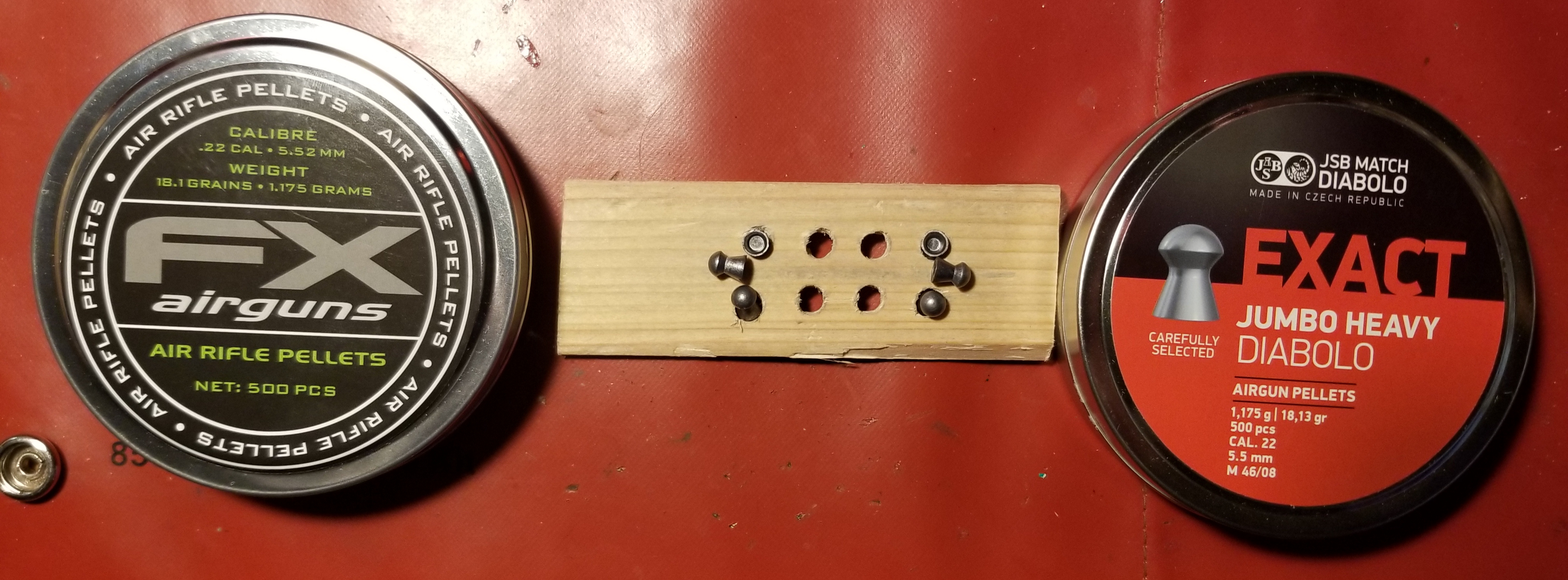

I happen to have at least a tin of each of each brand, so I happen to have FX 18.1gr on my desk, so I got the JSB equivalent. Here are a couple pictures of each
Here is a close up:
You can clearly see that the skirt is deeper on the JSB, so they are clearly different dies. I don't know what "nuance" was in the text of the letter from the OP, but the proof is in the pictures. I'll check more if, for some reason, someone doesn't believe these pictures.

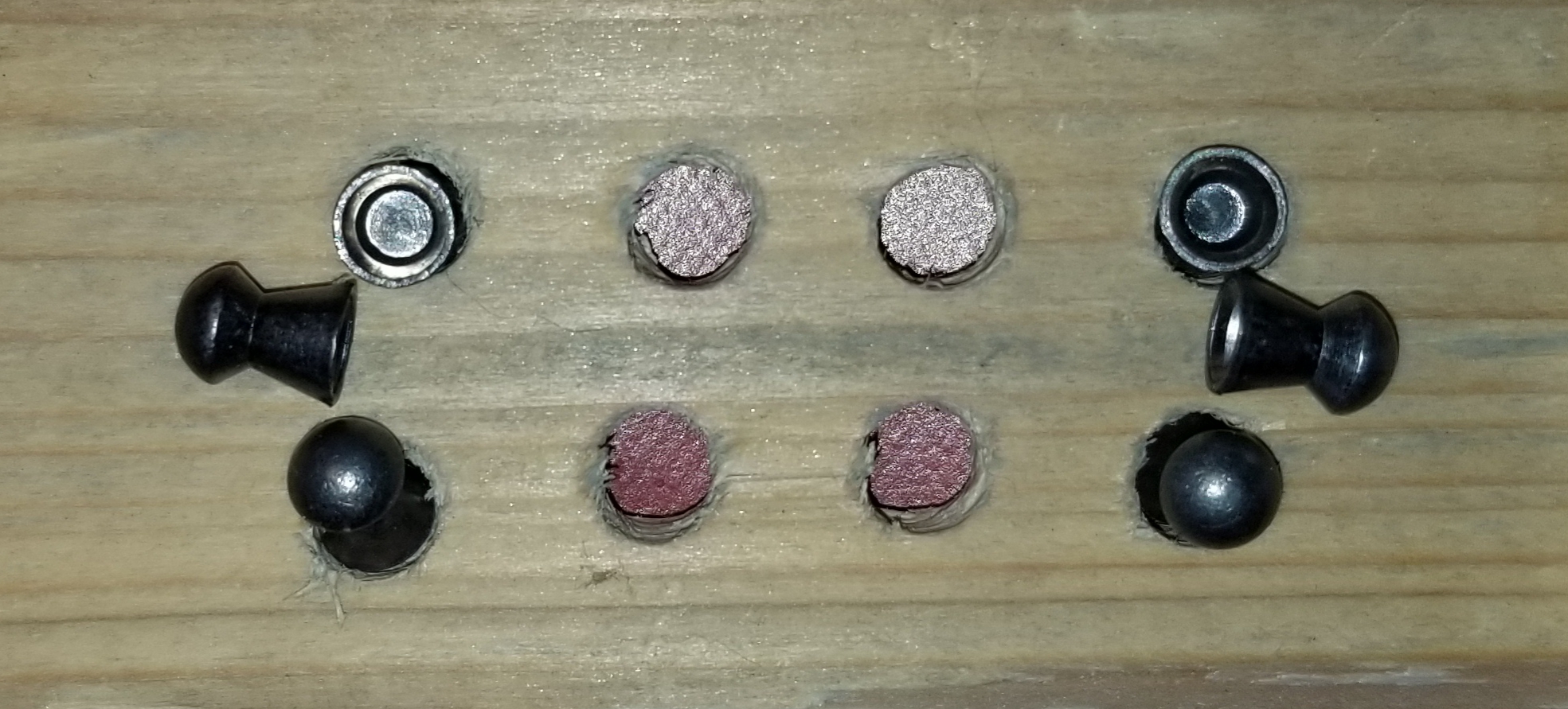

Can't really go by skirt dimensions. JSB changes the dies all the dang time. These are from two different tins of JSB .22 RS pellets, purchased a couple years apart. Both tins were JSB labeled.

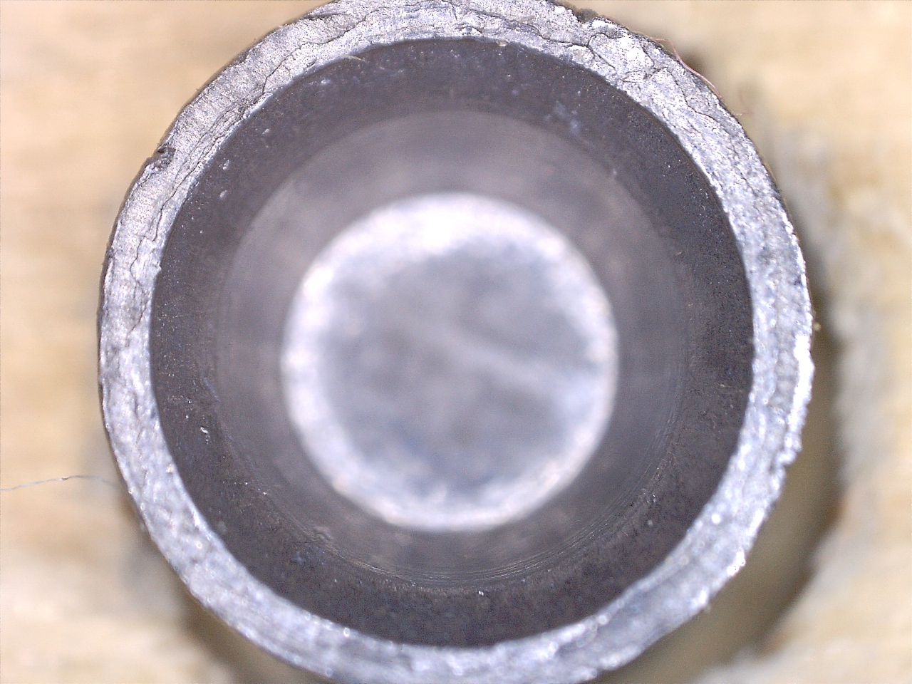

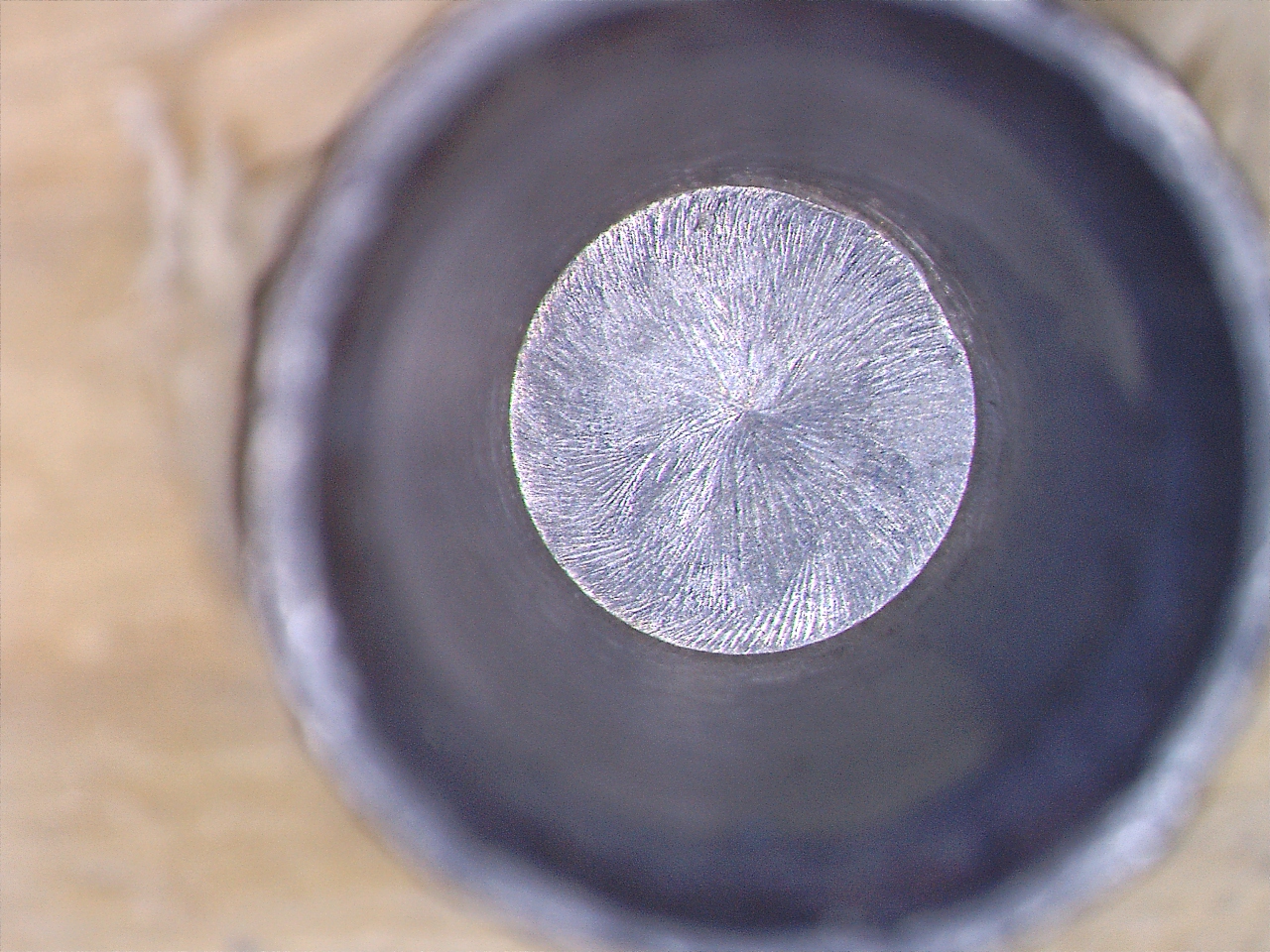

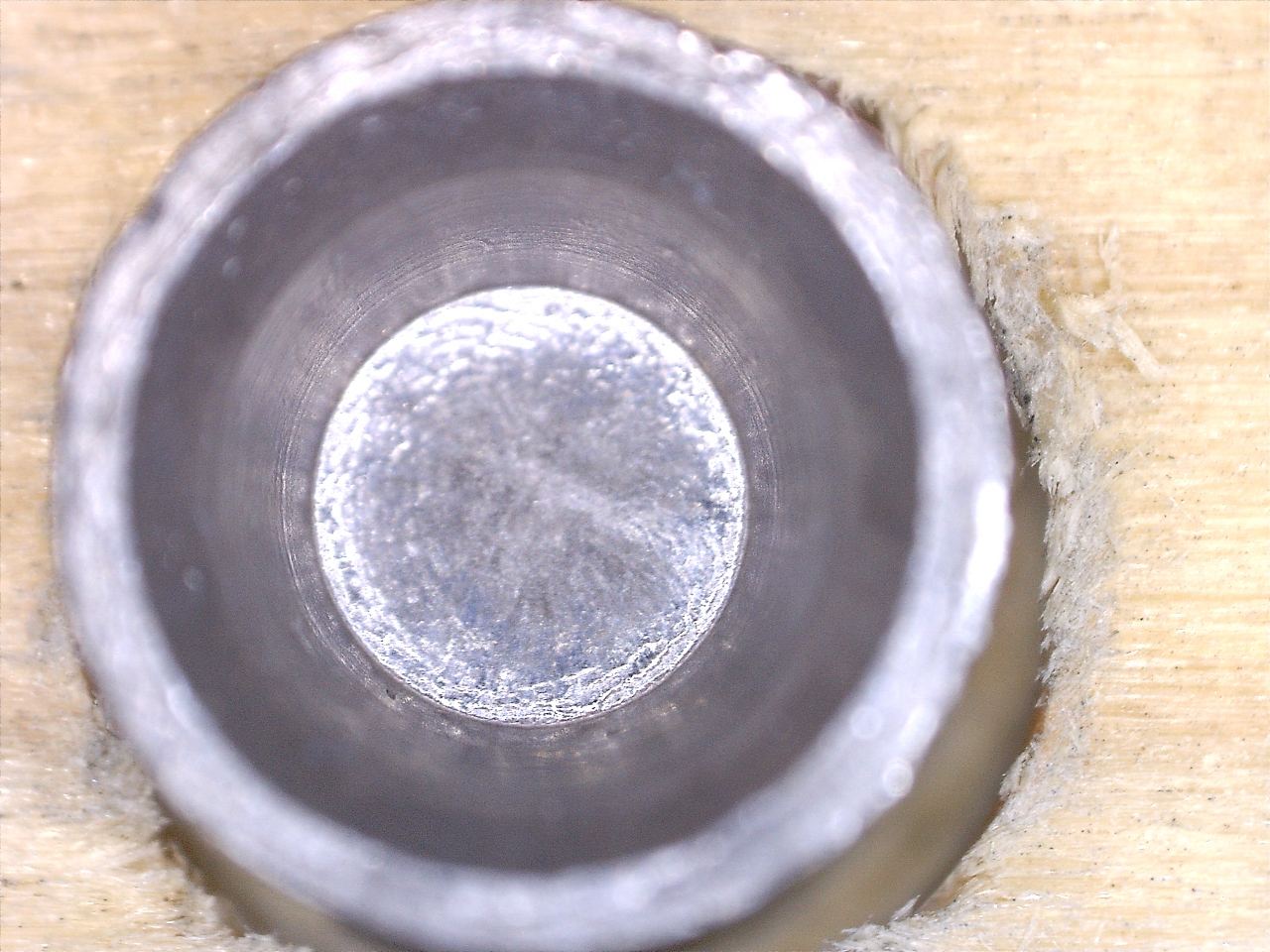

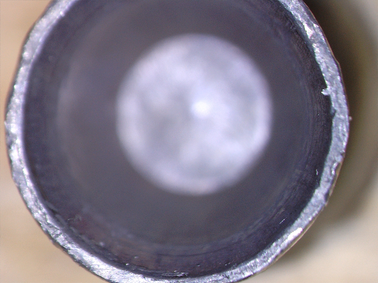

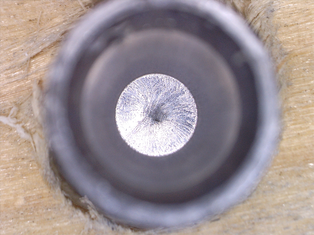

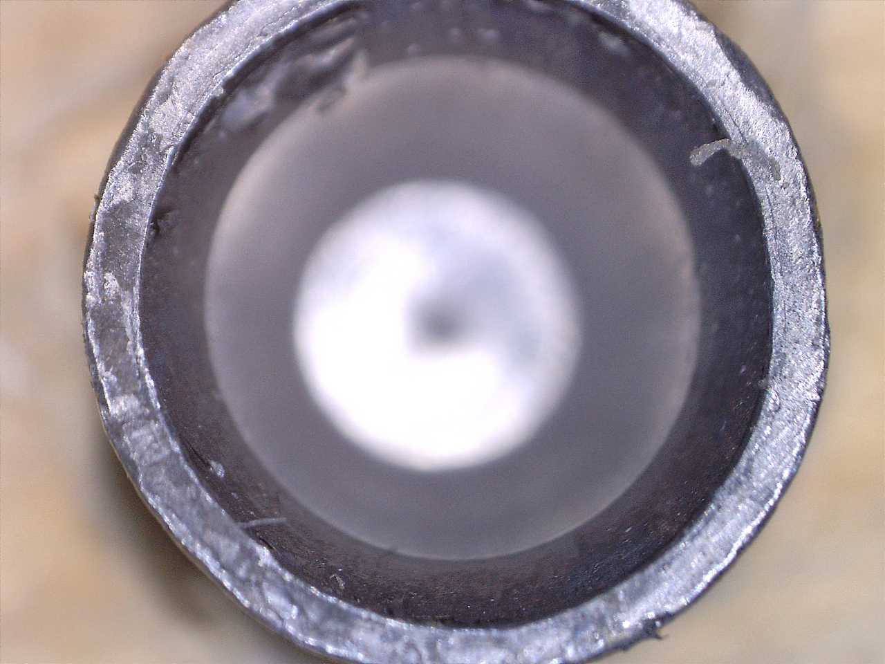

So I got my microscope out for this discussion. I took two pictures of each, one at the bottom of the skirt, and one of the skirt itself. Here are the FX pellets:

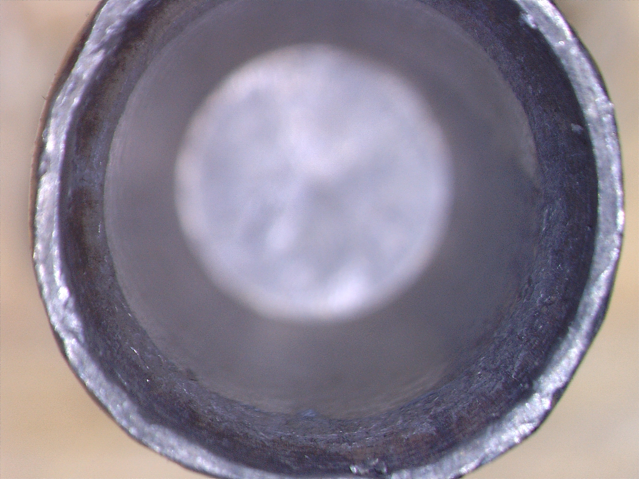

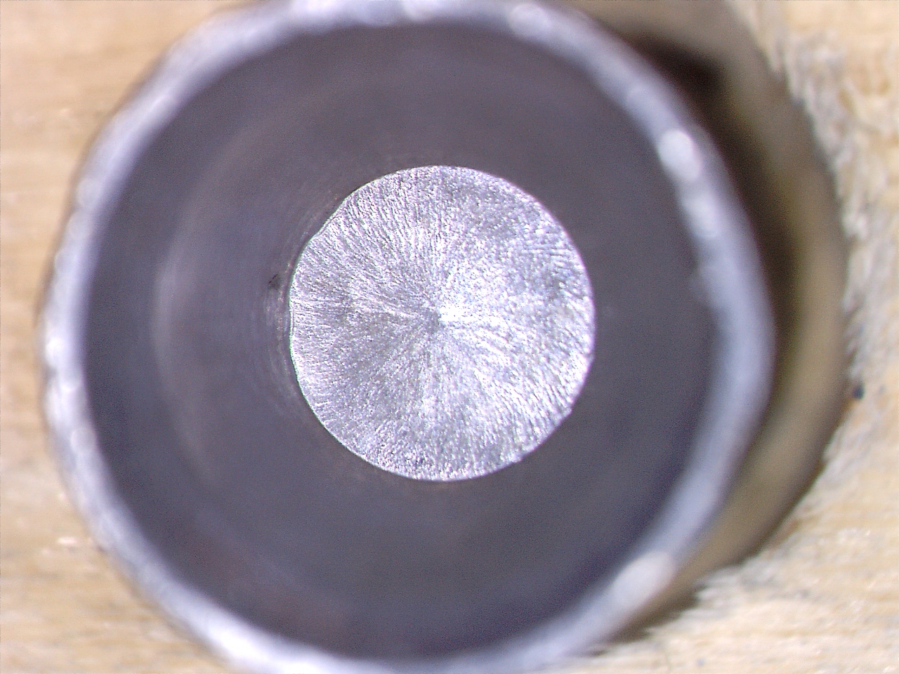

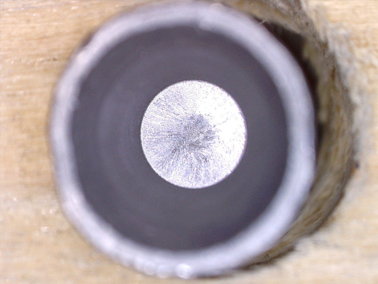

Here are the JSB, same order:
I still think that it is obvious the difference in the two. The JSB is deeper, so my point of focus is lower, and the size of the "flat spot" is smaller indicating that it is deeper in the head. You can even see "tooling marks" on the FX pellet that aren't as noticeable in the JSB.
I am really only bringing this up because I always painstakingly test all my barrels for what pellet it likes, and I have one that clearly prefers the FX over the JSB in the same weight. I shoot sub 1/2" at 50 Yards with the FX, and can do good to get below an inch with JSB with all other things being equal. The BC of the FX is higher than the JSB. I just don't see how it is possible that these are cast from the same die.

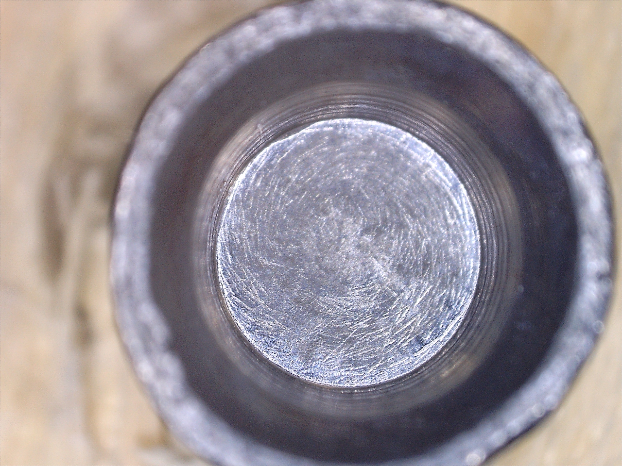

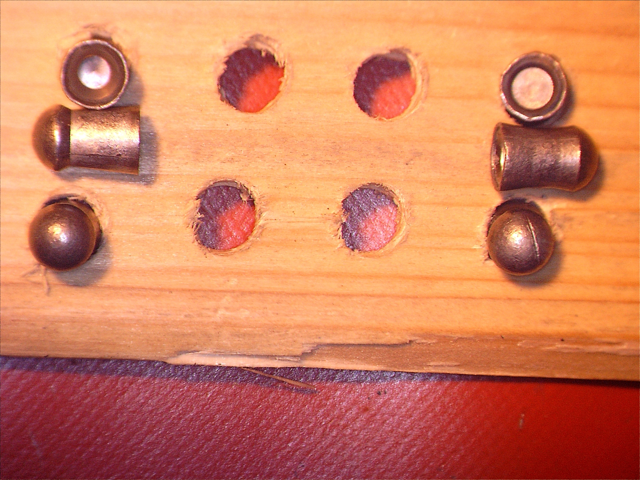

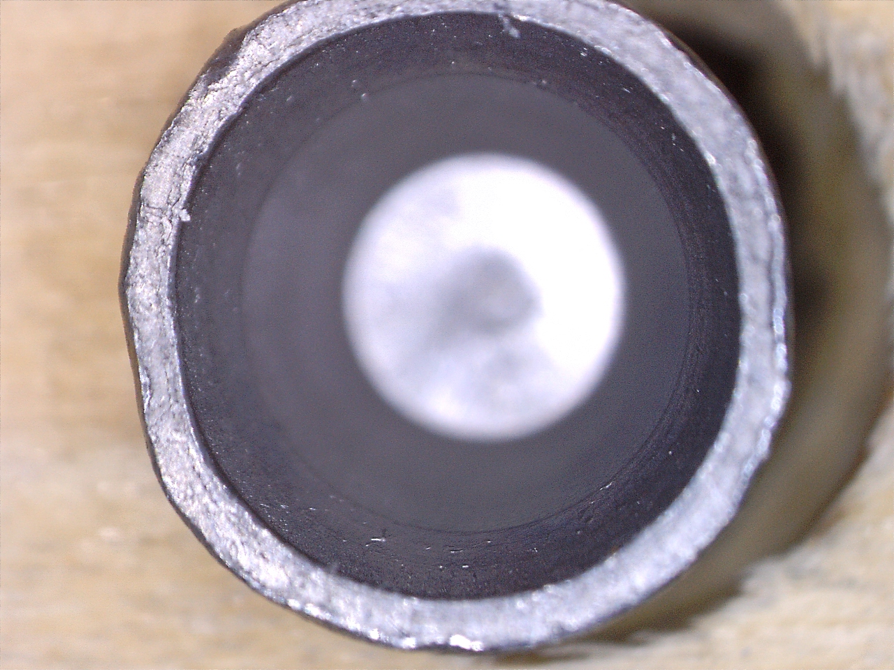

In the name of "fun" I tested a few more under the microscope. Here are the 15.89gr (Same story, FX on the left and JSB on the right):
Here is the FX:
Here is the JSB:

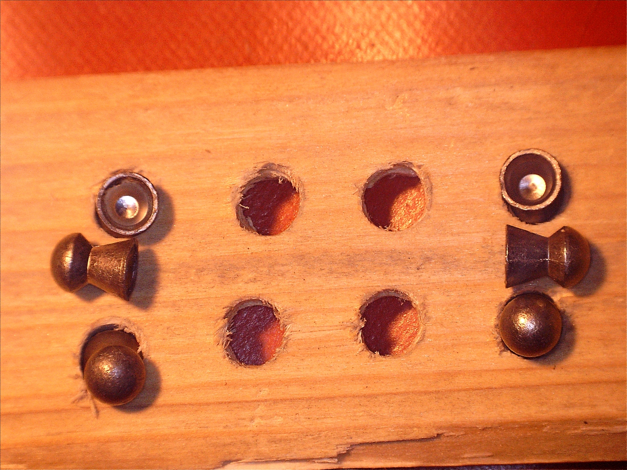

Obviously, the FX 25.4gr pellets are meant to copy the Monster Redesigned. Here is the regular JSB Monster:

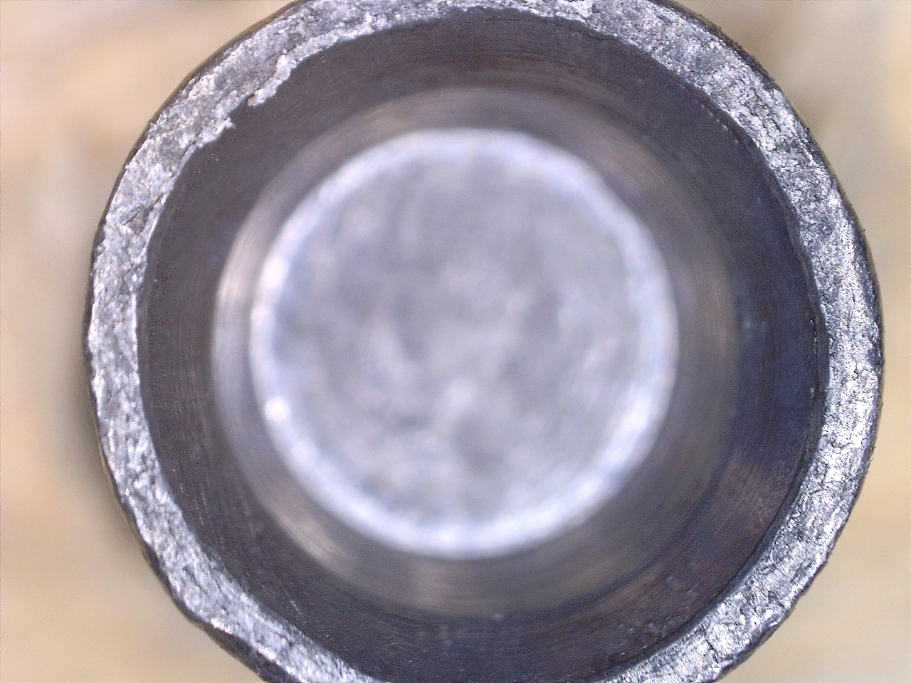

So I went back to the pellet shelf and found the Redesigned. Here they are:
Here is a close up of the FX pellets
Here are the 24.39gr Redesigned JSB pellets
These look similar enough that I may have to concede about the difference that I saw in the 18.1gr pellets. Obviously they were made from a different die, but perhaps there is so little QC when making the dies that you can have an insane variance like this. I have never dealt with tolerances like this, so I am obviously jaded. During one of AEACs interviews with Lauren Parsons, she said that when she finds that there is a pellet that her gun likes, she will buy as many sleeves of that batch as possible. I now understand the logic in that.
