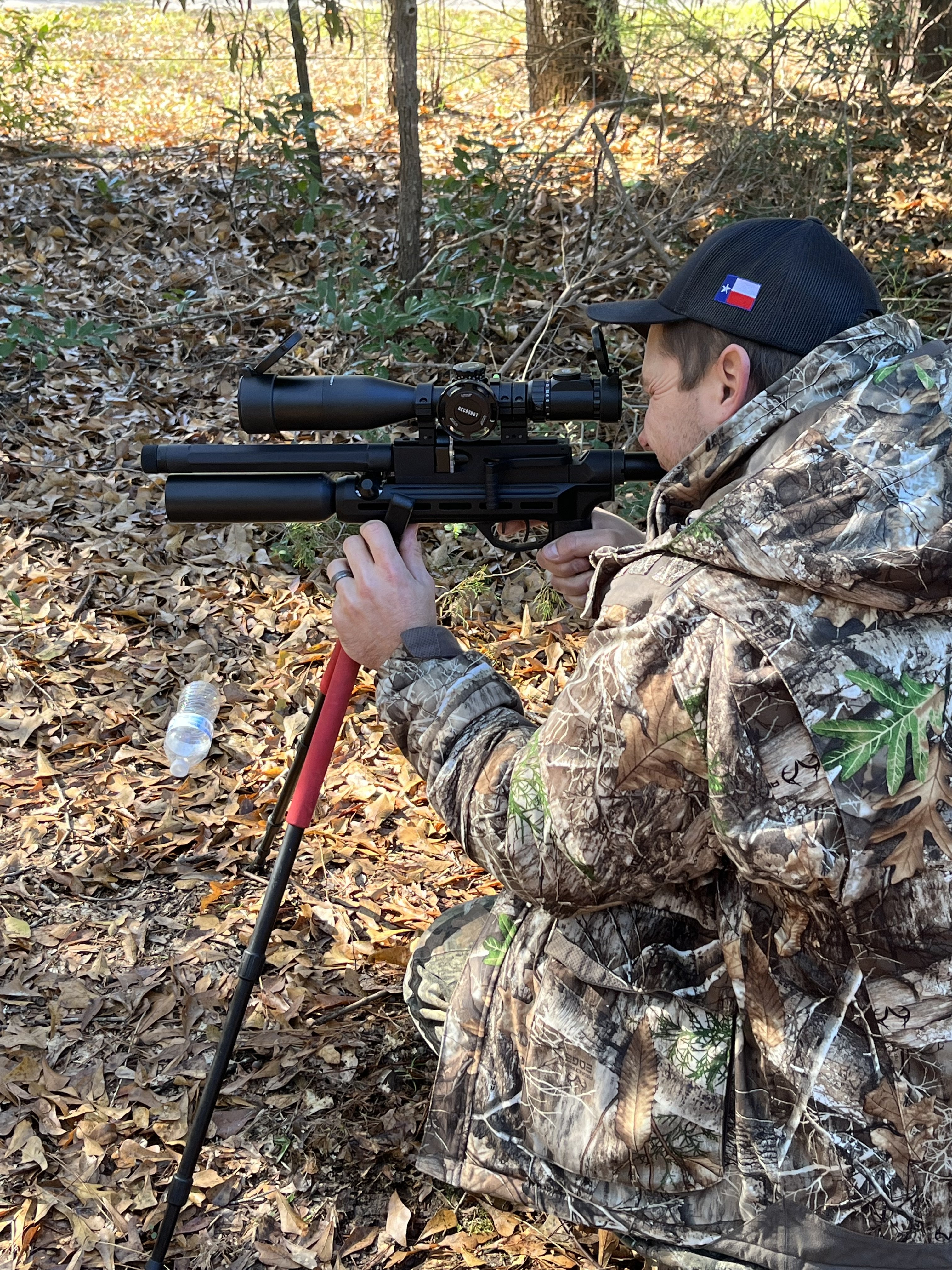

I have one in .177. Mine is left hand. I like it. I have not shot it a lot. My shooting time right now is getting a new FT rifle set up. That said it shoots good and fun. I had mine turned down to 12 fpe. My use for the rifle is more for backyard plinking and the occasional nuisance squirrel. Turning it down doubles the shot count. Second picture is a buddy of mine shooting it at deer camp. Kind of shows you how small it is. If you want a small, compact, hunting rifle you can carry all day this is it. For what ever reason I can shoot it really well offhand.
Your buddy shooting really shows the small size of that sweet little gun… 🙏
That’s why I added that picture. Kind of puts it in prospective. I do need to move the scope back as that one doesn’t have enough eye relief as it sits in the picture so you have to extend your neck out there to get the site picture.

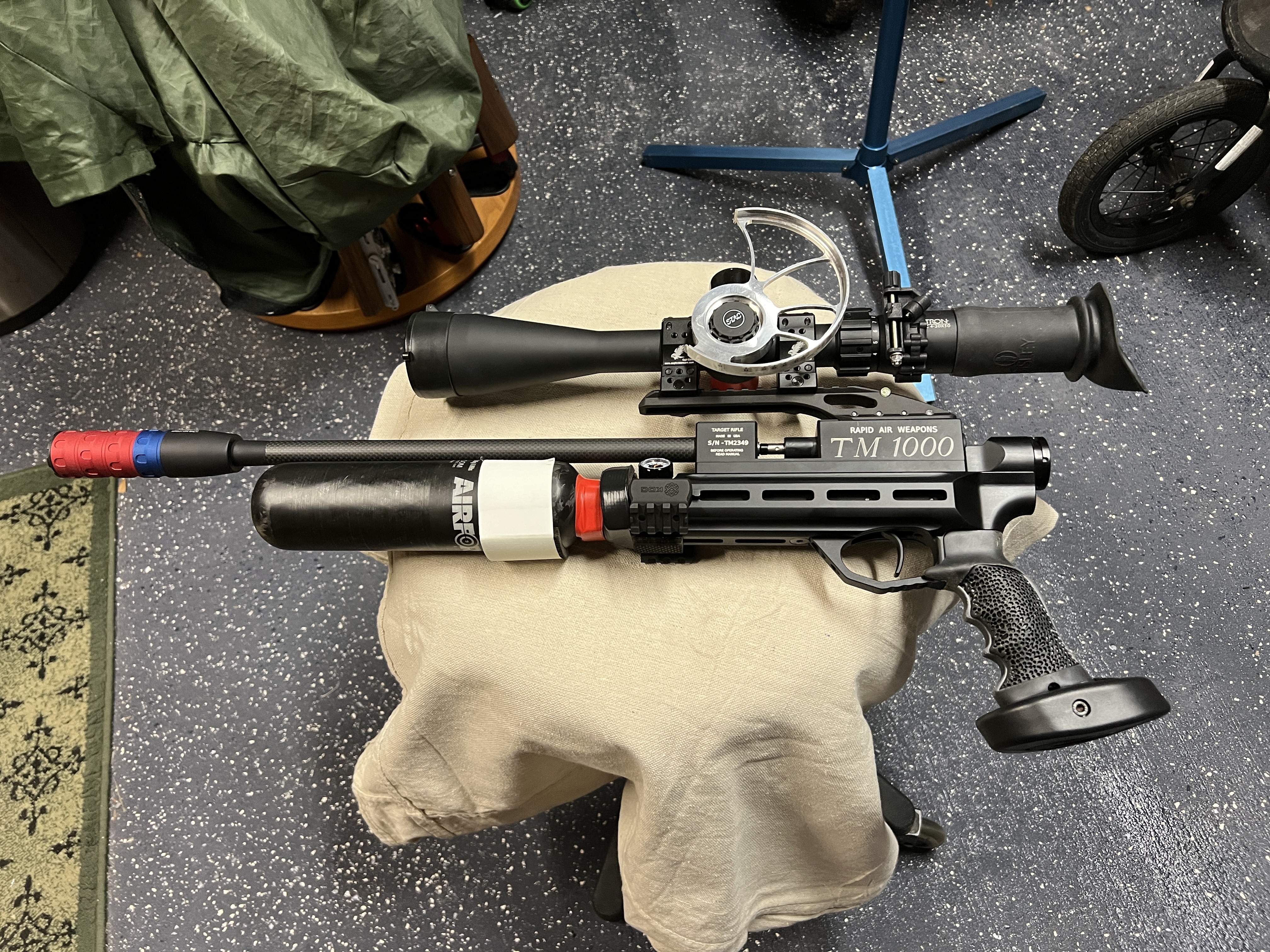

I have the TM1000 version in .20. I’ve considered putting a stock on it for when I’m not shooting HFT. As rigged mine weighs a tad over 8 lbs. easy to shoot offhand using the taco method. The moderator allows me to train in the back yard.

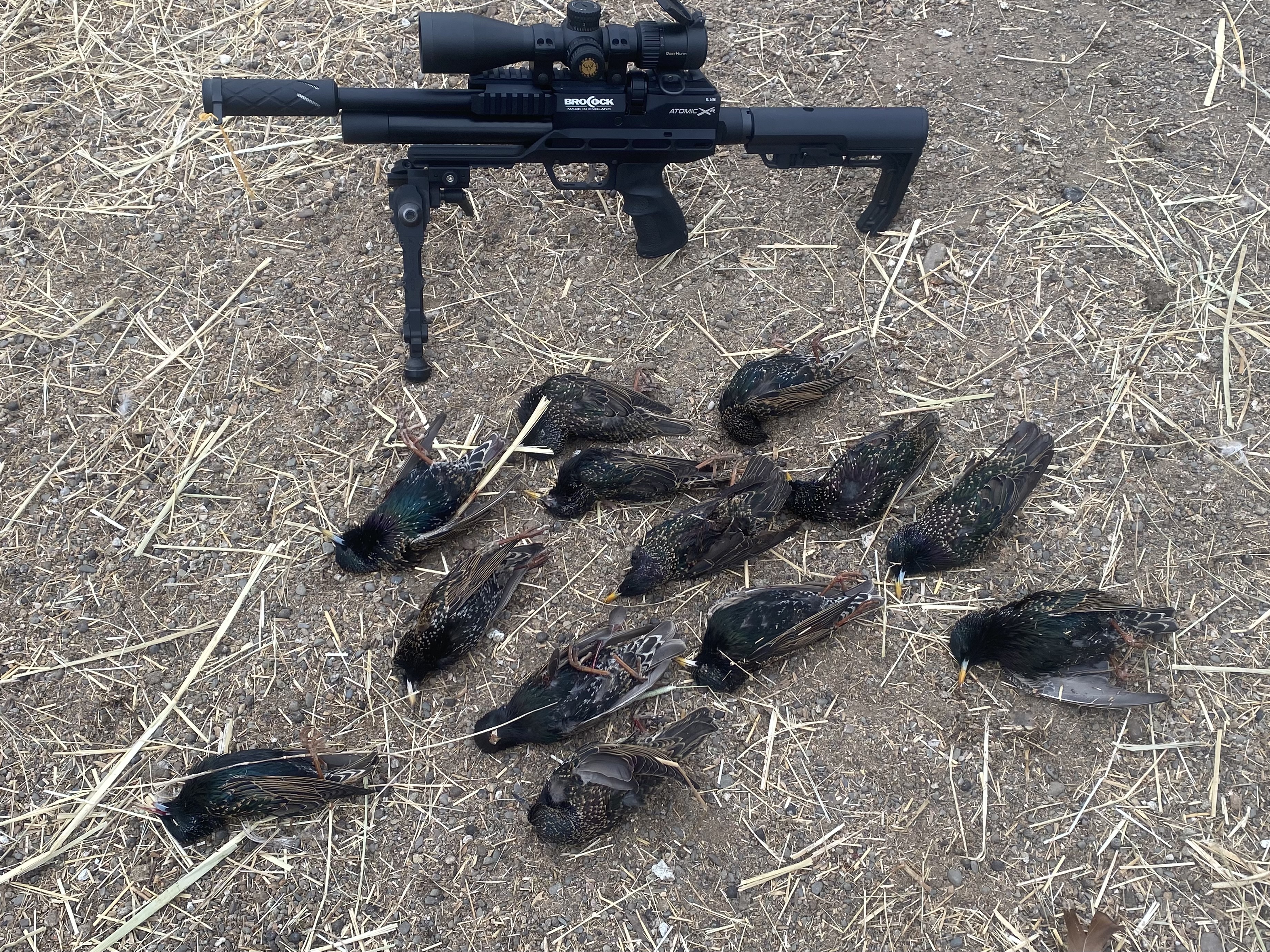

The little guns, at supposed low power, 12 FPE, punch way above those numbers in “real world” useage, a good shooter sending… In America we are lucky to be able to own and shoot 30 FPE+ airguns. I discovered that the lower in power I went, the more opportunities presented themselves. The small critters targeted? Find the low power simply irresistible…
