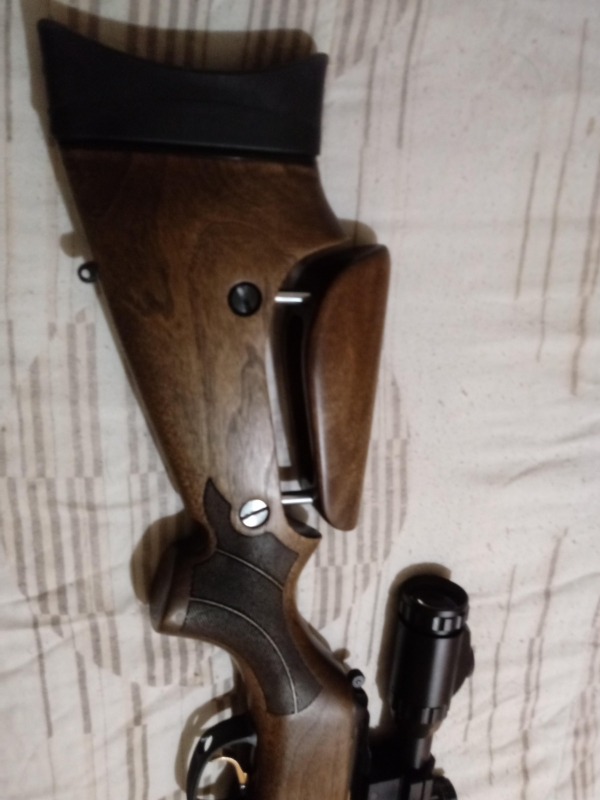

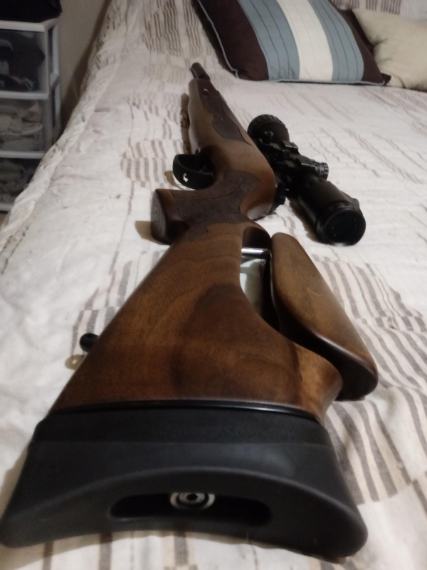

A few pics. I refinished it with Minwax dark walnut stain followed with 5 coats of Minwax Antique Oil.
Thanks Matt! I'm right up in the Midland area on the outskirts of town. I was having so much fun shooting that walleye fishing out on Saginaw Bay (Which I do a Lot) didn't even cross my mind! It was a big sloppy mess anyway,so we said screw it. Really impressed with this big Hatsan! I was apprehensive about buying it at 1st,but i love to tinker and after watching Steve's review on AEAC about the 135 .30 more times than I care to admit (It's All His Fault!)...I picked one up. These rifles Really respond well to a little "TLC"! Since I had it totally disassembled, I decided to remove the original somewhat fragile stock finish and apply my own. Really made the Turkish walnut look nice,at least to me. I gotta say, every time I hear Rick Eustler or anyone else say "Turkish Walnut", I think of Riccardo Montabalm trying to pitch "Fine Corinthian Leather" on the old Chrysler Cordoba. Thanks Again and take care!
