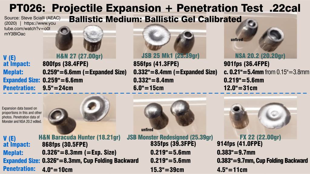

🔹dizzums,
tests seem to show that impact velocities above 800fps strongly favor HP expansion.
🔹bigbuck
sorry that I only have collected .22cal data.
However, I would assume that expansion increases with larger calibers exponentially — as more tissue has to either get out of the way of the projectile — or gets slammed into the HP cup, making it expand more....
Matthias 😊
PS: I have several dozen of these expansion tests graphically summarized like the one posted here.

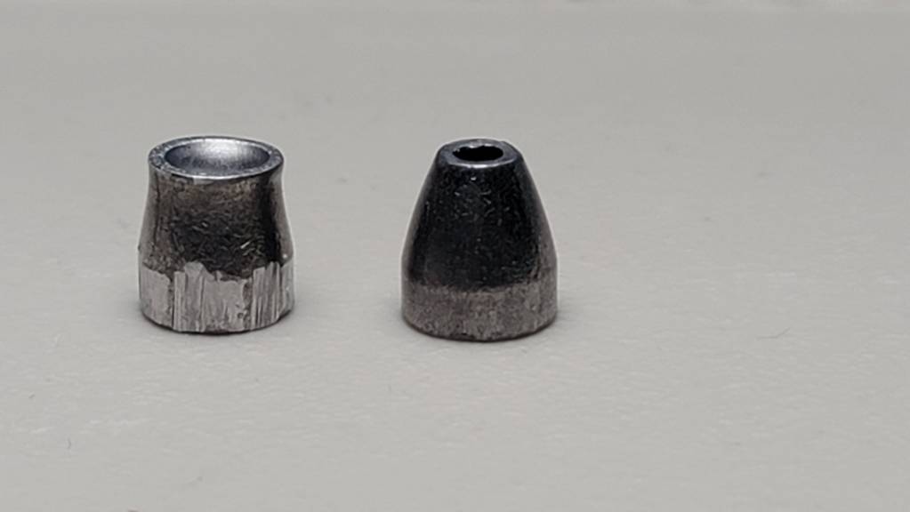

I have just completed a ton of testing using Clear Ballistics Gel with my Benjamin Bulldog .357. With NSA 110gr, I could not get expansion at 850fps, and the expansion was minimal at 950 with the 79gr slugs. I believe this is due to the thicker sidewalls on the ammo. When shooting the 142gr NSA slugs at 750fps, I got much better expansion, as those slugs have a much thinner sidewall than the 79 and 110gr slugs do.
The 79gr was almost a full pass through at 10 yards, while the 110gr and 142gr zipped right through the entire 16 inch gel block. I'll have a video ready to post on Friday.

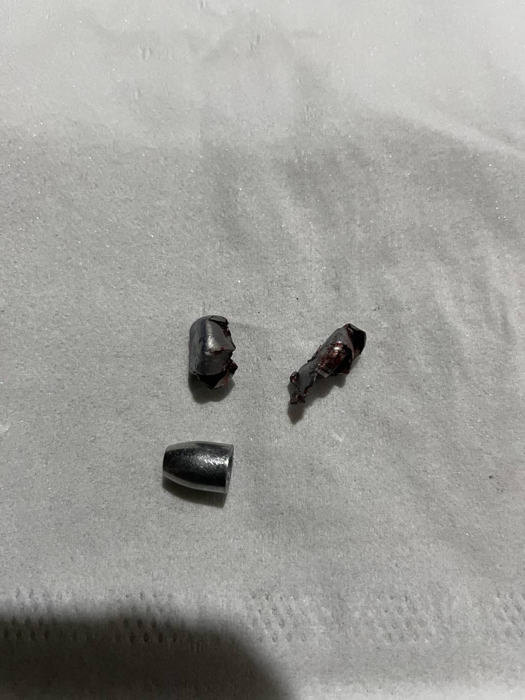

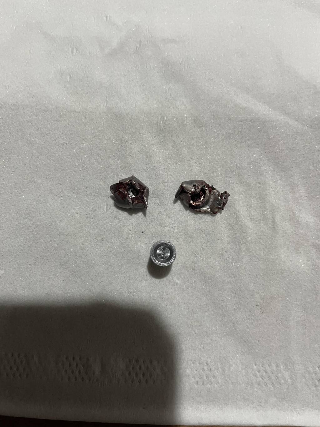

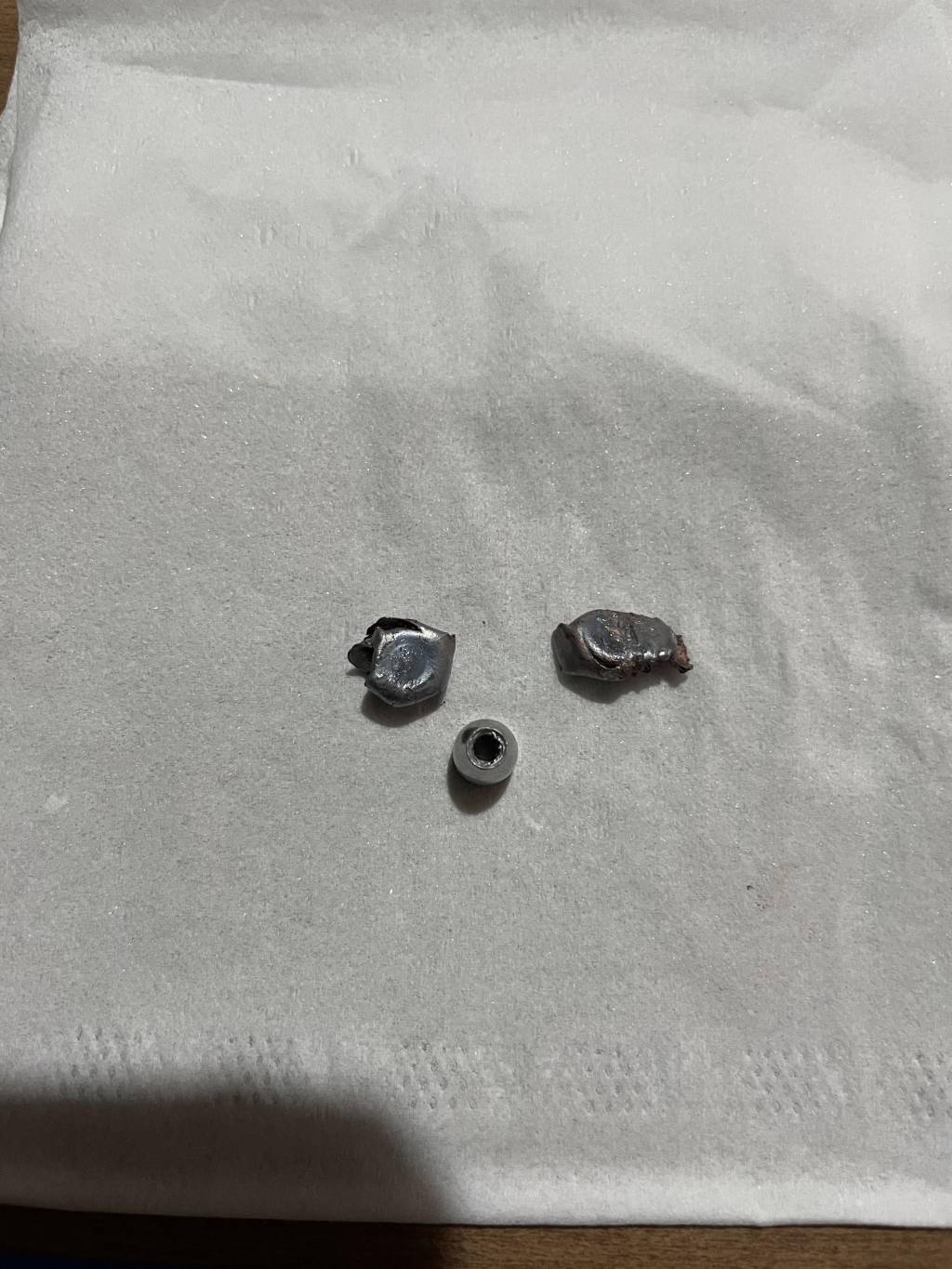

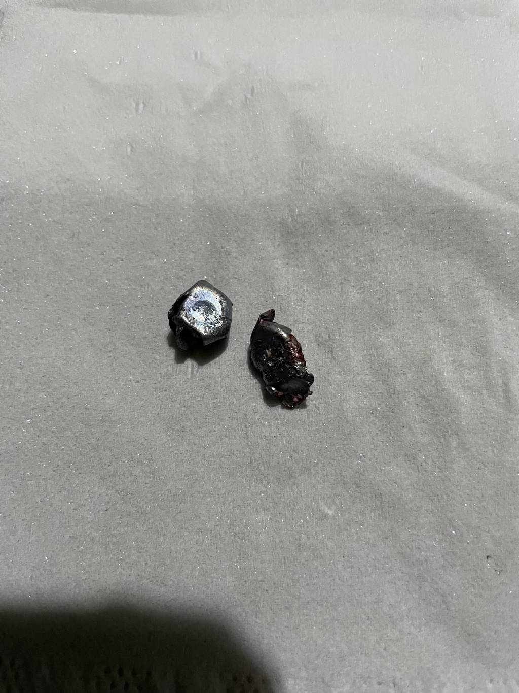

I also disagree with needing extreme speed for slug expansion. Here’s a few pics of a couple .25 fx hybrids recovered from squirrel noggins. Leaving the muzzle at 990 fps from my cricket ll
IIt all depends on the design of the slug and the hardness of the lead alloy. My test findings only apply to NSA .357 cal slugs. I just got some .30 cal FX Hybrid Slugs in and I'll test them next week with my Argus.

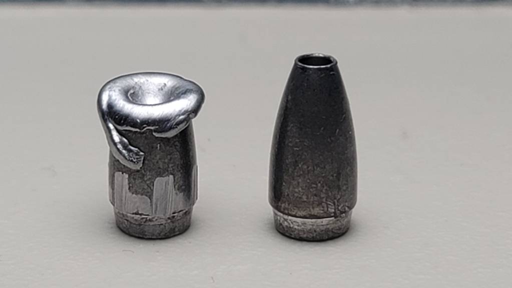

I shot the griffin slugs today in my 30 cal, they have some awesome ammo. The LDC slug uses a smal ball to aid expansion. The 50gr flat base LDC slug shot the best out of AGT Uragon. Hot 836 fps (Upper right) I just ordered a new M3 so I’m excited to see if it likes any of his LDC in .35

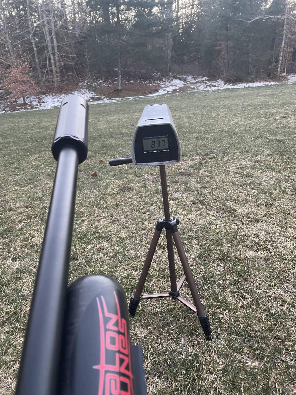

I have an FX impact MK2 in .357
I’m currently hunting coyotes with it but have considered traveling to another state near me to hunt deer next season.
I switched to griffen slugs as I found the 93 gr NSA were never expanding on coyotes on body shots. (Recovered a few) Grifffens are def softer.
What’s the minimum fps for reliable expansion?
I don’t have any ballistic gel, was going to try some water bottles to see.
currently getting 837 fps with an 88 gr flat based HP. I am going to send it in to have the current power plenum installed to hopefully get that fps up some more for better expansion. View attachment 190985

🔹dizzums,
🔹bigbuck,
Matthias 😊
At View attachment 191065
