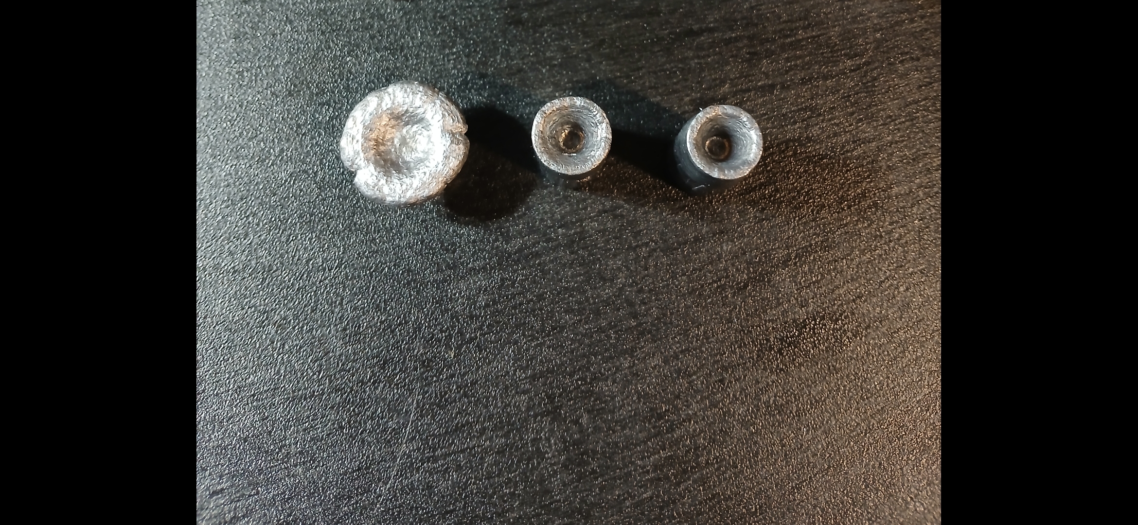

Here's some food for thought... When it comes to lead and the intended critter, there's always a balance between projectile weight, energy dump, expansion, critter penetration and the needed speed to accomplish said.
Those hollow Varmint Knockers and FX Hybrids were designed by bird and rodent "pesters" and they do very well with those size of critter. On a meatier more robust game animal that design of a slug, even weighing more, are usually a poor choice for penetration because they dump all of their energy within three to four inches of penetration. A more solid hollow point slug of the same weight will have far better penetration and possibly (ideally) pass through for two leaking holes.
Pictured left to right, 240 grain, 325 grain, 350 grain. Same lead, nose shape, and hollow point. Had the heavier lead been travelling a hundred fps faster they would have looked like the lighter slug does on the left. And likewise, it would have penetrated a bit less because of the greater expansion and energy dump.
Muzzle velocity - Foot Pounds Energy
240 grain - 845 fps - 381 pfe
325 grain - 745 fps - 401 pfe
350 grain - 711 fps - 392 pfe
Gel block penetration & impact speed:
240 grain - 838 fps - 10"
325 grain - 737 fps - 22"
350 grain - 708 fps - 25"
