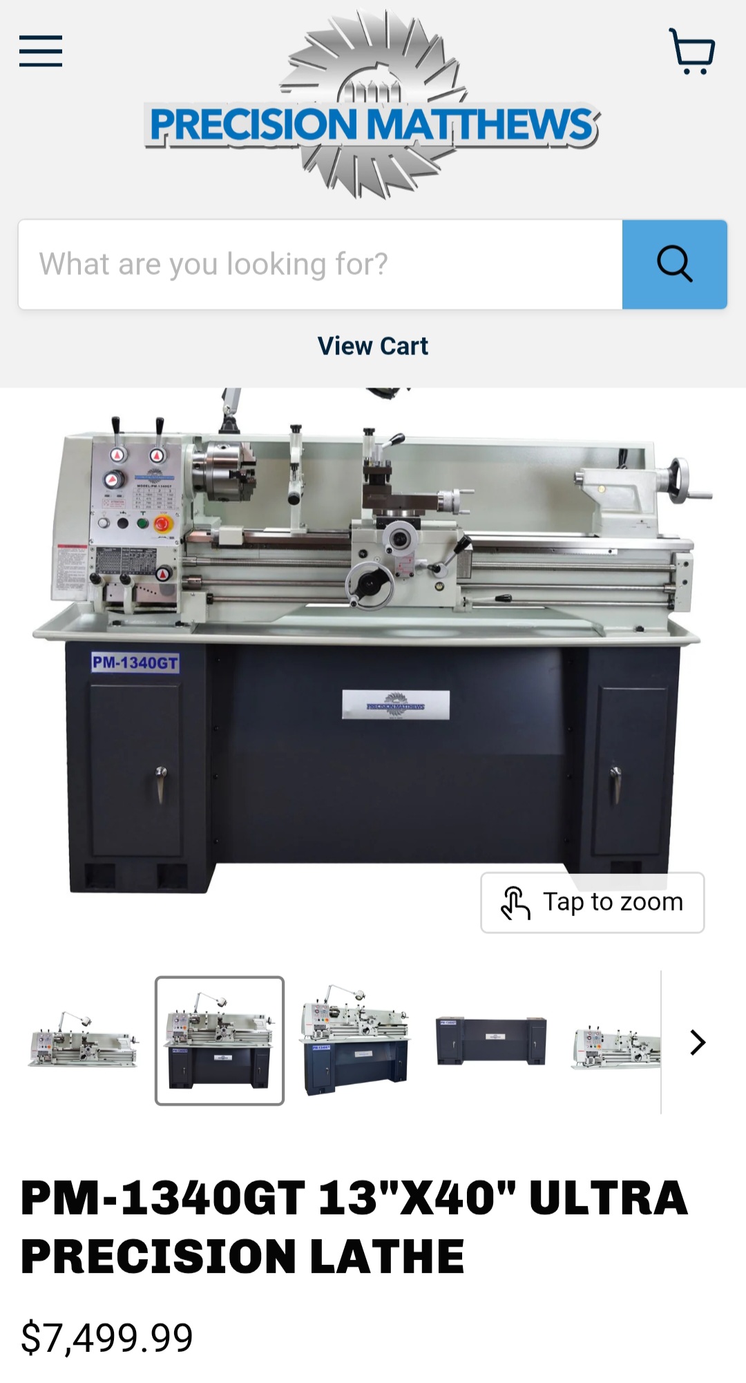

I'm looking more in the line of something like this.. I don't buy used machines.. not for my Frame shop.. n definitely not for a hobby.. but will look first to see where could I take some classes , I'm in this for the long run.. I don't have any other hobbys.. I like cars n speed but been close to some fatal crashes so no more cars for me ..
