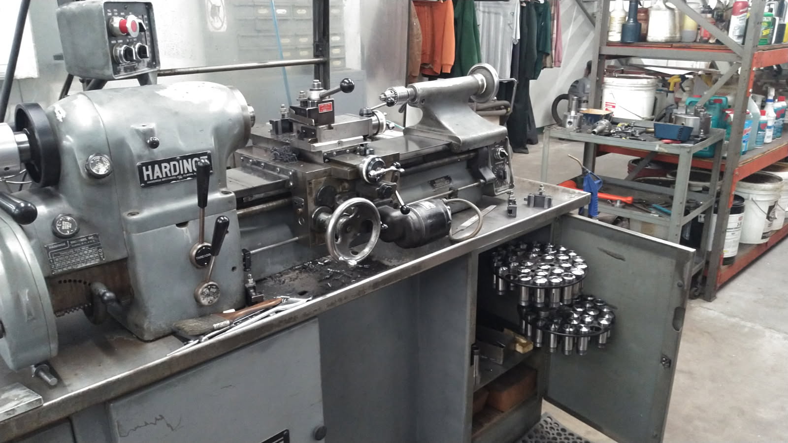

I have the best of both worlds....i can use this lath anytime I want, and it's not in my house!!
I'm a retiring tool maker who can't seem to retire.....so i have full use of a tool & die shop.
Collet lathes are the way to go. We have all the chucks, but....
carry on...
carry on...
I'm definitely envious!
