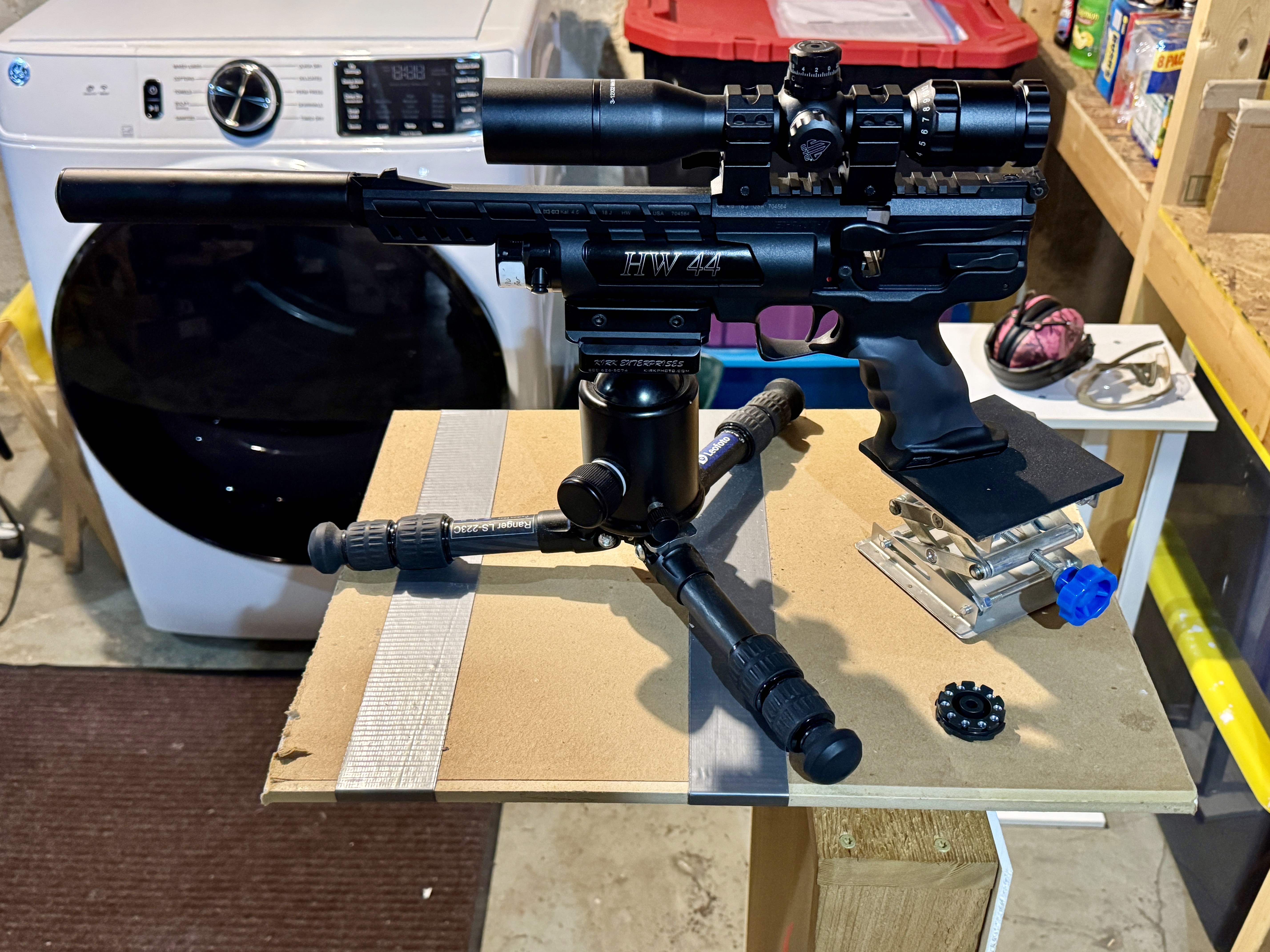

From my experience, the legs won't be an issue, no matter the brand. But the ball head will be your downfall. Unless you get a high quality ballhead with large ball/gripping surface, the gun will want to move and shake no matter the rear rest. Here is my setup with an Arca Swiss ballhead and this is for pistol.
