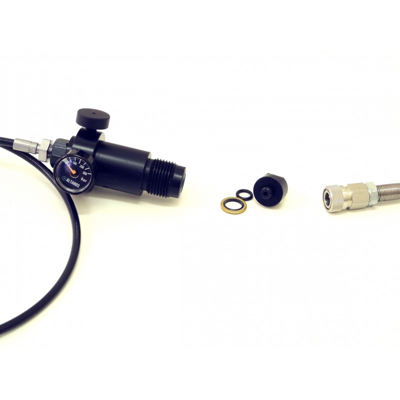

And there you have an external regulator that dont take M18x1.5 ;-)

I think I might just get one of the small bottles sold by Benjamin or Air Venturi and then get an external regulator from Altaros. I'll end up with more hoses and bits than I hoped for but at least I have a bit more confidence that it will work.

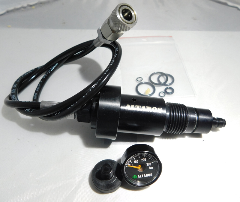

I found this one over the weekend and ordered one:
It's a fixed 2,200 psi output regulator, which turns out is the ideal pressure for the current tune on my Airforce Escape. I figure that for $28 it's worth a try. And then this morning I found this:
For about $20 more it's adjustable. I'll give them both a try and see how they work. The only M18x1.5 tank I currently have is 500 cc, but if these regs work I'll probably pick up a bigger tank.

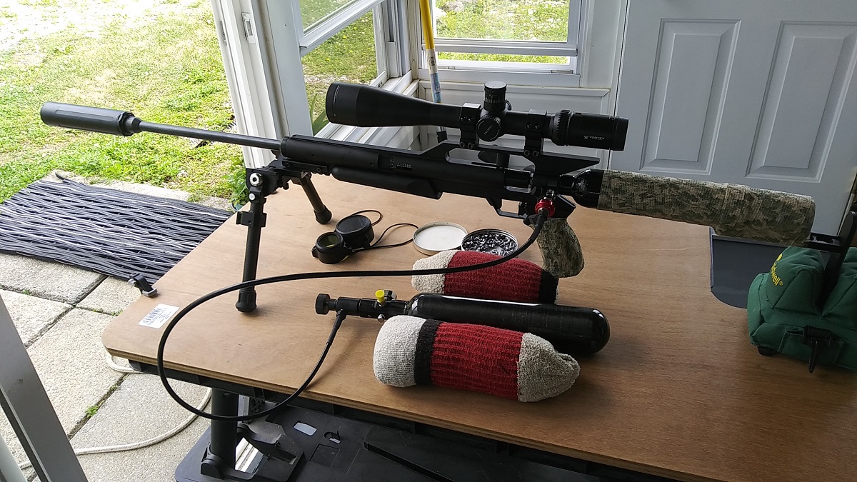

IT WORKS!!! :D
I'm using the non-adjustable (2,200 psi) regulator, a 500 cc carbon fiber tank, a paintball whip with a slip vent. I also have a bigger than stock, 380 cc tank on my escape. The 500 cc tank was filled to 4,000 psi and hooked everything up, opened the valve and it topped off the Escape to about 2,100 psi (according to the gauge on the Escape). I took 35 shots and the 500 cc tank went from 4,000 to 3,000 psi, so I'm guessing that with a 300 bar fill I'd get 60-70 shots before going off the regulator. Total investment around $200 (not counting the bigger tank on the Escape). :)
Oh, and did I mention that I'm shooting NSA 24.8 gr slugs? Pressure at the rifle's tank stayed right around 2,000 to 2,100 psi. This will work perfectly for what I want to do.

It sounds like you are all set, but I'll share what I use for my 500cc M18x1.5 regulated fill set up. It is nice and compact and works great, and is fully adjustable. I got it from Wes at Airgun Archery Fun in Canada, and it is not expensive either. A great bit of kit.
Edit - sorry, but it looks like it out of stock at the moment, but it is a good one if it comes back.
