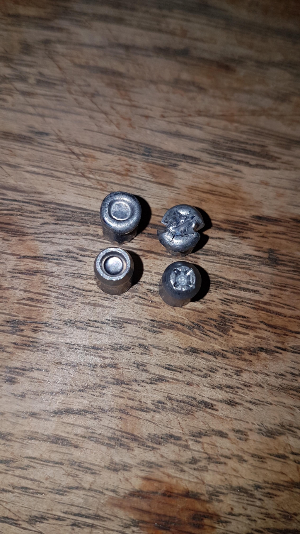

Hey guys,
Did some testing with both the Crow magnum and the Baracuda Hunter Extreme. Shot them at the bottom of a bottle of water at 25 yards and found the pellets in the bottles. Baracudas hunter Exteme shot the most accurate. What ya guys think?
