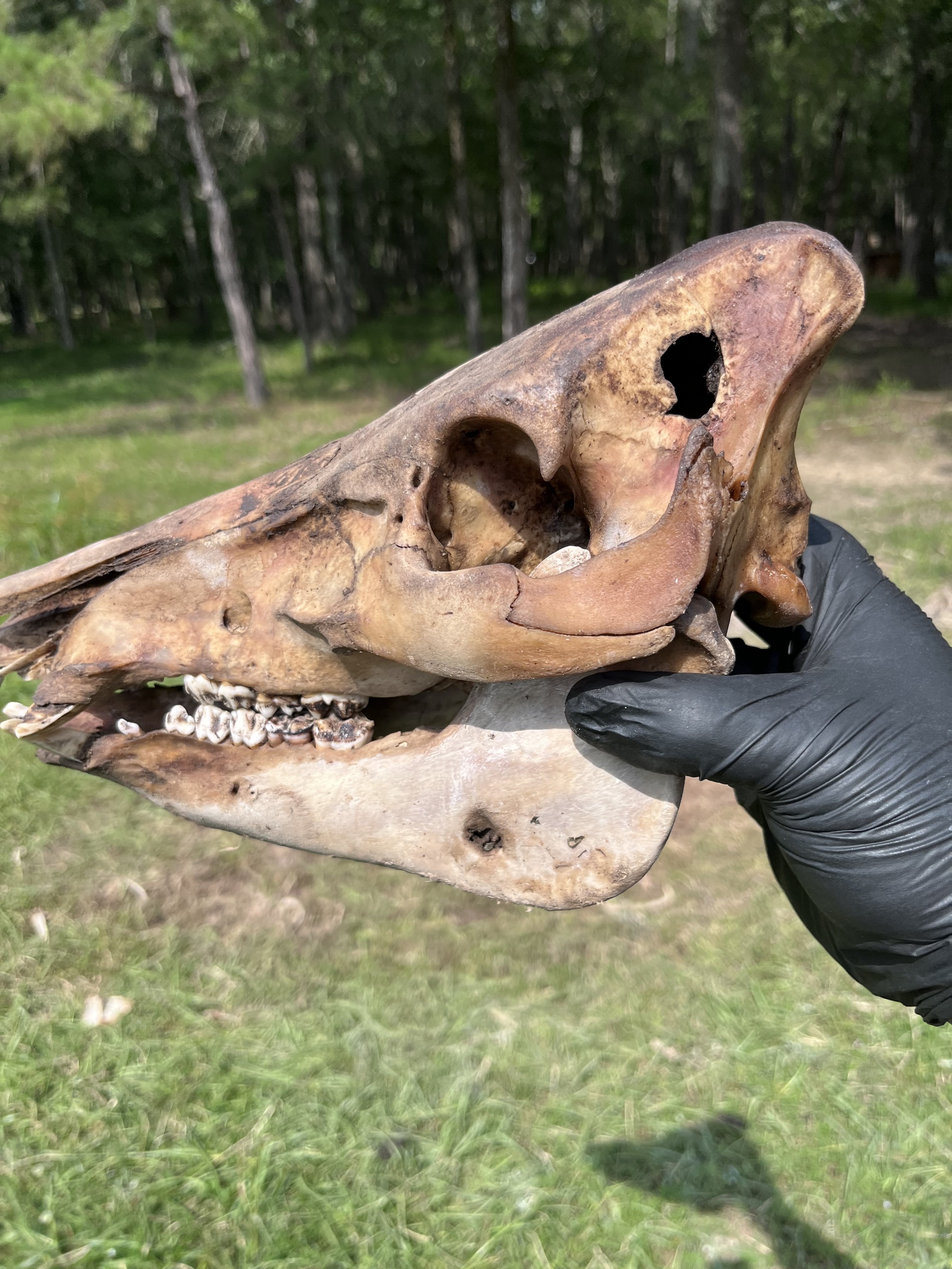

Video of one hog harvested with the Texan. And pic of skull showing impact to the brain cavity. 350grain slug.

If it’s a brain shot, easily.
Easily, actually don't even need that a .22 @ 50 FPE ( at the muzzle ) with the right pellet will put down big Hogs,...how do I know ? ;)
