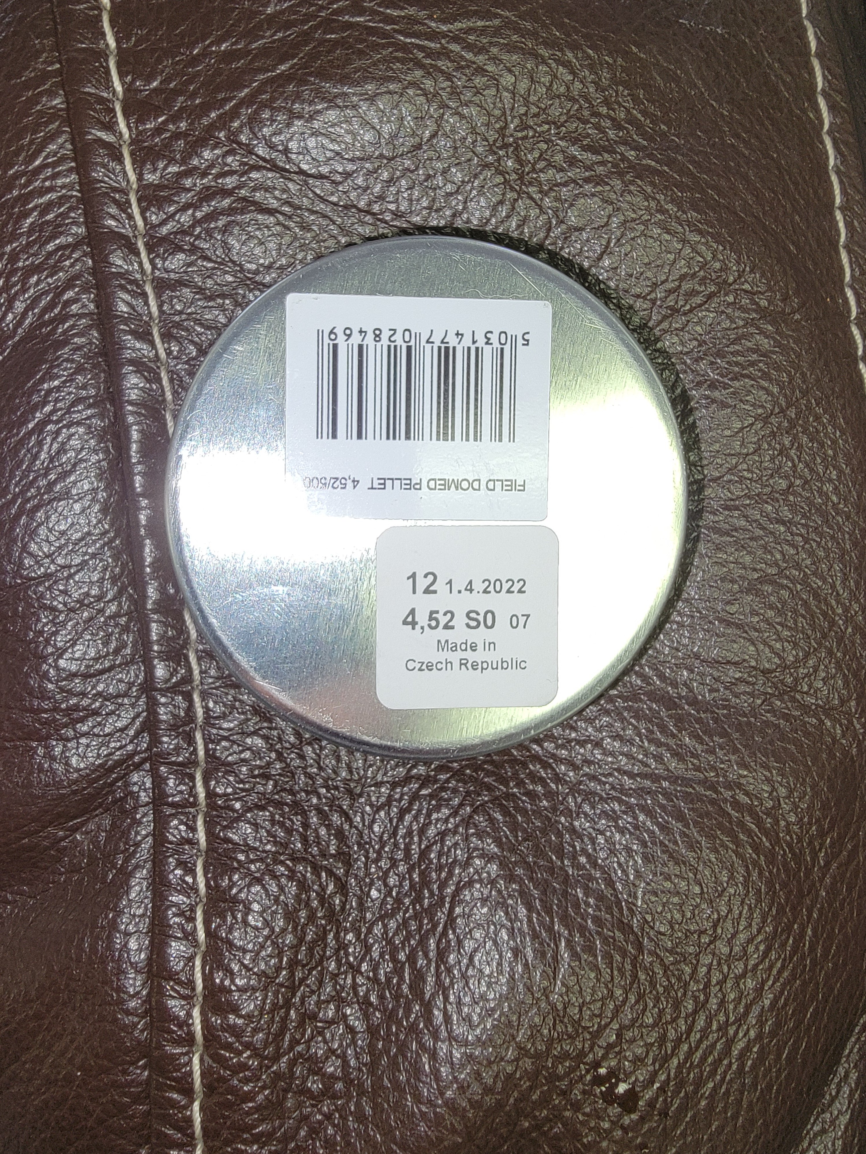

My advice if you’re concerned about accuracy or target shooting don’t mix tins of pellets especially if they are JSB. Most are coming to you with out lot #’s, it also requires a lot of testing to find a pellet your specific gun likes or will shoot to your standard’s.
There is more to knowing why your gun will shoot one lot # better than another’s not just weight or head size.
