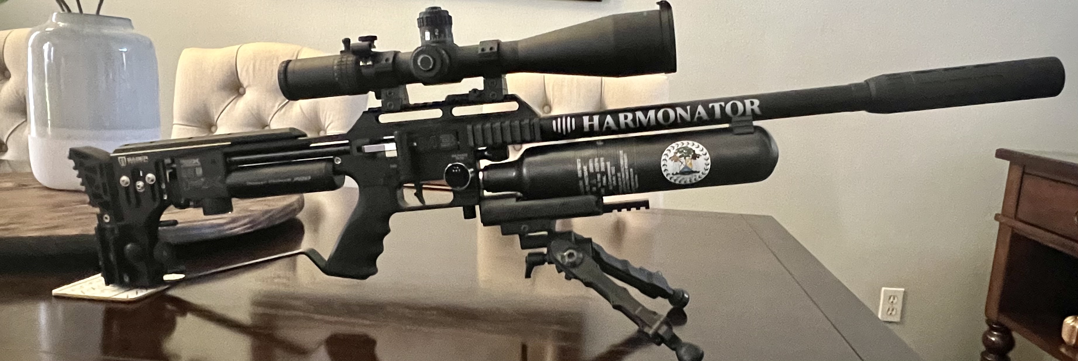

Now getting back to the topic at hand, I recently started to venture into the world of precision rifle shooting with high power airguns. With the accelerated growth and technological advancements in the airgun industry we are now able to combine the power and efficiency of modern airguns with the increased ballistic performance of airgun specific slugs. This combination now allows airgunners to push the boundaries of what is possible with an airgun. Basically we can now shoot targets much farther away with much more accuracy and precision than was ever possible with traditional drag stabilized diabolo pellets. This has ushered in a new era for airgunners with organizations such as PRS and NRL opening the doors to airguns to compete against rimfire rifles at distances previously unimaginable.
So what does all this have to do with the topic at hand you say?? Well, it’s pretty simple actually. I was looking at a typical NRL event the other day and at the stages and course of fire for each stage and while doing so I was asking myself what characteristics I would want in a scope for this type of shooting. While making a checklist of what I wanted, It quickly became apparent that what I was missing all along was the fact that different scopes are designed for different applications and the decision on which type of scope to buy had less to do with it being more similar to inches and fractions of an inch or a 1/10 scale factor used in the metric system but more so on the characteristics and feature set of the scope and how well that feature set aligns with what you need it to do for you as a shooter.
So let’s take a look at PRS and NRL shooting for example. In these types of events you are engaging multiple targets of different sizes and different distances all while on the clock. As you move down the course of fire you are engaging targets further and further away and therefore you are constantly dialing for elevation and windage. Since you are on the clock time is of essence so the less time you spend dialing the better right? Here is where the MIL scopes shine. It’s a lot quicker to dial 2 MILS than it is to dial 7 MOA so that’s time saved every time you have to adjust for elevation and windage. The finer adjustments of MOA are no longer of great importance as the sizes of the targets are much larger and that extra level of precision in reticle adjustments is no longer necessary. The targets are not 1/4” at 100 yds anymore either so having a thin reticle that doesn’t get thicker with increased magnification is no longer a priority. Instead, the ability to have your reticle sub-tensions remain true to value at any magnification you may be in is now basically a must have especially in stages where you have to use your reticle to range your targets. So as you can see, the feature set of a scope geared towards one particular style of shooting or application may be significantly different to one designed for another style of shooting or application. Different tools for different jobs… Now when someone asks me what scope I would recommend, my answer is “it depends….”.

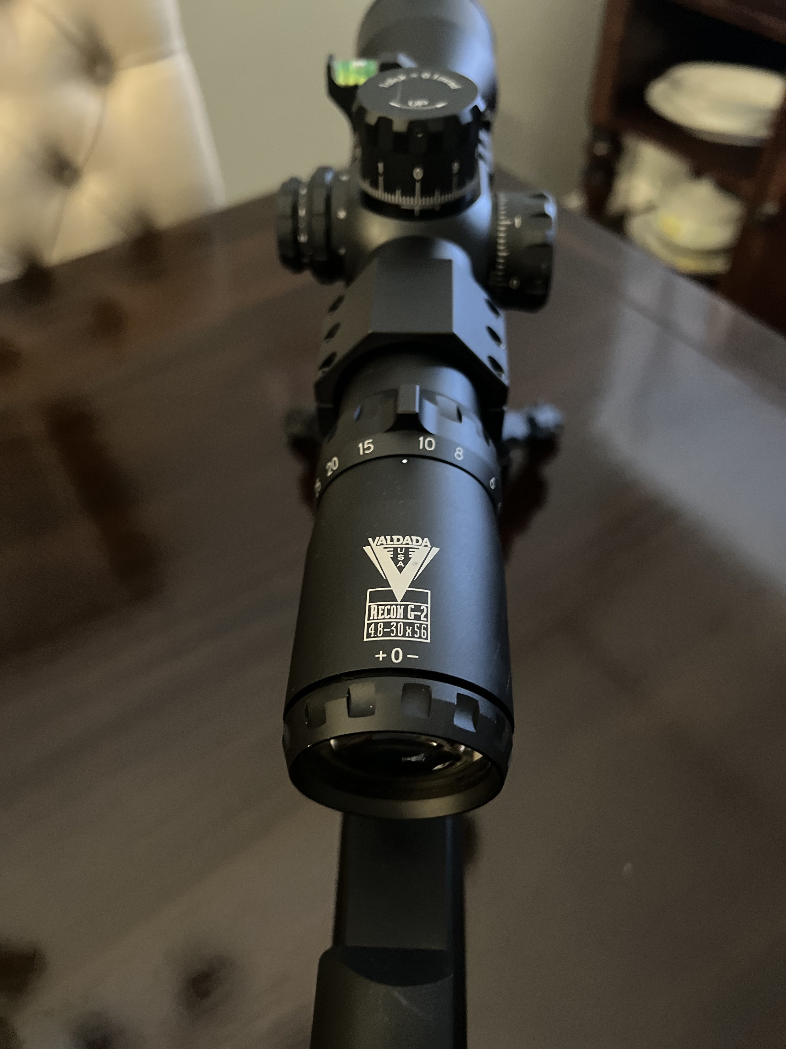

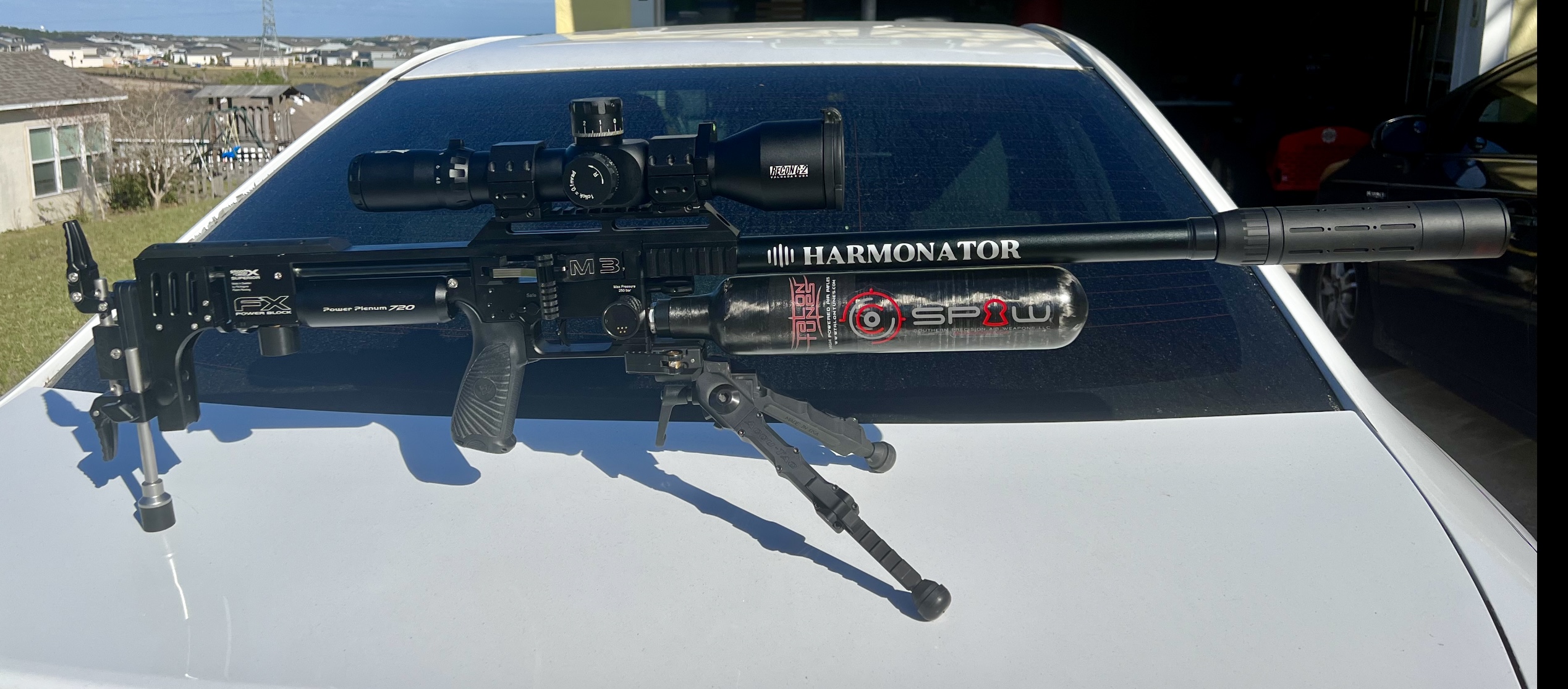

My current PRS gun is now topped with a ValdadaOptics Recon G2 4.8-30x56 in MIL (who would have thought??) with a FFP reticle and a 40 mm main tube allowing an elevation adjustment range of 43 MILS or 150 MOA. Plenty for shooting airgun slugs out past 300 yds. So I now have both MOA and MIL scopes with both SFP and FFP reticles. The 1/10 scale is actually pretty simple to use as well and the more I use it the more I understand why so many people like it.
