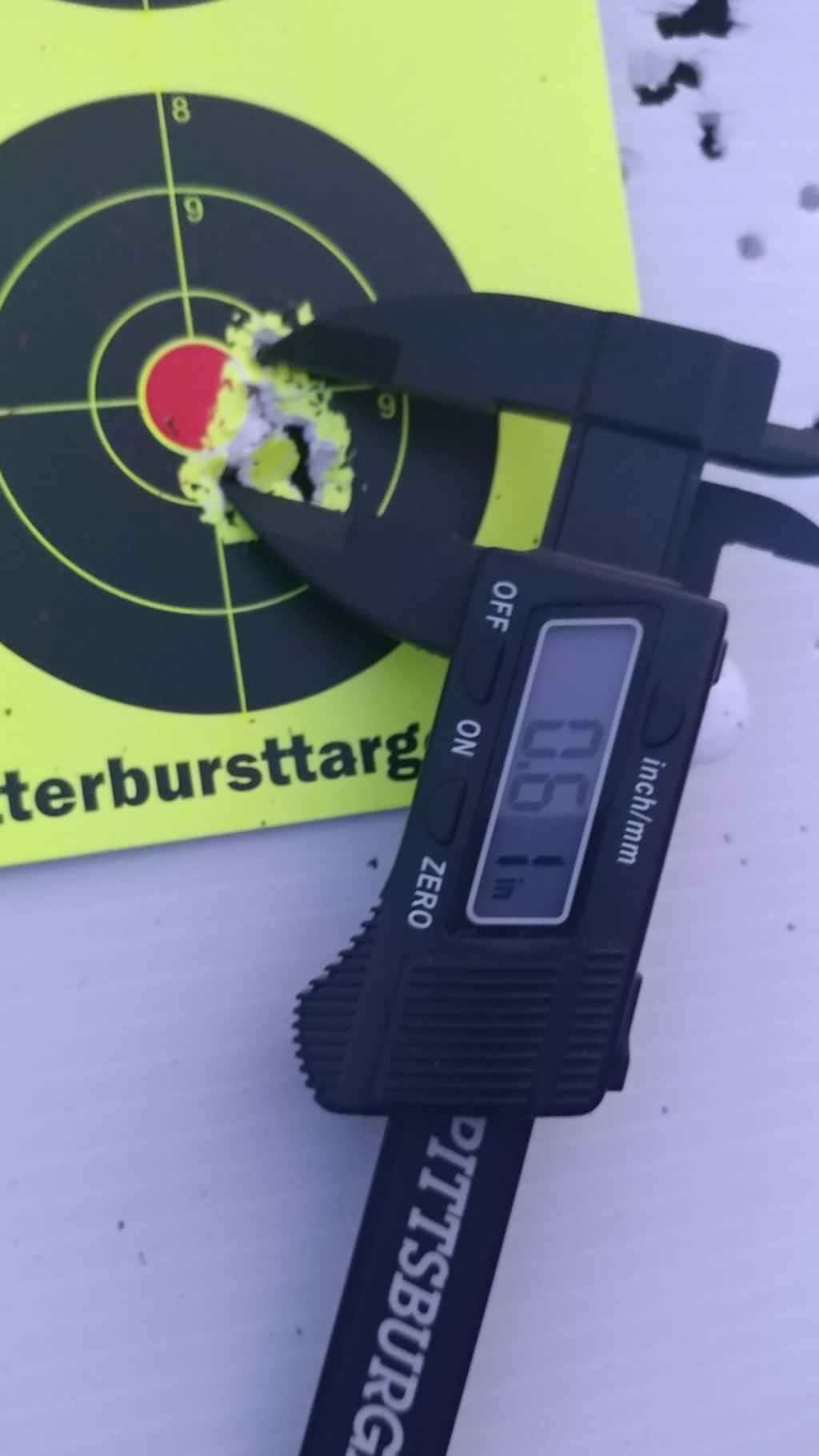

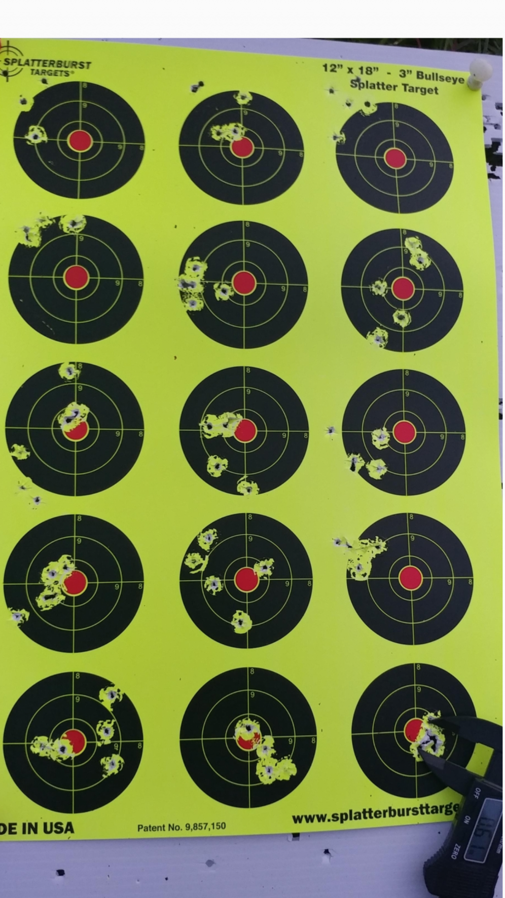

Hey, my gun is MOA at 100 yards with pellets 😀:
Oh wait 😣:

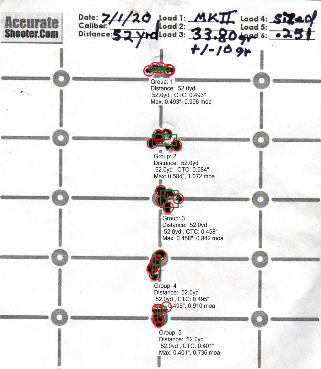

Here's some groups I ran one day. They are only at 52 yards, but they let me know I am on the right track. I have several other sheets of groups giving me similar results to these which are all 5-shot groups..
