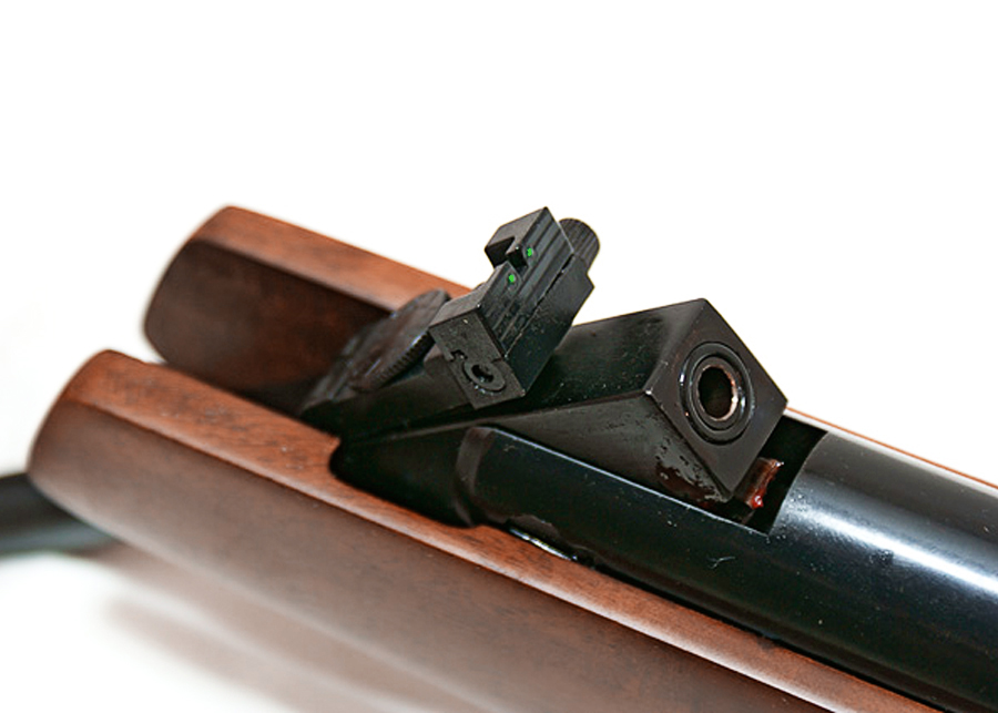

this is a picture off Airgun Depot of a 95
first of it has enough oil on it for a V-8
but the grooves and lands are as you start pushing the pellet in
i would think if those could be smoothed out with a rubber cone abrasive for a Demel tool it could load better

Sometimes the holes that are drilled and tapped in the receiver have rough burrs on the interior. The piston rubs against these burrs and it scars the piston. Now it two rough surfaces grinding against each other. This may be what you are experiencing.

You can polish the breech just like polishing a crown. Roll up some 400 grit paper into a little cone and go at it until it gets a little easier to seat. Polish it up with 1000 grit and it will be great.

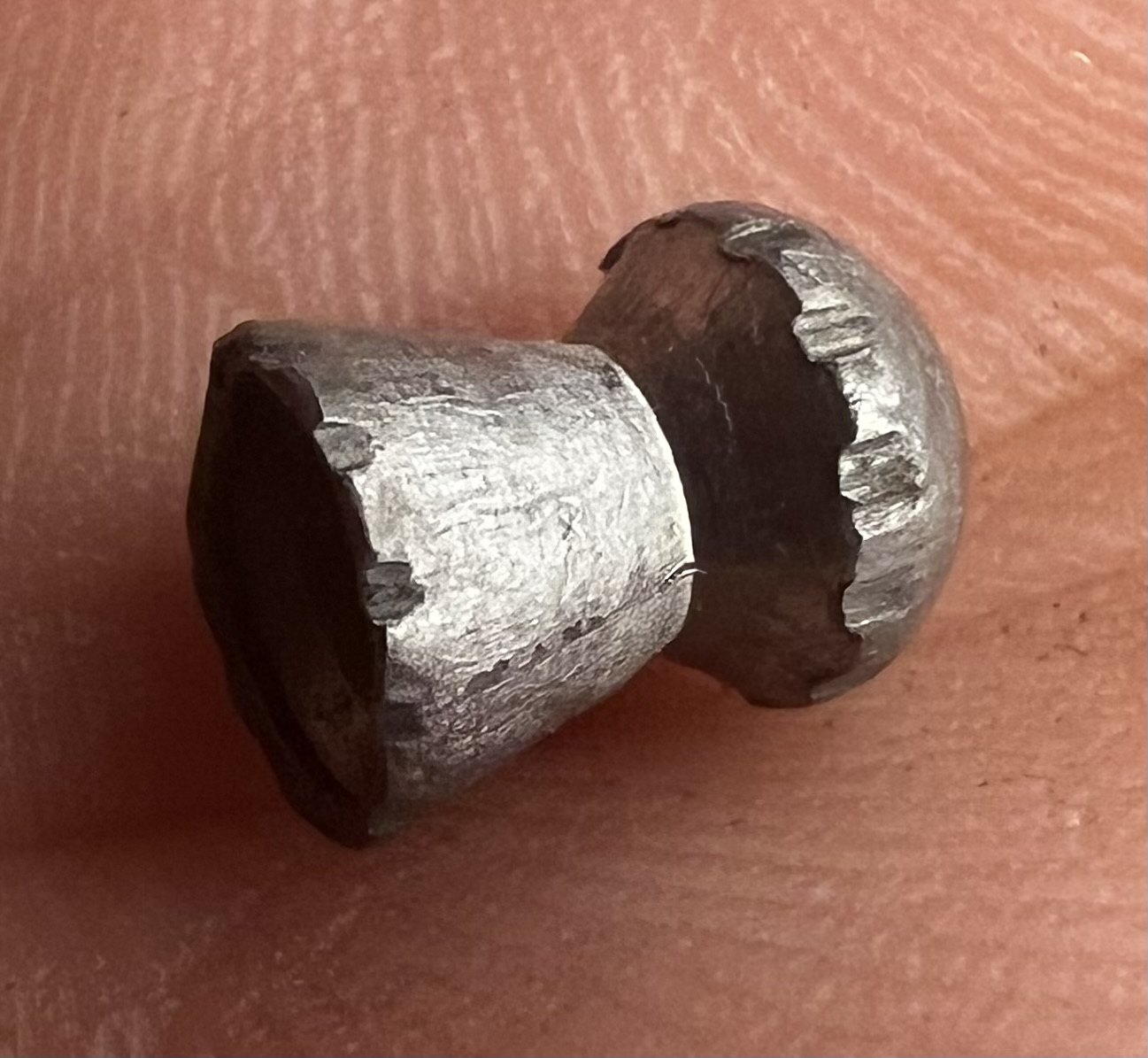

This is a 16.2 grain JSB EXACT. That look normal to you?
Zoom in……
There is a whole lot more contact on the head than the skirt. It looks like it pulled lead over the entire head. A funky looking v cut to the rifling too. Rough.
A fired pellet might look better. The skirt swells up. Still it's too tight up front. It pulled lead back around the head. Even in the grooves. The rifling is obviously rough.

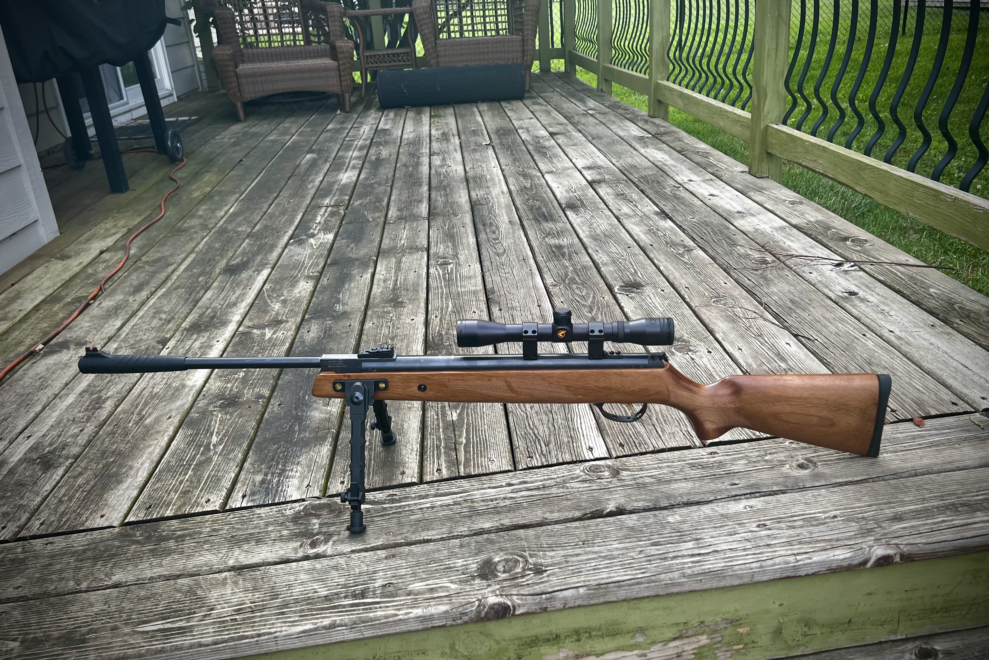

That's my hatsan 101. I'm no expert nor an airgun Smith by any means. Just my observations and experience on them in the last few years. Hope it helps.

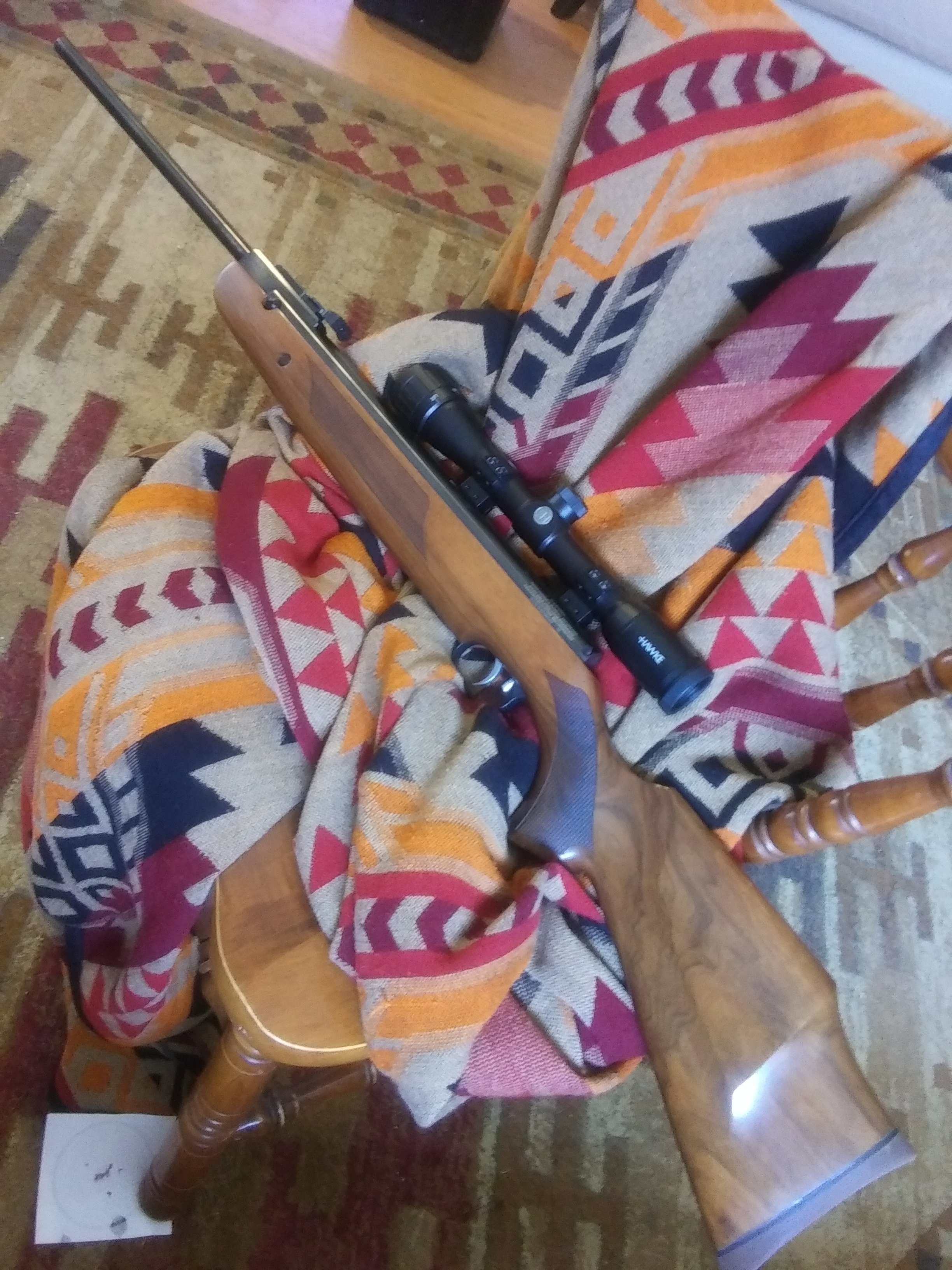

Weihrauch HW95N Field Pro .22 Walnut​
Is the one I ordered. Yours looks very nice. Love the grain on the butt end of the gun

The walnut is good. I'm not sure it's worth the extra you pay but it is nice. I used steel wool with a little danish oil on it. Then paste waxed it. It polishes up really nice in your hands.
I hope yours has some figuring. I hear some guys griping about them being plain. It's a crap shoot I guess. Mine didn't have much character when I took it out of the box. A little oil and some hand rubbing brought out the grain nicely. Any piece of wood can be improved upon with a little elbow grease. Hand rubbed walnut looks great even if it is a bland piece of wood. I'm sure you will be happy with it.
I had ordered the 95L and they were backordered. I got the walnut because I didn't have to wait two weeks. I'm a pretty thrifty guy and I don't usually go for the more expensive stocks but I figured what the heck. I'm happy I went ahead and got the walnut. It's a sweet little gun.
My son loves to shoot it. It's too pretty for me to shoot. I mostly just look at it and brag about it.
