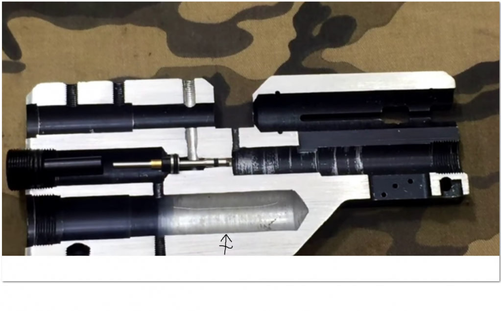

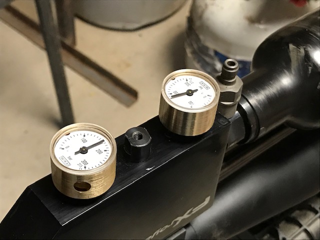

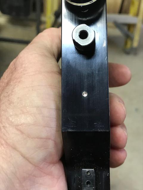

On the Royale, being a bottle gun, the reg is in the action block. The stock attaching screw enters the bottom of the plenum, so no room there. It could probably be done on the side of the action, with a hole for the face of the gauge drilled on the side of the stock. Since the reg has to be removed for adjustment, maybe the better solution is a reg test gauge, then you're not creating another source for a leak.

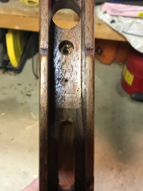

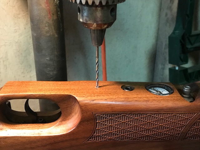

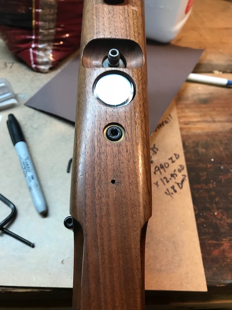

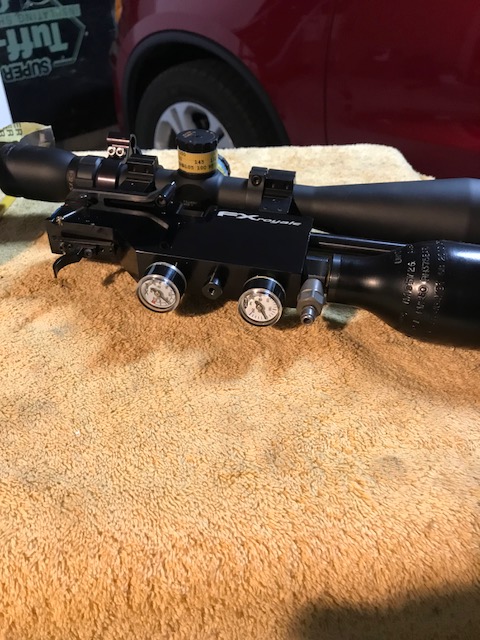

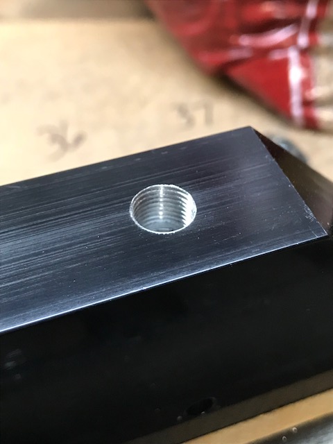

Sure did Glem, and a fun but sphincter tightening adventure it was lol. In summary just drill a hole through your stock to accommodate the gauge of choice. Drill and tap a the action block for the new gauge and wallah your done. Without a lot of description here are a few photos pretty much in order of the whole process I went through. To finish up I did modify it Wika gauges.
