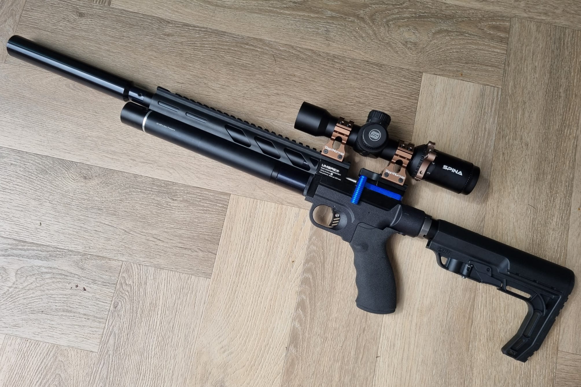

There are bottle conversions and FX barrel adapters. So you can get it to perform like a different rifle.

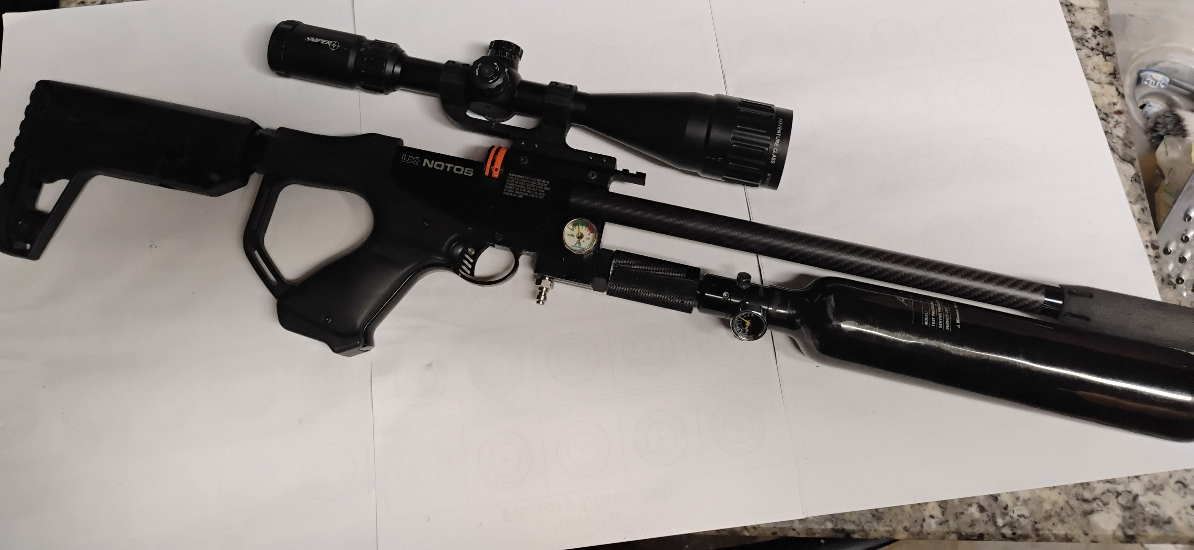

My Notos just got back to the stock air cylinder that has a Huma reg fitted, and with the plenum kit from c88. It gives me 18 joules and 75 shots. I have 5 12-shot magazines from Carm and since I have to reload them after 60 shots, the air reservoir is sufficient.
With the Huben Cricket regulator the balance is just off and I never got it quite right on the Notos like on my PP750., which is a great gun with all the mods and a better trigger than the Notos. However, I like the Notos better this way:

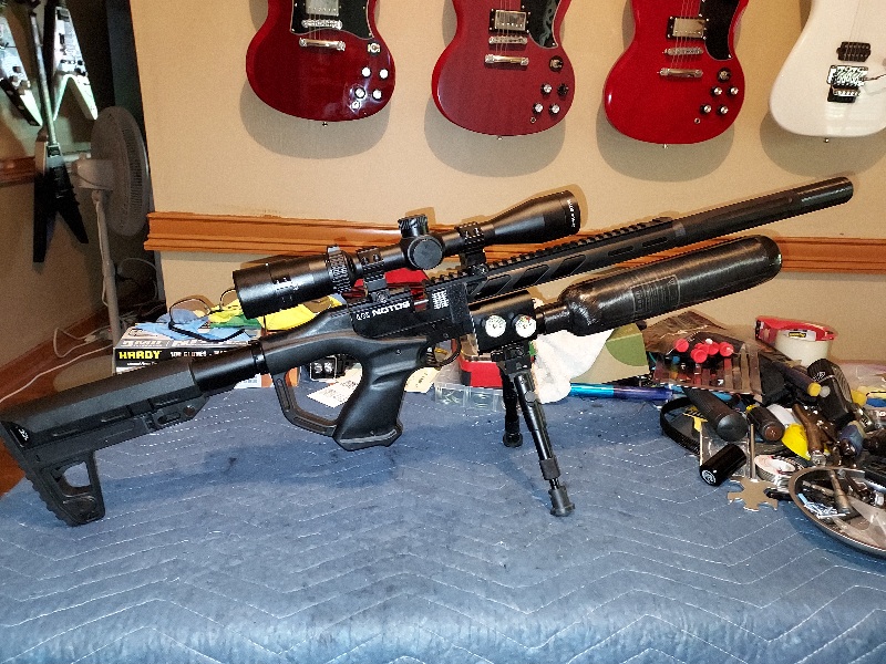

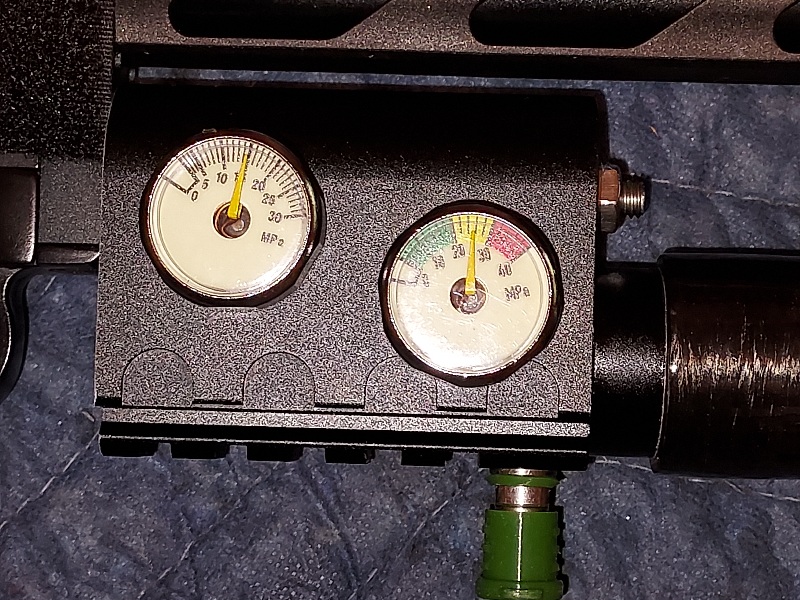

I just swapped out drop blocks on my notos, switched from the Amazon Supewell drop block to a Huben Regulated drop block, now the bottle doesn't touch the moderator, now I'm dialing in the settings, too hot today to go outside, will dial it in maybe tomorrow.....
had to shave off just a little bit to clock the block and tap it with a M16x1 tap
Reactions: phoenix_cow
I just swapped out drop blocks on my notos, switched from the Amazon Supewell drop block to a Huben Regulated drop block, now the bottle doesn't touch the moderator, now I'm dialing in the settings, too hot today to go outside, will dial it in maybe tomorrow.....View attachment 486794
Same findings doing the same. Time being I just shaved a little off a cheap buckrail mod. Or if I drop to a 360cc or move up to a 500mm barrel that won't happen.

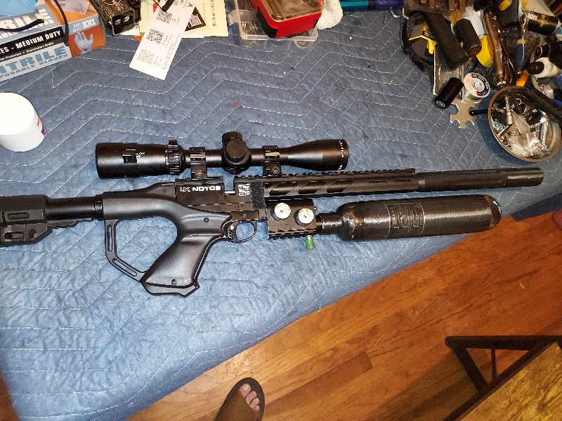

I sent some pellets thru the Chony and did some adjusting, max fps was 760, a little shy of what I was going for but it will work, it is shooting like a laser, I was picking off Carpenter Ants on the tree 25 yards away and just over 20fpe, it's good for Squirrels and any other small rodentia, also Invasive foul that may wander into my yard...... ;):eek::sneaky::giggle:
Reactions: mandn
Did you port? I see you're running at 1900.
When I just slapped on a 22 reg without the port + a plenum I was at 785 with 15.9s and 720 with slugs. When I ported at 1900 I was at 821 with 15.9s and 765 with slugs
Reactions: daddypaddy
No, I just left it alone for now, I might do some porting later but it's shooting so accurately right now I really don't want to mess with it.... it will take squirrels without an issue so I see no reason to increase the power, at least for now ;)
btw, I did try higher reg pressures and did run into valve lock issues above 2400psi, it seems at the pressure it's set at now it get's the best fps without valve lock and wasted air.
