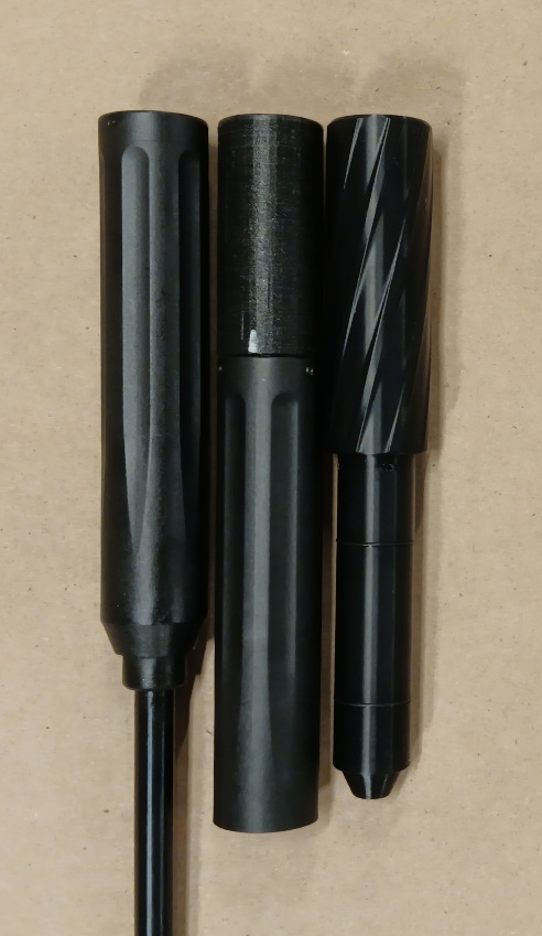

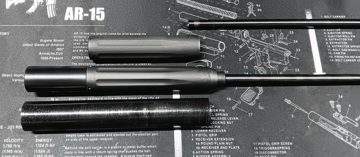

Had to remove my mod on mine. It is a very destructive and there is no getting it back on once off. As far as I'm aware, there is no clean/easy way to take it off.
There are 2 (if I remember right) metal clips that are molded into the mod that attaches it to the barrel. There is no access to these clips at all. You have to saw it off in one way or another, I used a reciprocating saw. Of course being very careful not to hit the barrel in the process.
Yeah, they really did not want you to remove it for some reason.
