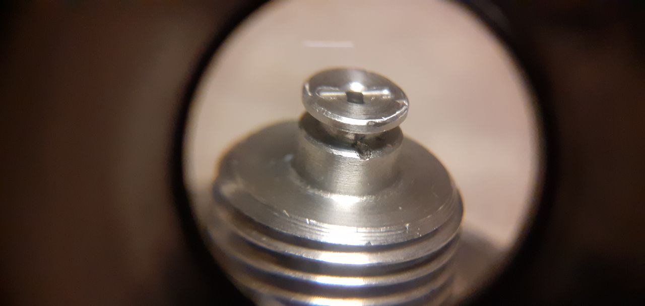

unfortunately the gun has a slow leak on the bottle adapter, and when i looked closer, i saw another so far 3rd factory flaw: a really sharp edged machining damage on the ridge for the o-ring, which might have been the cause for it to break faster. unfortunately after fine sanding and polishing the edges smooth and exchanging the o-ring, the leak is still the same. if anybody has an idea, of what do do about it, please let me know. thank you.
