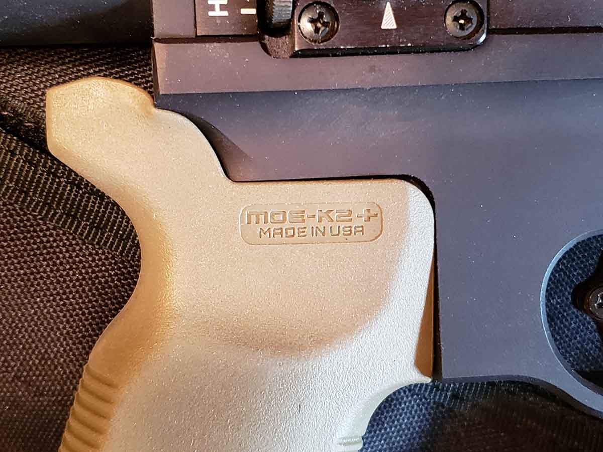

- Hatsan Factor RC - Can be made to fit - See photo
One reason I bought my 22 Cal Factor RC was because of the AR style grip. I just tried to install a Magpul K2+ semi vertical grip today and it would not easily slide onto the attachment point. The metal was too thick. I had to tap it on with a plastic mallet. The placement hole that holds the grip on is at the wrong angle and it is too far forward, not allowing the trip to align properly with the receiver. The threaded hole in the receiver is significantly smaller than milspec dimensions so you will need to get a shorter screw with the same threads as the very long one that held on the factory grip. Without hogging out the hole for the screw in the grip, this was the best fit I could come up with. I will probably fix it later, but it is fine for now. Not much to do about the beavertail extension not quite matching the curves of the receiver, but, not a big deal for me. I don't want to cut the Magpul and don't want to remove metal from the gun.
