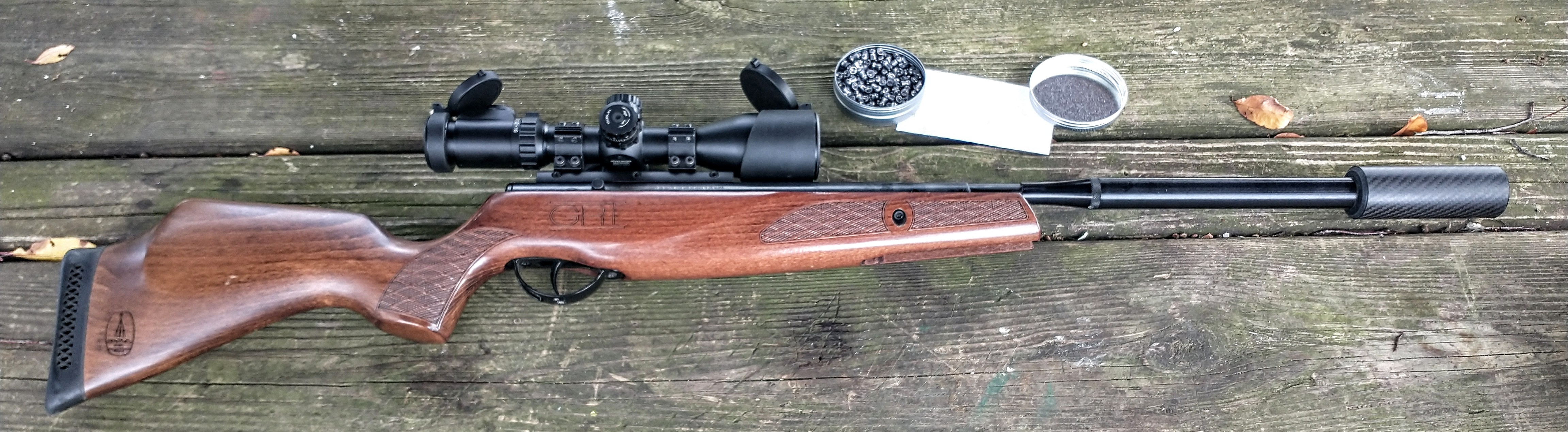

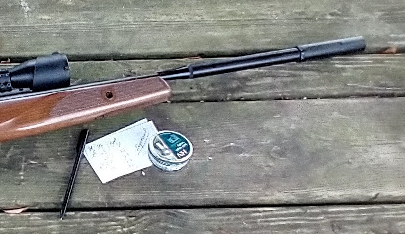

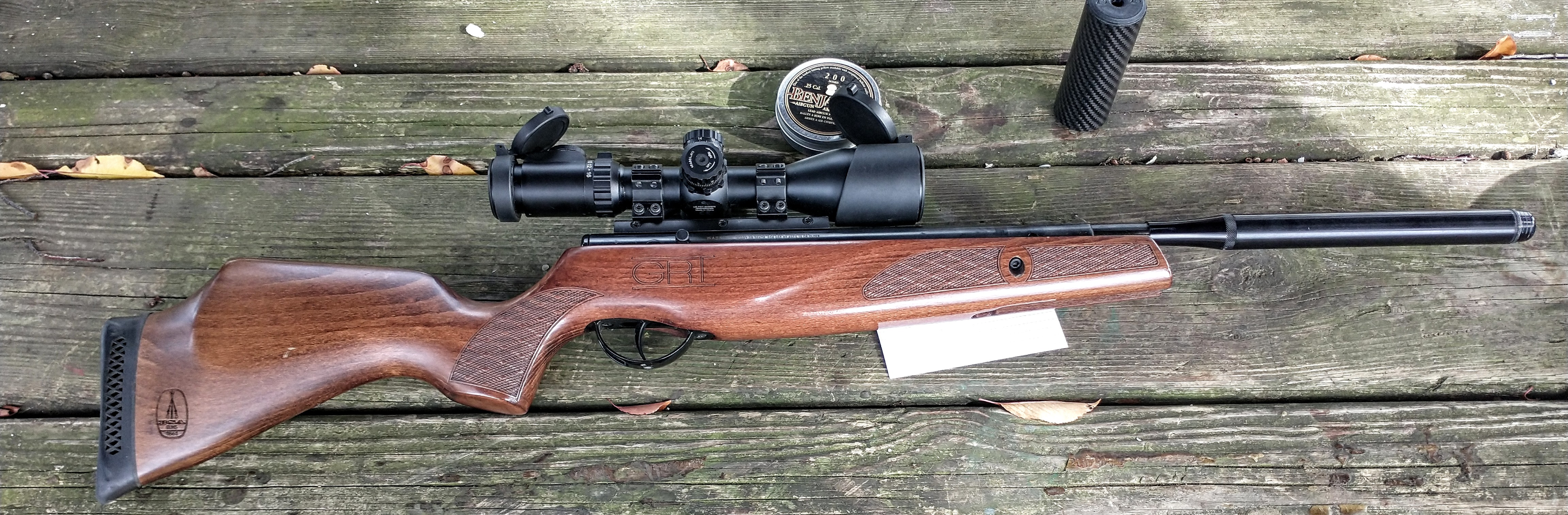

Well I found that the barrel was threaded for a moderator! Never actually thought about it but I knew that. Just remove the tip on the shroud and there you have it, 1/2 UNF threads. Well, I could not leave that challenge unanswered so... I just grabbed one of the .25 moderators I built recently and hung it on the rifle. It's kinda ugly but I can fix that with a CF tube that is the same diameter as the shroud. No worries.

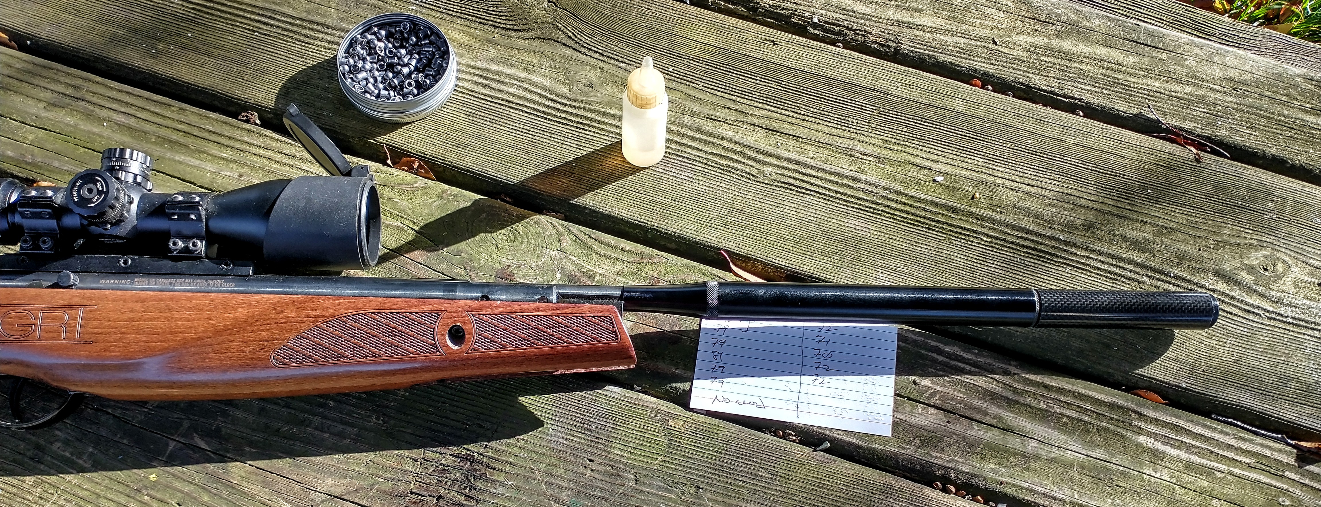

Well it isn't THAT weird looking but a 30mm tube would be just about a perfect match to the shroud. You wouldn't even know it was there at a distance.

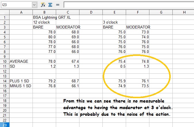

ANYWAY! So I set up to test at 5 yards at 12 o'clock and 3 o'clock. My results confirmed what I found on a different test. You can moderate a springer or even a gas ram.

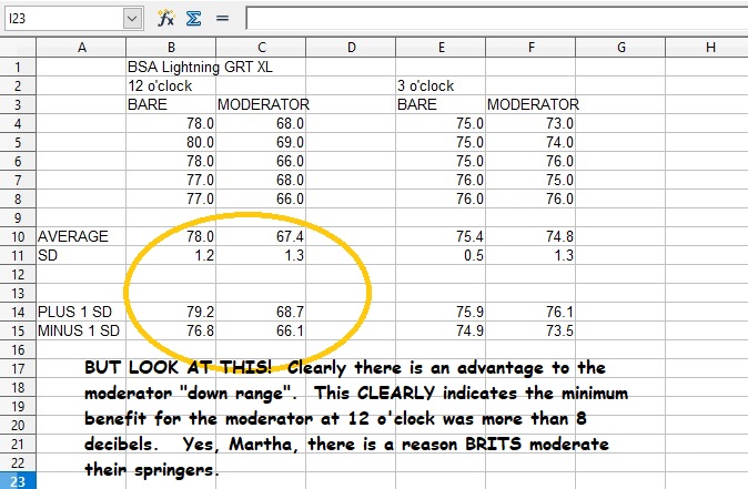

Oh yeah! That is a whole lot of difference. The odd thing is shooter can not hear it. Too much noise from the action for the shooter to ever hear the difference but it's there. Mr. Squirrel won't hear that rifle at 40 yards. I think a moderator made just for that action could improve on these results by a little bit.
