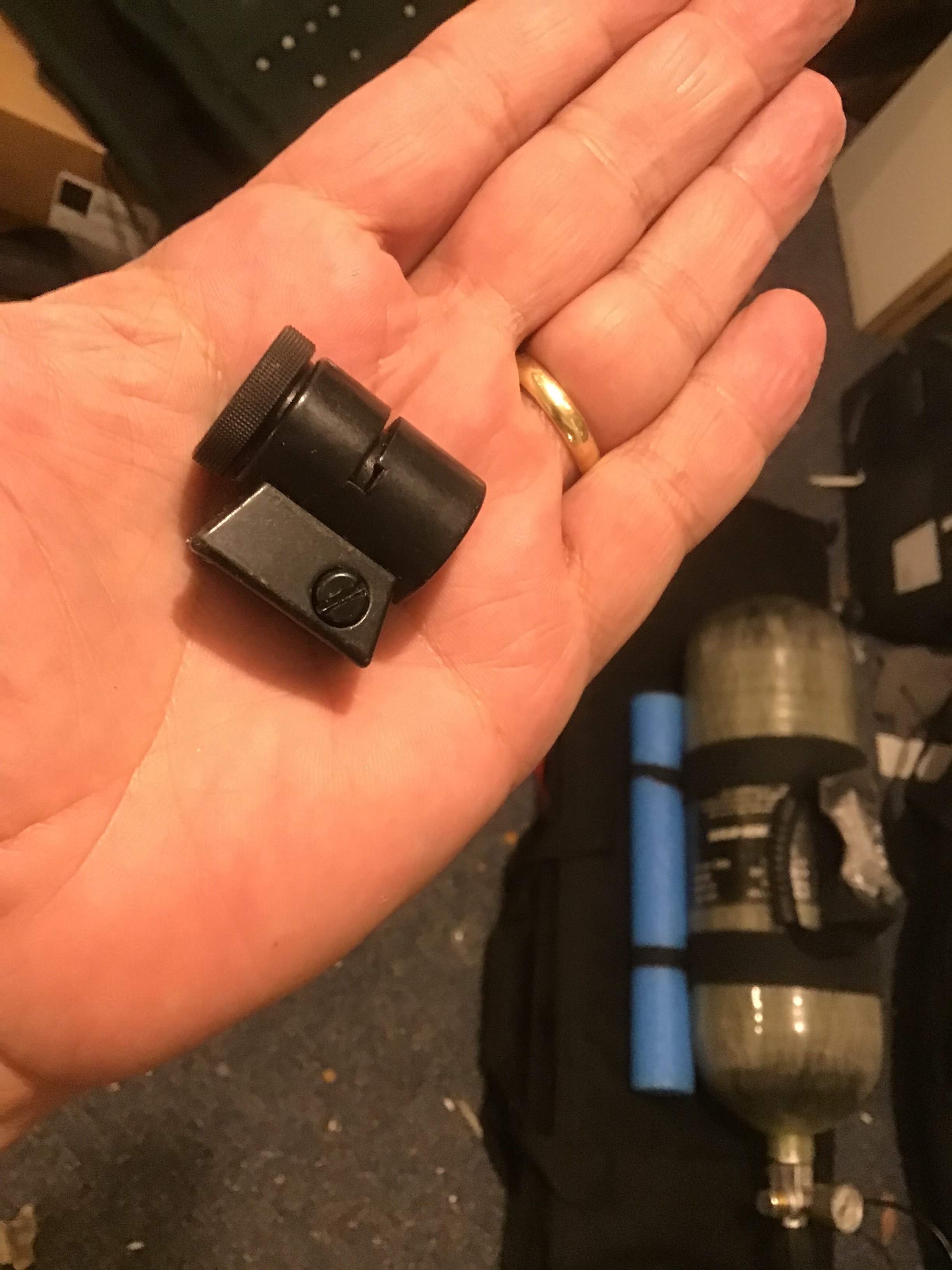

Was shooting the R9 this morning when I realized something was missing...
Wait... It's right here:eek:
Yup! the sight appears to have recoiled right off the gun!
Was thinking about putting it back on but also would like to put a moderator on the gun. Don't want to cut threads onto it but thought about one of those barrel diameter x 1/2"x20 threaded adapters. The OD of the R9 barrel is 15.7mm and I can get one of those adapters for a 16mm barrel diameter.
Question is would the 0.3mm oversize be an issue? If too loose I could put some masking tape on to reduce the annular gap and help keep it centered. Potentially also drill two very shallow pits for the set screws so the moderator wont recoil off as well.
Sound crazy or think it might work? Regards, Badger

OK good idea. I'll try three strips (0.072mm) on top followed by four 360 degree smooth wraps from a single strip of foil. Clamp the adapter set screws down on the top. On top because if I put the original sight back on it will cover the round scoring marks caused by the set screws. If it goes on easy with four, then I'll go to five.

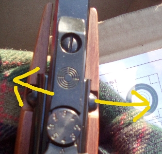

Thanks, you sent me these photos during an earlier thread where my scope mount recoil walked off the gun. I've been keeping the stock bolts tight but never checked the front sight.
Ya, that flat heat slotted screw just could not get enugh on it to hold the globe on.
The rear shifting around side to side i just happen to notice. Its a pretty cheap deal for a gun of its reputation and cost ( cheap china )..lol. Oh well it is what it is . Just keep patching it up and keep shooting..🎯. I dont scope it so its a critical issue. Lol
