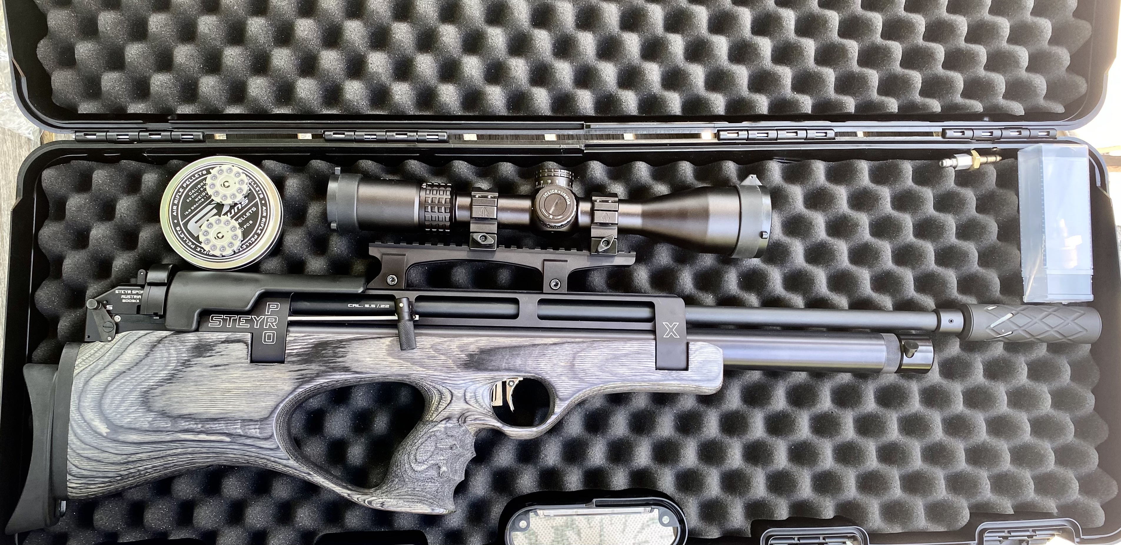

Got a .22 Steyr Pro X Scout on the way and want to get a moderator that will get this as quiet as possible. Likely to go with Donnyfl who recommended a Sumo in .22/.25. I was considering a Ronin but if anyone has experience with Donny’s moderators on the Steyr I’d appreciate any feedback. Would really prefer to go with the shorter Tatsu (matches the bullpup motif) but afraid it will not be quiet enough.
Also curious if the Sumo in .177/22 might be as quiet as a Ronin in .22/25 (that’s the smallest Ronin diameter) but is using a .177/22 diameter cutting it too close? Will be shooting AA Field Heavy 18gr pellets for the most part if that makes a dif.
