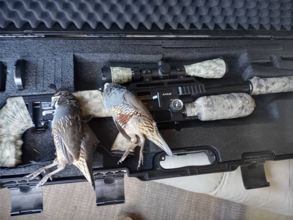

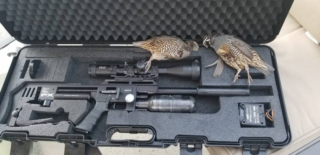

For hunting I find the quiter your gun is you'll get more second shots in case you miss. 30 cal seems to scare small game more. I like picking off quails here and there.
