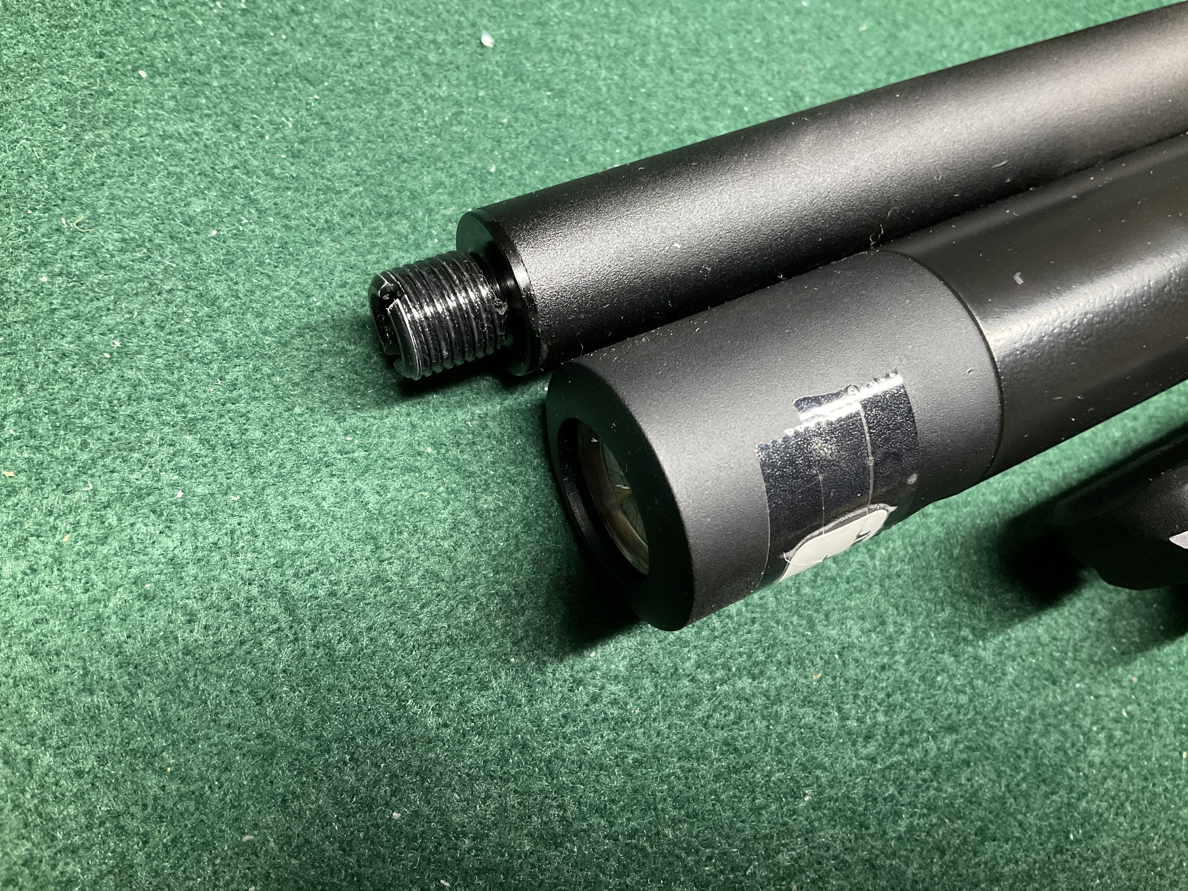

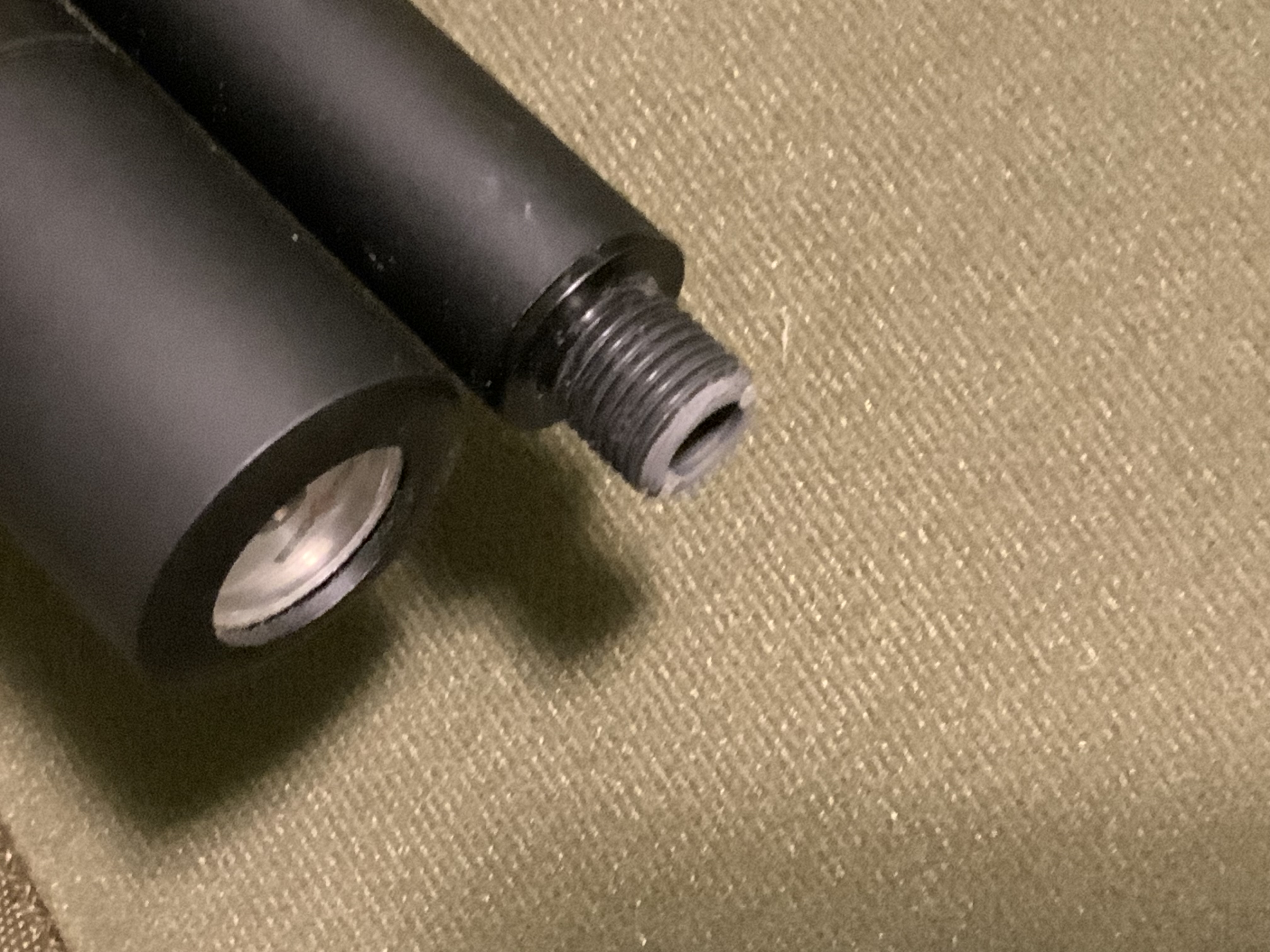

Wondering about the male end of my 0DB that came with BRK Atomic XR. I'm new to the PCP world so please excuse my ignorance. I see all moderators come with a female end. My 110C has a male end. I assume it's removable. If so, how is it removed? I tried unscrewing it, but no go. Couldn't find much with my initial searching. If someone can enlighten me, that'd be really helpful.

@Seanbuds Damn man. That was quite the ordeal. Glad to read that you were able to remove it. Did you damage anything in the process?
No kidding about going through all this trouble. Scuffed the surface of a few threads, but not too bad. Still functions okay. Grateful that AoA were prepared to send me a new one if needed. Now I'm anxiously waiting for my new Brocock MF170 to arrive.
