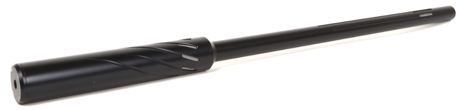

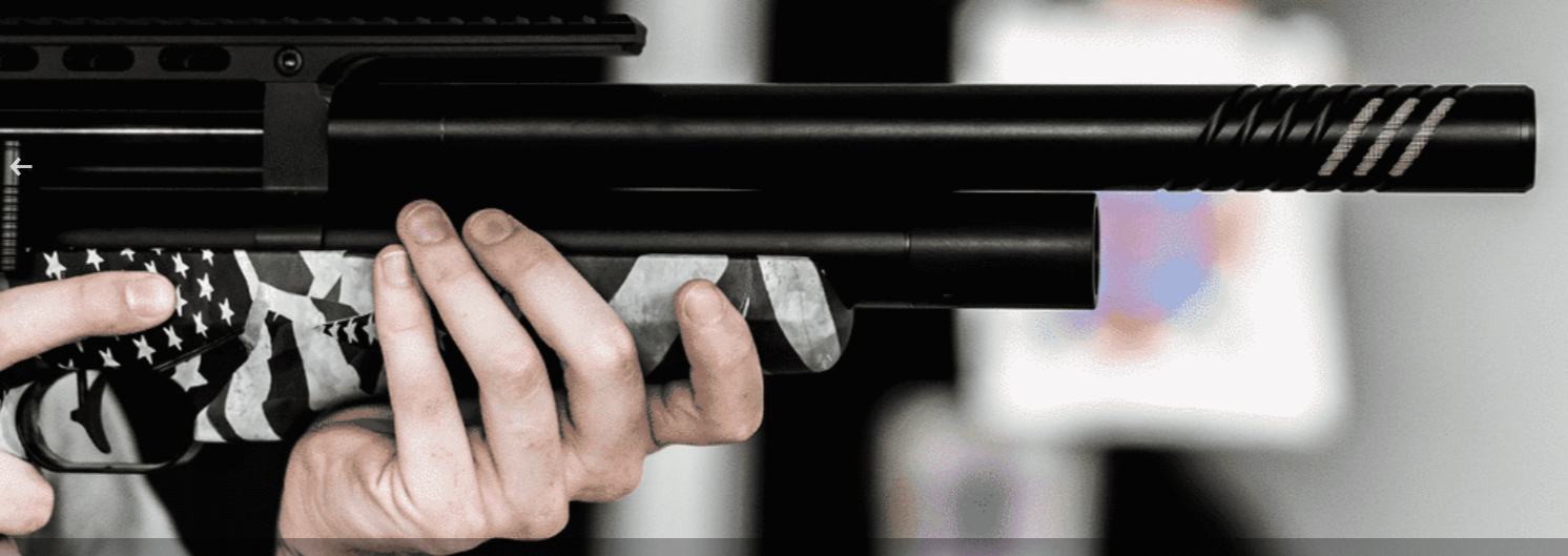

The replacement shrouds below are made by the same manufacturer. They have vents at the front and at the rear, respectively. Clearly it does not matter where vents are placed from a functional perspective; as long as they can be seen and admired. The extra grooves that have no vents makes it clear that this is about style; not substance. How else are you going to differentiate your product, when the competition is almost as good, and much cheaper?
