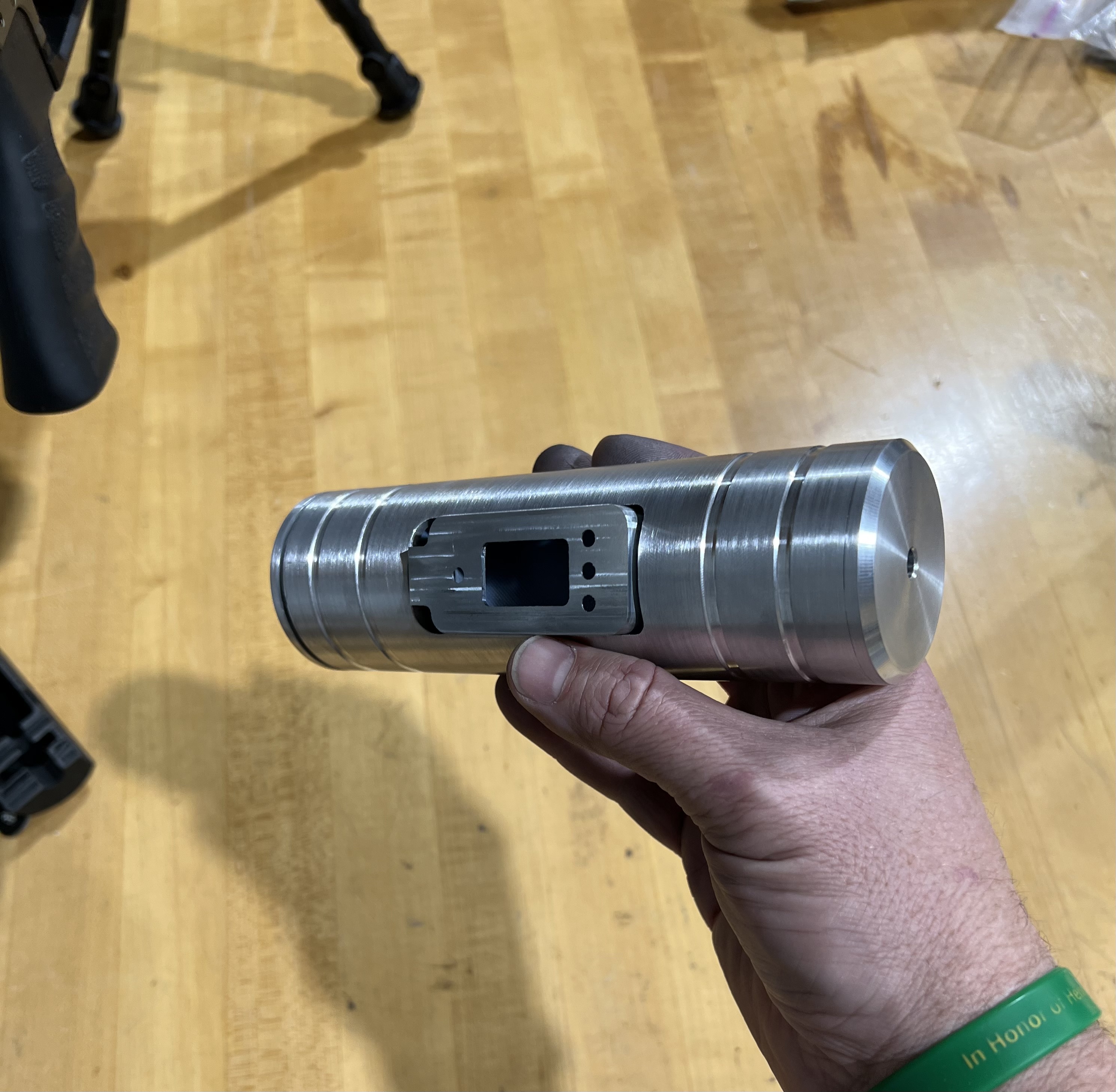

Got some work done on the aluminum prototype
Maybe I missed it, but that looks very fat and VERY heavy. Unless you have very small hands! ( smile)
A heavy can on the end of many airguns will make definite changes in accuracy. Not always bad, but IMHO, usually bad.
Also, the costs looks like it will be MUCH more than it is worth for most airgun users. Yeah, that is just a guess, but I am thinking you are already looking at the $300+ range. If so, you have lost most of the market already. Of course, there are many who will pay $1500-$4000 dollars for an airgun that has to be tinkered with to get it to shoot well, so what the hell do I know? LOL!
Well, I know I won't be a customer. (smile)
All my best!
Kerry
All my best!
Kerry
I think he is doing it as a hobby first, and as a challenge. Nothing is wrong with that.
He can make the electronics for under $10-15 and that's with bluetooth. I can't speak to the moderator part, but if he makes it modular and smaller diameter that can be stuck inside the shroud, etc ...and where the user can add segments, etc , it would be interesting that could fit in the $100 product range.
