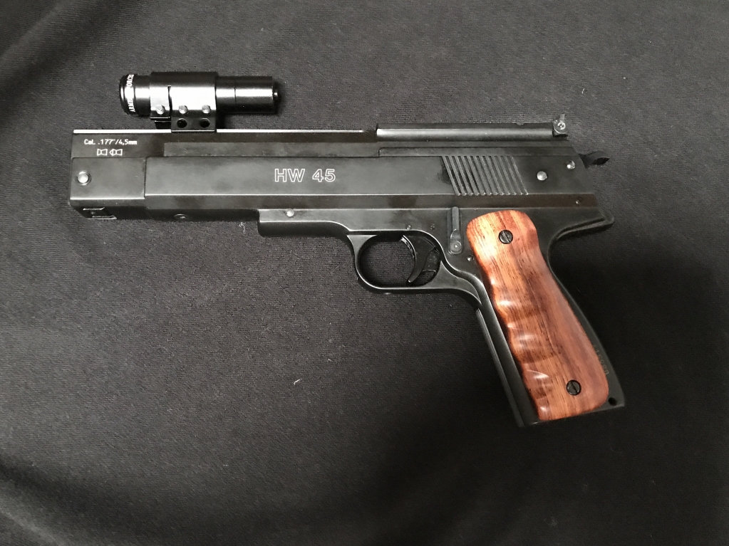

the front of the frame has a 3/8 hole but as you take a rod of that size and insert it, it only goes in say 3/4 inch but it is way deeper the that so the hole is tapered
so after some thought you need some 3/8 tubing thick enough to taper and insert full length and that will be only for the next test
tube in place a cleaning rod has to inserted in the barrel and see were it lines up in the tapered tubed you made, if centered you can proceed to buy a 10mm adapter still needing .5mm of shimming and how after all of this you get no clipping remember it is R&D work
and how will you secure that tapered tube you made, Epoxy or set screw somewhere

I ordered some 10mm carbon fiber tubing the HW75 front hole is 9.40mm and not tapered like the HW 45, so that will be easy to size and I have 10mm 1/2-20 slip on adapter already so in 20 days I will see what is what
the hole is 30mm deep, make a friction fit and see if I will clip an LDC or shoot through
as project go easy R&D
