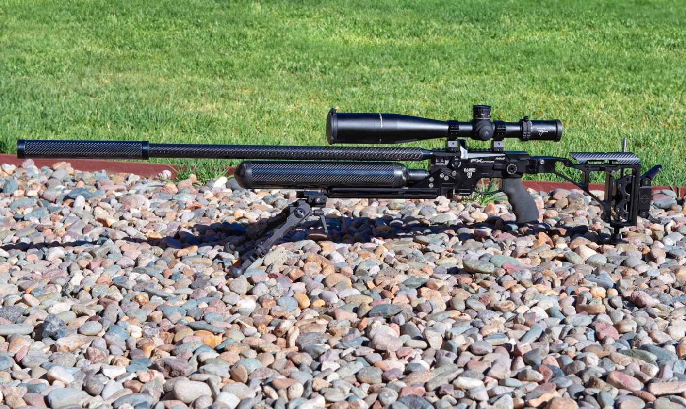

The closet I've seen right out of the box accuracy is Silent Thunder Ordnance Accipiter he's highest researched most expensive moderator, love it
Silent Thunder Ordnance Accipiter with custom CF jacket by me :) surprisingly light
