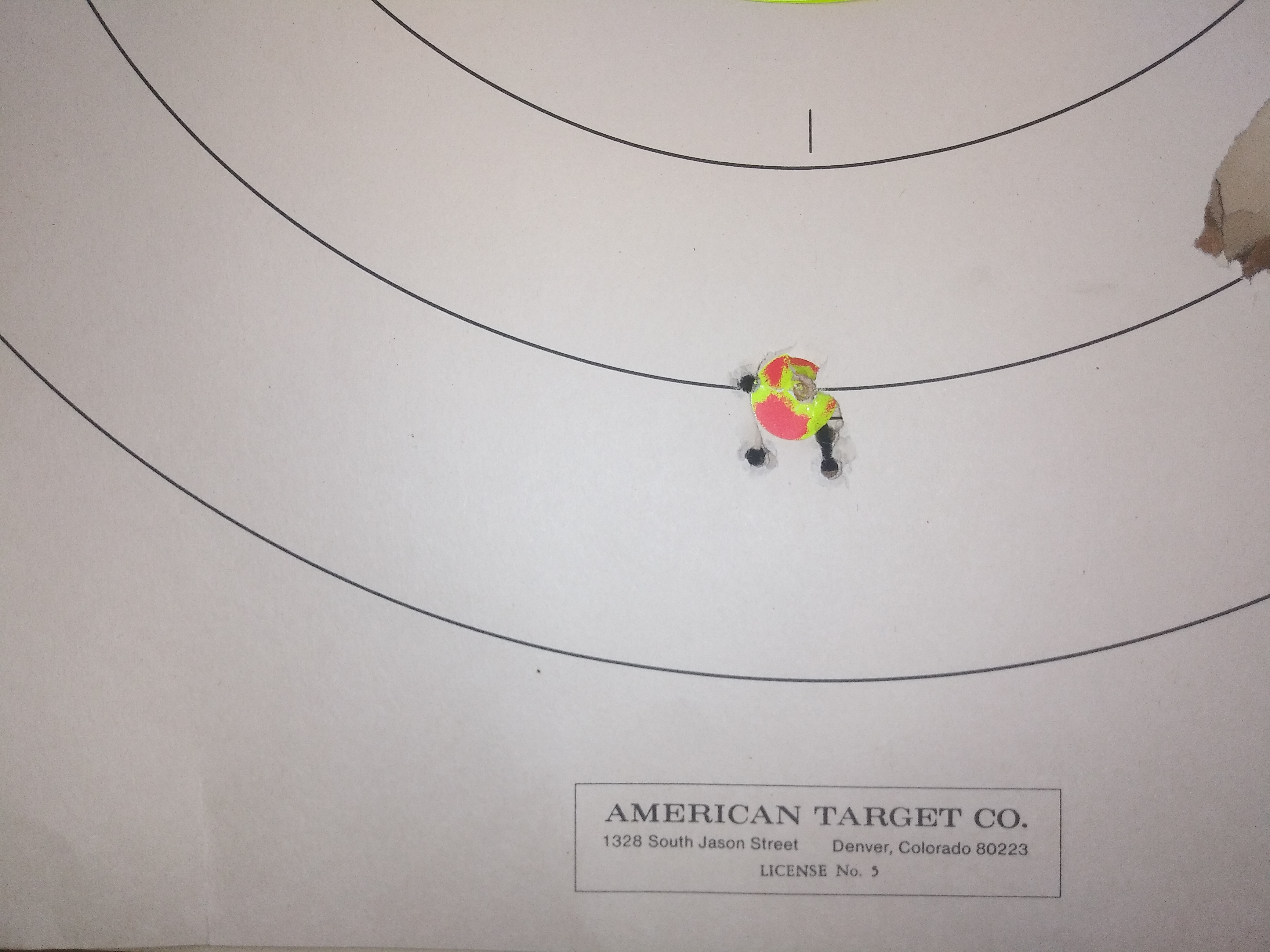

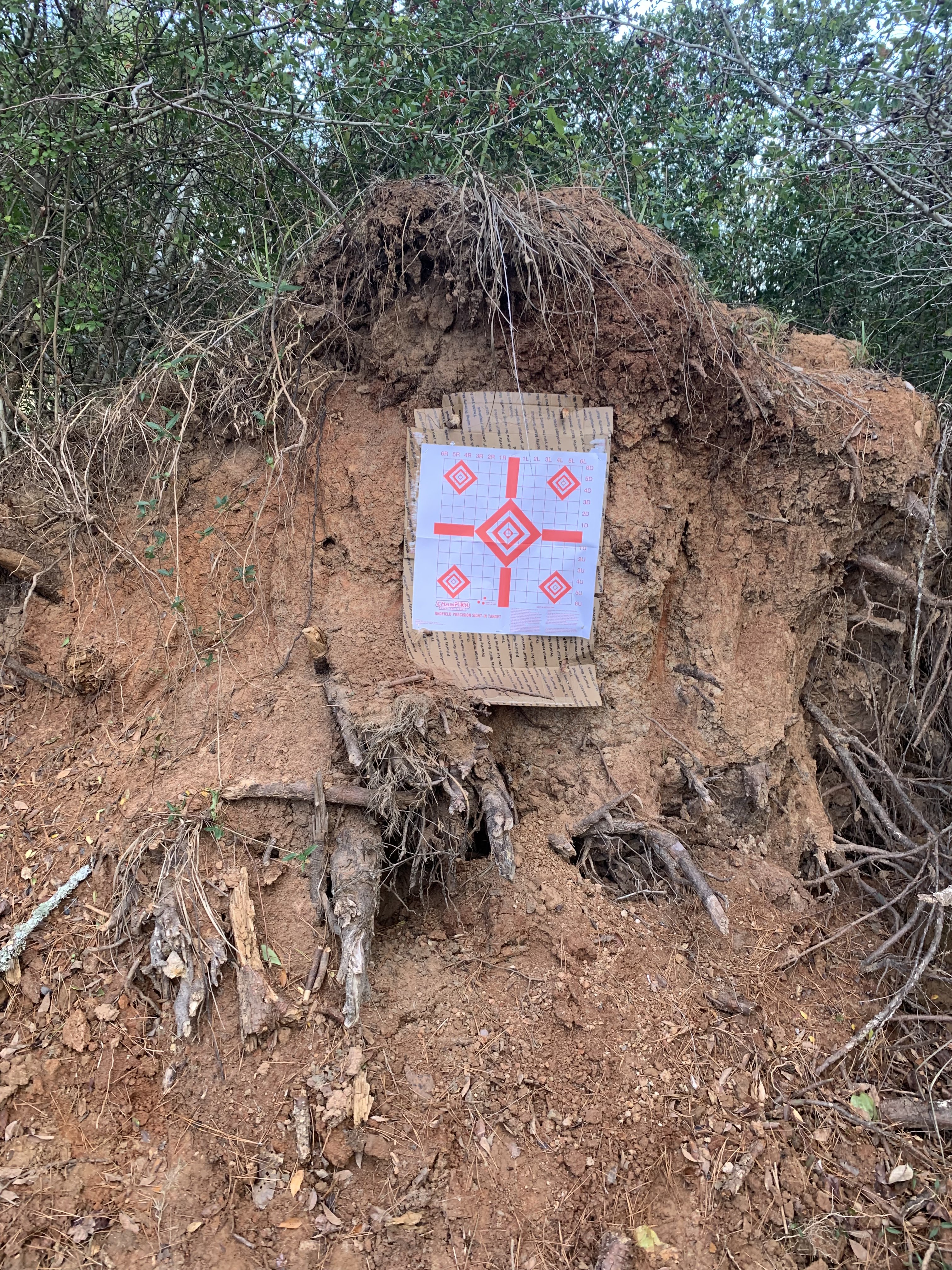

That is some good power there. Were you just showing what you plan to shoot at? There are no impacts on your target.

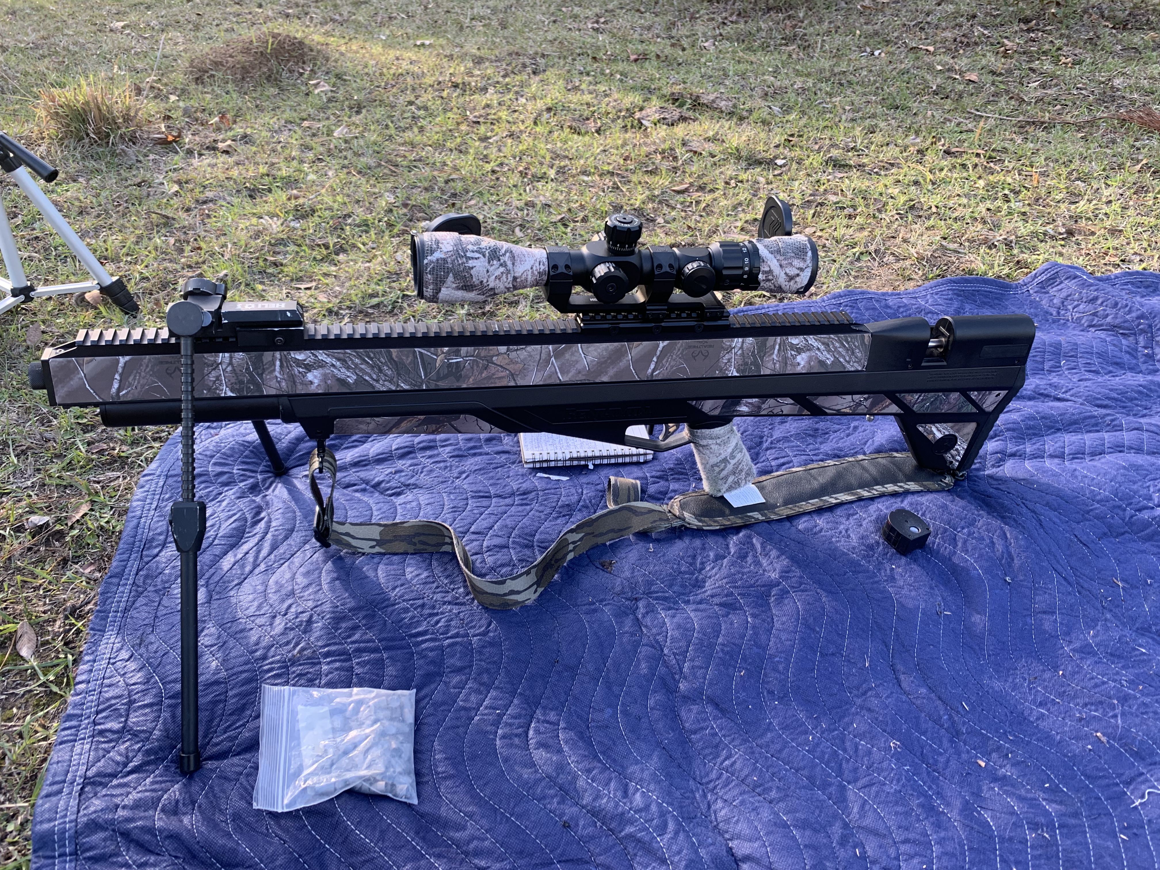

@ram2jeep I tried sighting it in laying prone and using a bipod. I got close with one scope but didn’t like the glass. So I swapped to a Primary Arms 4-14x44 FFP and didn’t quite get it right. I’m in the ballpark, but I need to dial it in. When I saw a buck while sighting in the second scope and couldn’t even pick up my rifle to take a shot if it presented one because it wasn’t prepared.

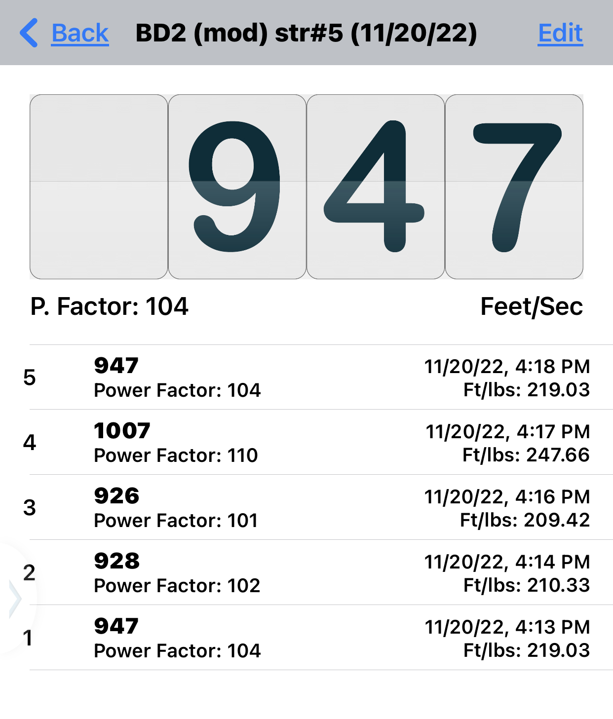

I don’t dial scopes much so if I can’t see how the reticle is moving then I will sure enough move it in the wrong direction before I get it right. I needed a solid base and didn’t bring one, nor did I bring a rear bag. I should have gotten out earlier this morning to have given myself more time to make the proper adjustments. Consequently, the targets look like crap. I also like to have my data for legal purposes if ever questioned by a game warden about the meeting the legal power requirement (fpe) for hunting deer. That was my primary concern. I was uploading photos between shot strings, but my signal was so poor it was taking forever to upload 3 pics, then I saw the buck.

True hunter as well for not even attempting to take a shot because you knew it wasn’t ready. Keep at it and the opportunity will present itself again. That Benjamin is putting out some real power; wish my M3 in .357 could reach those numbers.
@ram2jeep This one was modified by an AGN member. My stock Bulldog produces 150 fpe on its best shot in a string using the same ammo. I was shooting NSA 110 grain dish base hollow point slugs. I was shocked to see that 1007 fps reading. I really need to get out earlier when the sun is straight up because I got a few wonky readings in a couple of strings that had me scratching my head. It was usually the first shot, but I was shooting north to south and the sunlight was in and out of the western treeline, especially when the breeze blew. I think that may have been throwing off the reading. I also had the chronograph resting on a piece of cardboard laid across two thick pieces of a rotten tree branch it wasn’t complete flat and I didn’t bring a tripod capable of mounting it low enough to shoot across prone even with my bipod as high as I could elevate it.
Those numbers look great. The NSA 142 grain slugs will probably shoot pretty accurate out of that Bulldog, and with that power should poke two holes in a broadside deer.

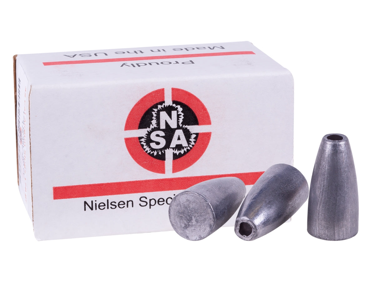

NSA has changed that swaged slug's design twice in the past year or so. It is now a simple hollow point-flat back HP-FB that has a little more bearing surface to ride the rifling on. It can be sized to whatever your barrel likes for accuracy. .356, .357, or .358. I use their .357 ammo in my .357 Slayer with great results.
As far as that Griffin ammo goes, it is heavier so you'll be slower but probably way over the legal energy requirements. Get a fairly large selection of ammo and find one that shoots the most accurate with the smallest group out of your particular barrel. That way you could take a close range head shot and drop the deer in it's tracks. ;-)

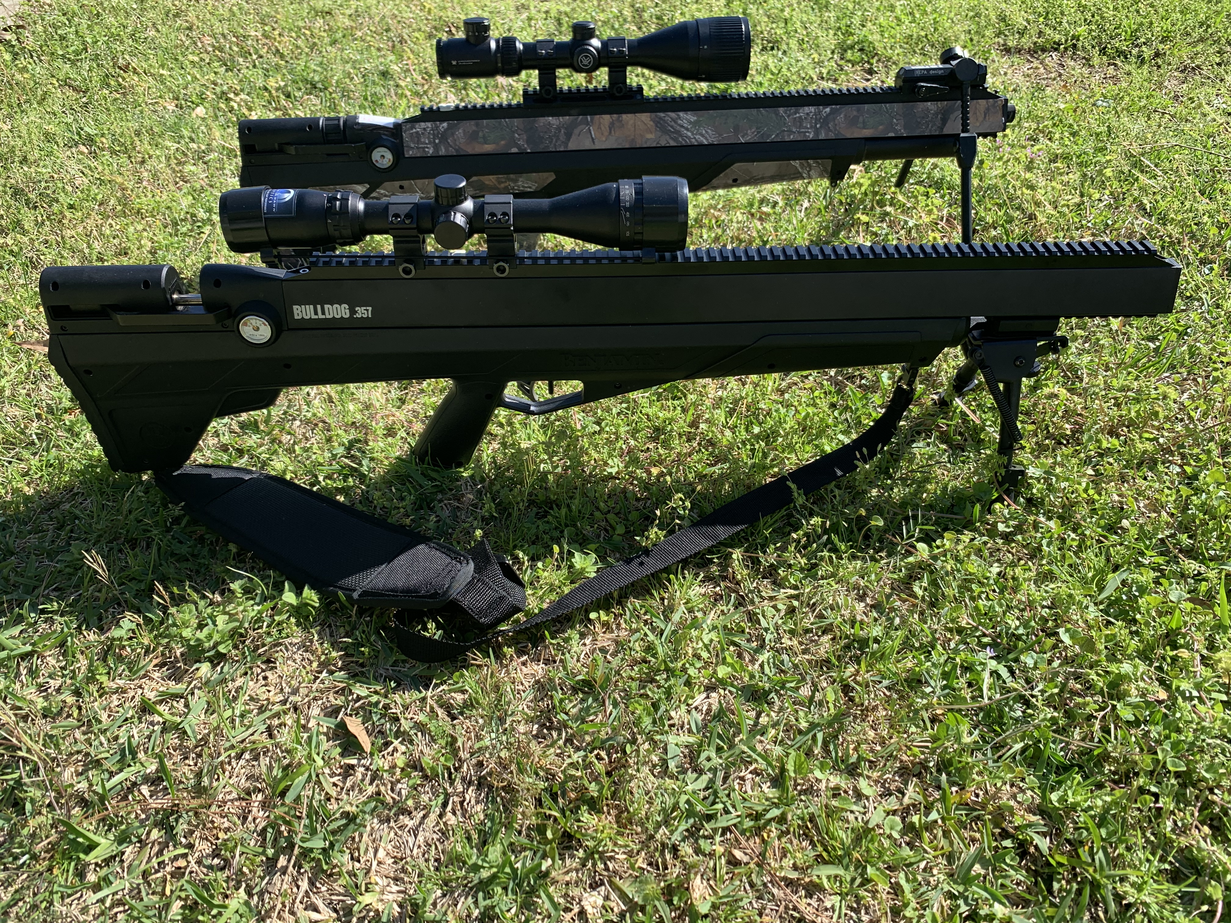

So you have 2 Bulldogs ? one set up for arrows and one for bullets ?
@AirArcher66 The one in this thread is a ramped up slug gun than can shoot pellets too. The one in the air bolts thread is stock and I’ve pretty much learned the platform with it. I’ve shot pellets, slugs, bolts with it. That one shoots pellets very well. Only installed a depinger and barrel supports on it. Older pic here of the pair.
@AirArcher66 The one in this thread is a ramped up slug gun than can shoot pellets too. The one in the air bolts thread is stock and I’ve pretty much learned the platform with it. I’ve shot pellets, slugs, bolts with it. That one shoots pellets very well. Only installed a depinger and barrel supports on it. Older pic here of the pair. View attachment 307450
Cool, I'm a big proponent of having several guns of the same platform,....familiarity is important to me.
Agree with your conclusions, the stock Bullpups shoot pellets really well and are a 150 FPE gun essentially,.....Your tuned Dog at over 200 FPE with the 110gr is certainly a deer killer
