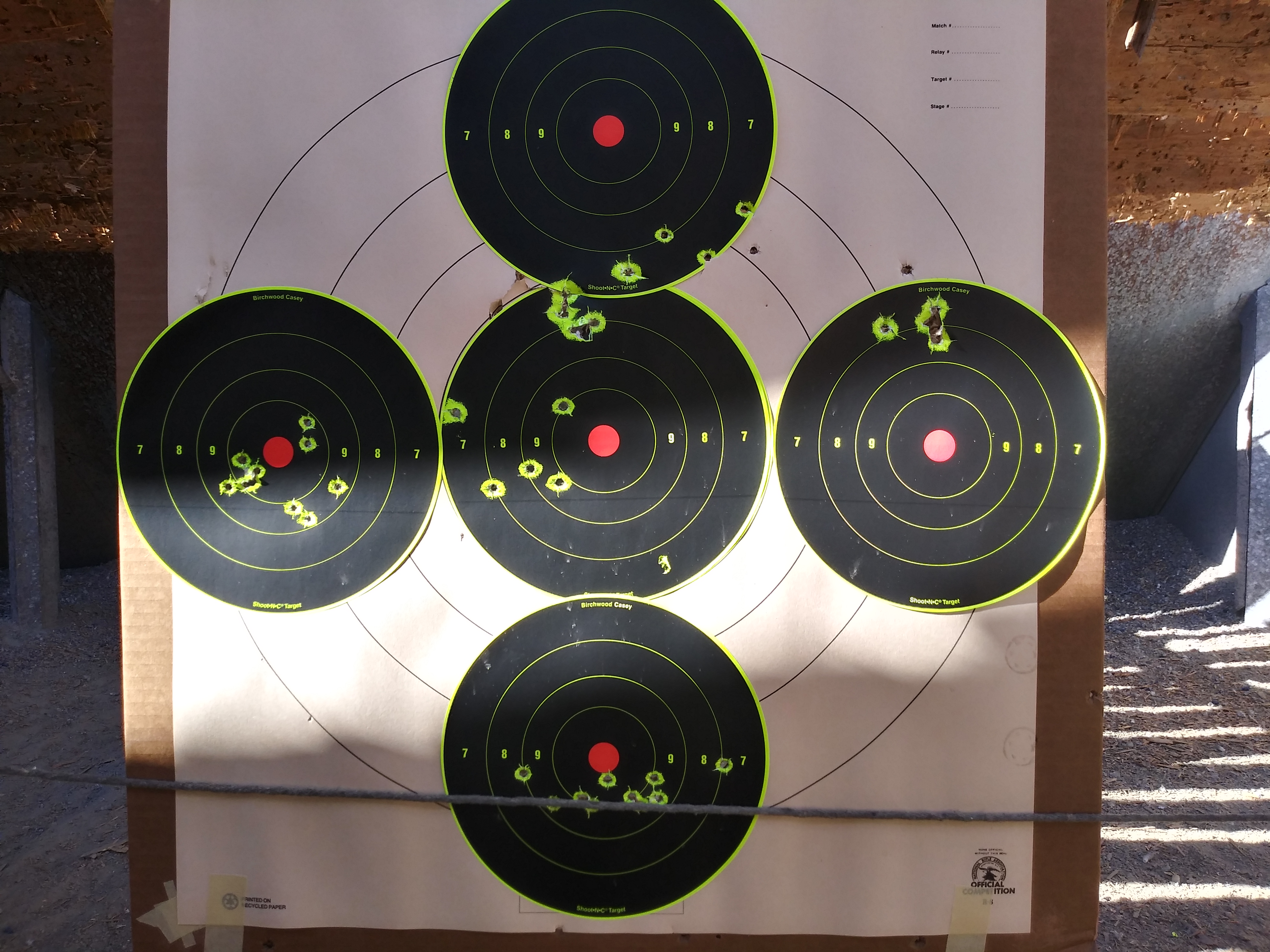

Thanks, To be Fair I cherry picked that group! And I was shooting on an non-level bench with ear pro, glasses and a shaky chair at the range... If I was shooting prone in grass with NO glasses, or ear pro, with people bothering me... I know she can do better. Here is a pic with JSB,NSA,and the new 147grain Benjamin slug. Mine shoots the NSA @ 875, the JSB @ 965 and 147g @ 785
(NSA 110g Left and Bottom target, 147g benji slugs center, right and top target are JSB 81.02 pellets) 50 yards
